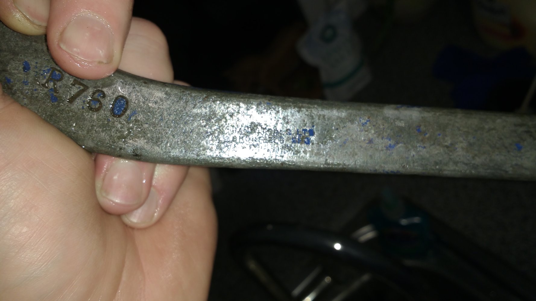

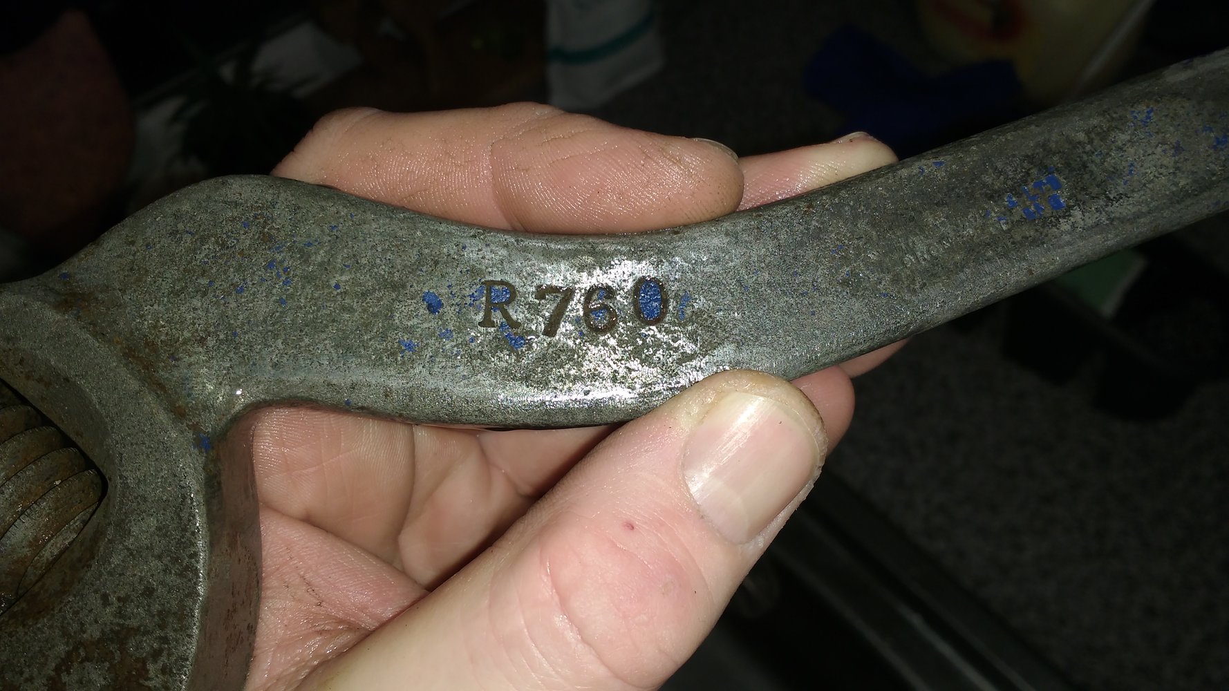

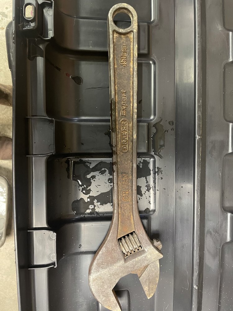

Thanks, ive just wiped the black film off of it as it came out. Wasnt sure if it needed any special clean before giving it a coat of protectionWax, oil, linseed oil, etc. Anything which takes your fancy to coat the surface.
I wouldn't bother cleaning it up any more than you already have done.
Wax, oil or both.Thanks, ive just wiped the black film off of it as it came out. Wasnt sure if it needed any special clean before giving it a coat of protection

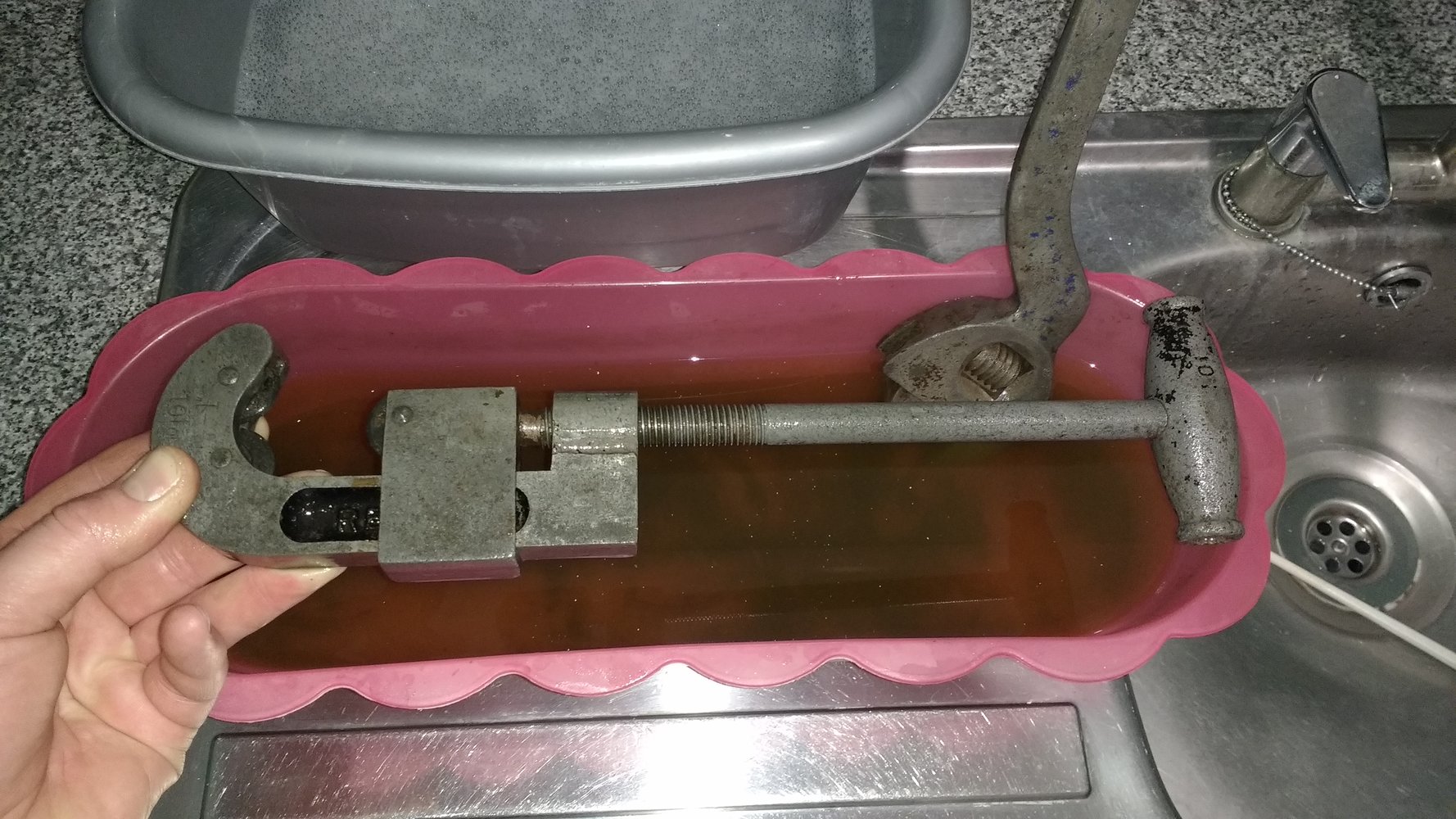

In citric? I assumed it would have little effect on alu. How long did you leave the bike chain in there?

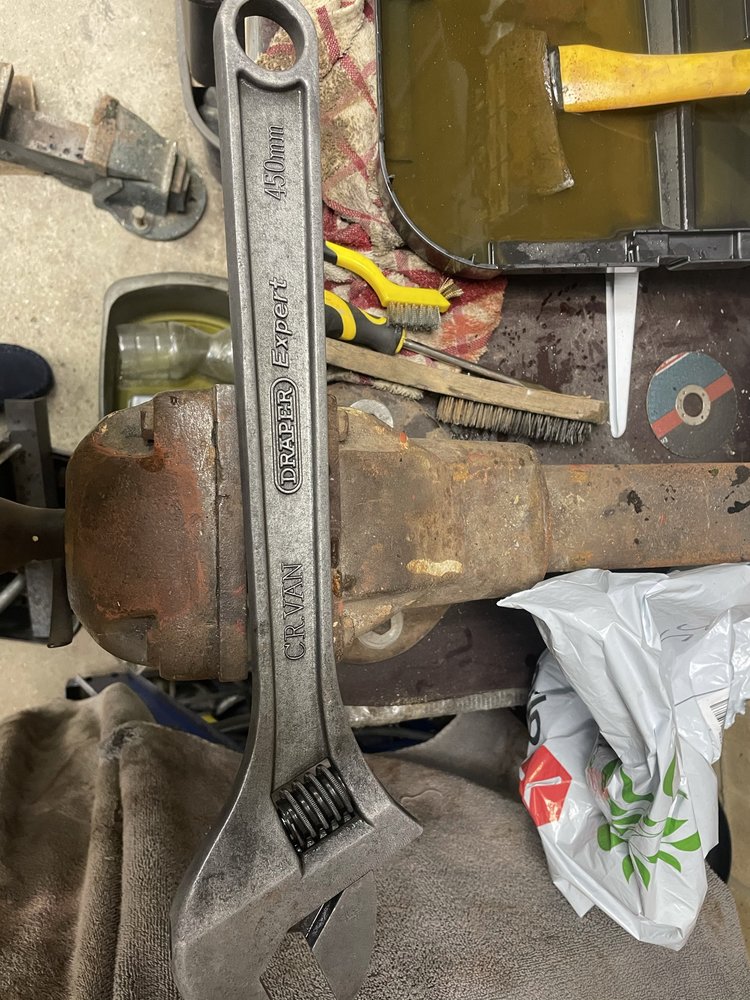

Looks like an aco drain, good ideaMy first attempt with citric acid and I'm fairly pleased with how it come up. Whats the best way to clean up and finish?

A good guess is that one or the other formed a dis-similar metal circuit. Allowing a current to form and the metal went away.I accidentally chucked some aluminium in, whoever said dont do it was correct
Fairly pungent metallic smell and the bike chain that was in there has also disintegrated, has the aluminum caused that?
Acid neutralised and disposed off
