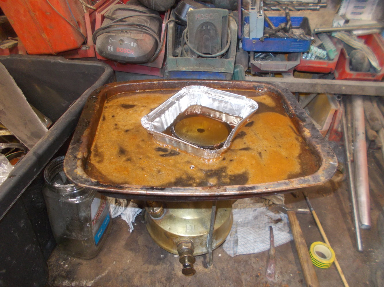

Heat makes a big difference, I use a cup boiler to keep a bucket full warm.
Over kill.
But it will work.

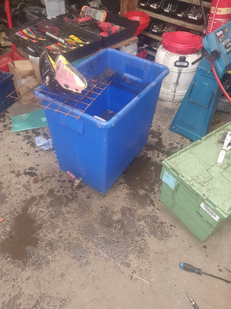

Oooooh. A dedicated container.I got one of these tubs on wheels for citric acid derusting

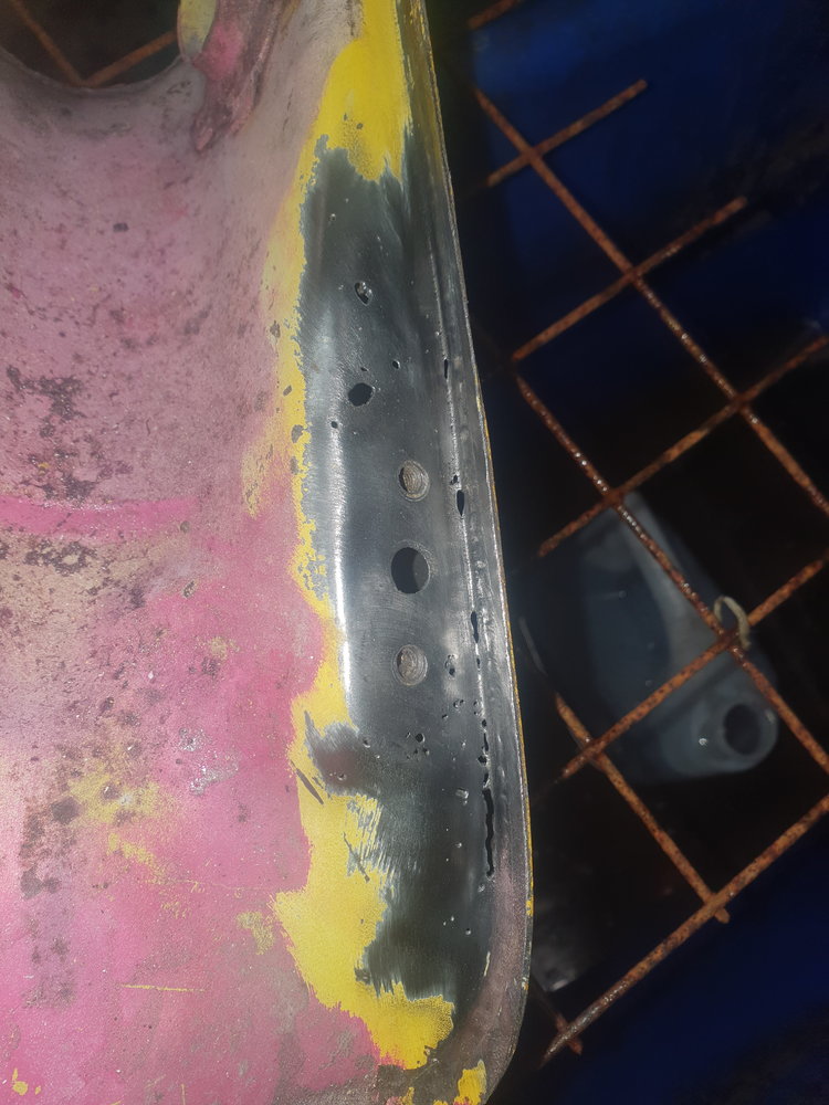

Here's a petrol tank I've just taken out.
Only 3 of them holes are meant to be there
Wheelie bin, brilliant idea, why didn't I think of that?Oooooh. A dedicated container.
I am tight. I use anything to hand.
Take away containers, coffee jars, buckets, fish tanks, wheelie bins even a paddling pool.
'Cus I did.Wheelie bin, brilliant idea, why didn't I think of that?
I got 2 of those for free from the local chipper. A friend of mine has 3/4s of an Ibc tank that he uses for big partsOooooh. A dedicated container.
