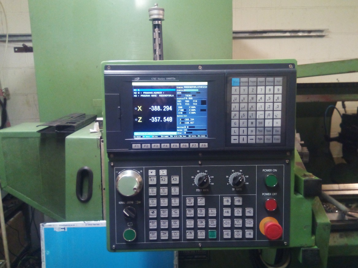

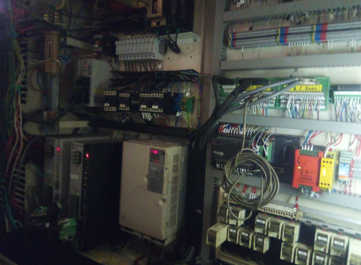

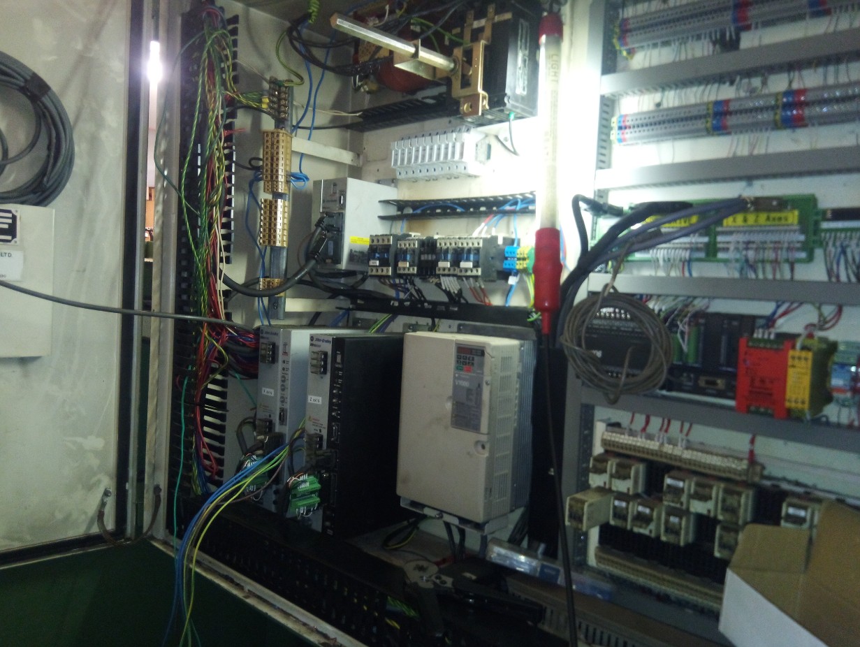

Fair bit of progress with the wiring. I did waste about 2 hours trying to separate the limit switches into positive and negative but eventually after tracing things on the lathe, the connection boxes were in the most awkward of places, it turns out that they are not linked together where the original wiring diagrams say. It would mean having to run some new wires and as the conduits are pretty full up I have decided to see how the SZGH control will behave with them all being linked. I think it will be fine as it seems to be fairly smart and knows which way it is moving and will act on a switch but whether it will allow me to back off if the negative is also active when it has tripped going positive, time will tell.

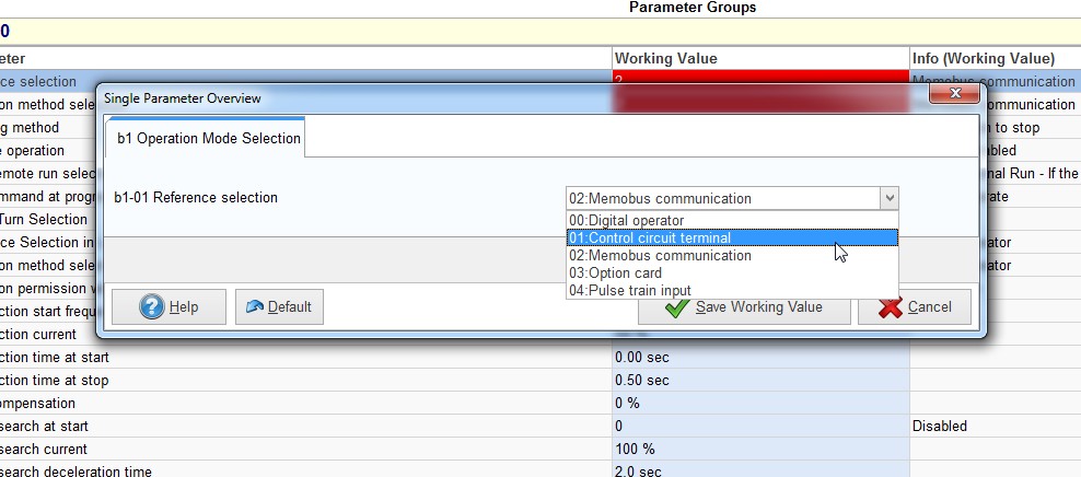

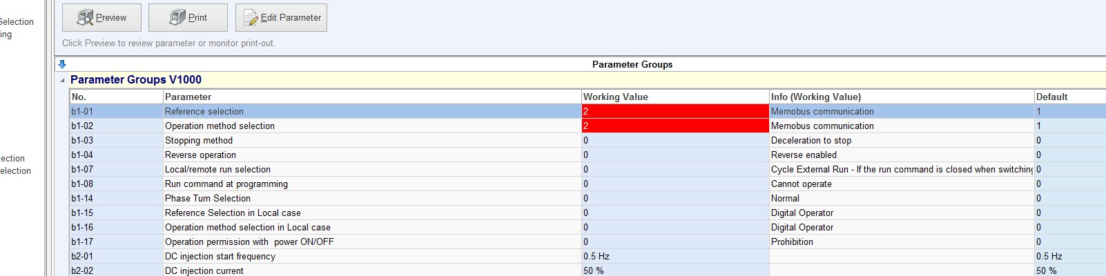

The fuse holders just turned up about 4:30, I have them fitted and hopefully I will get the last of the wiring done tomorrow and then it will be on to setting the drives I/O correctly and then controls parameters. Hopefully there will be no smoke when I connect up the mains again

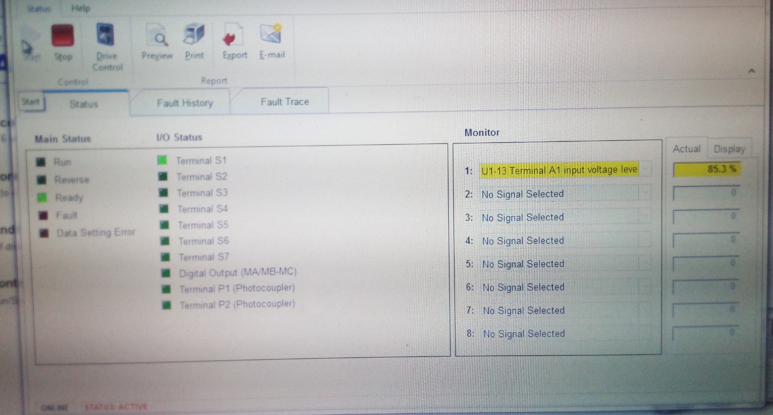

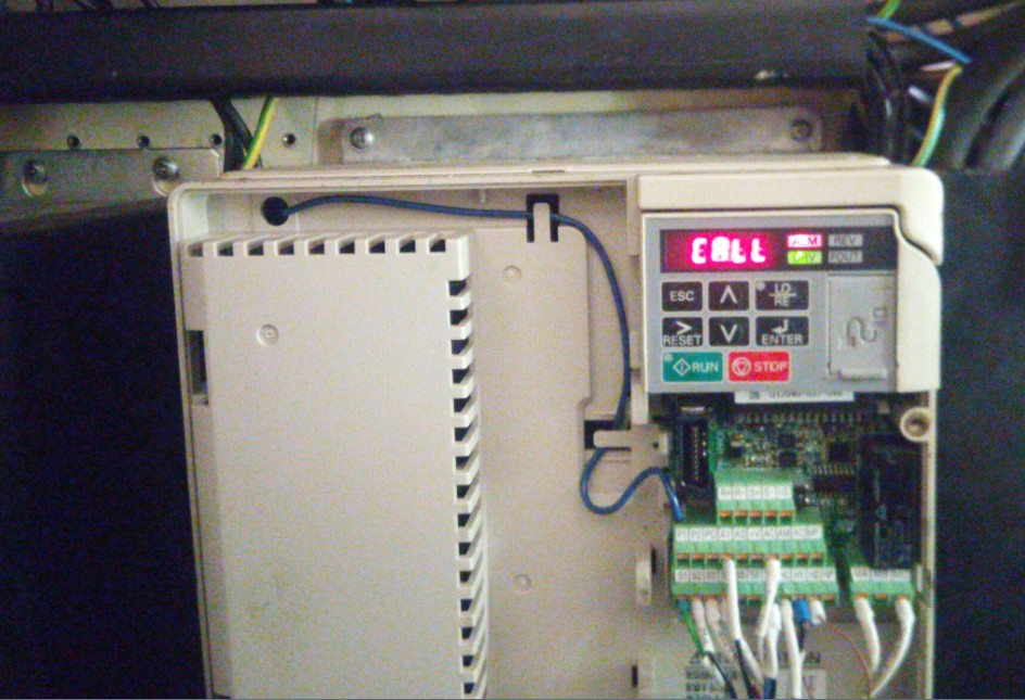

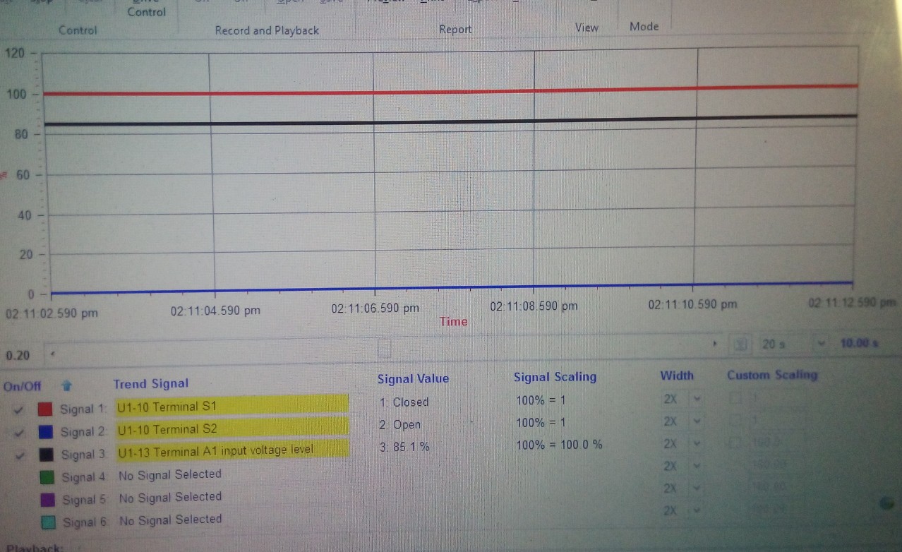

I will have to get the meter onto the wiring and see if I can find the issue, hopefully just a wrong connection or parameter.
