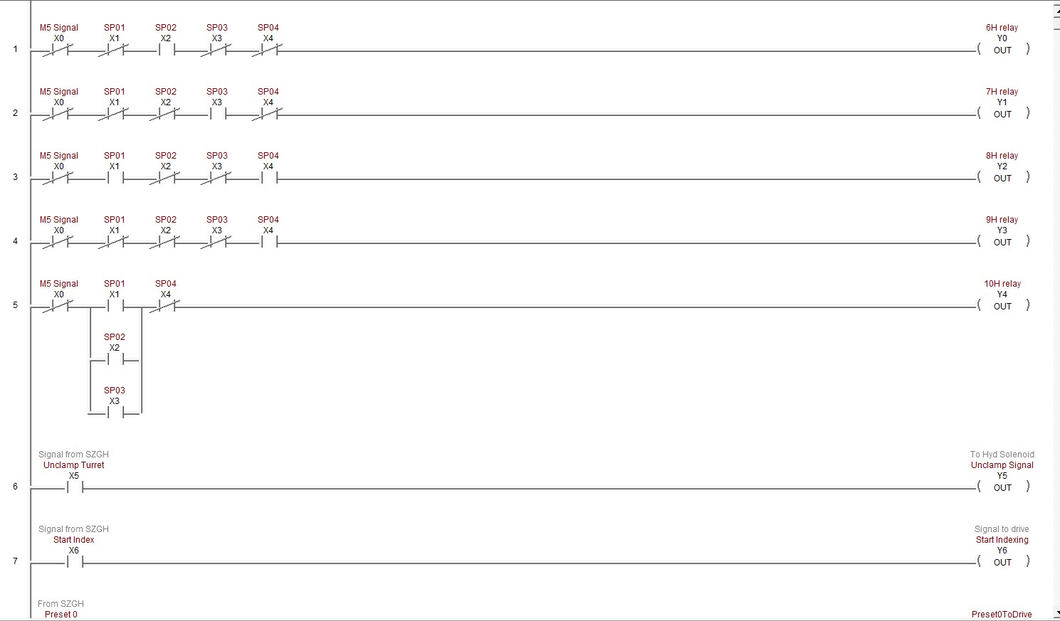

This control has M41-M44 to choose the gear and you also have to call the M3.
Not tested to see what will happen if I call a speed higher than the allowable speed in the gear range. Whether the control will throw a warning then stop or just limit the speed I don't know. I will have a go when I get home and see.

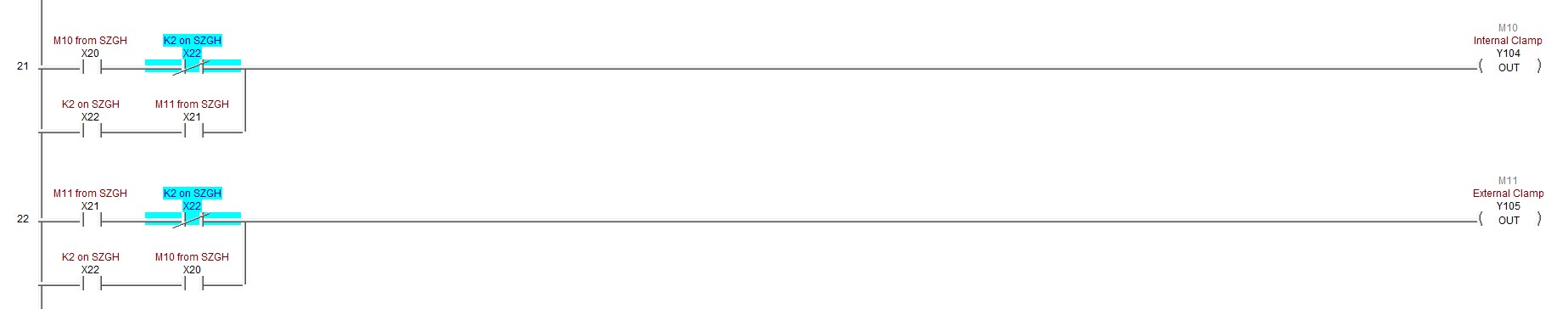

I kind of did that when I was doing the ladder for the Chirons Toolchange as I was working half blind and trying to work out how all the valves worked, I used two flat screens one above the other so I could see the full section of each toolchange in the ladder, helped quite a bit, it helped me find out why some of the tools weren't working correctly, someone previously had linked together tool arm wiring, not sure why.
