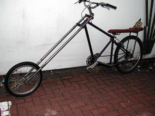

First up Dr Hannibal, my first attempt at a chop.
(note the 40 shot airbomb repeater on the back).
I was a bit wary of my metal joining skills so I used two frames, the front of one and the back of another, so no brazing on the headtube or rear triangle.
The bike rides like a dream, no swerveyness, no forks flopping into corners, can almost ride him no handed. A complete fluke I confess. But a high front end and long forks gives that long look and avoids to much rake or is it trail? or whatever. The Great Rat was smiling when I built Dr H'.
I used to take my boy to school on it, in traffic, yes it handles safely. Nobody has ever fell off it, no matter how drunk or stupid.
We met Lonebiker of project Bikehotrod, The Enemy (and a good mate). His bikes were to put it bluntly *****. Handled like pigs but did look cool. Sadly no surviving photos.
Anyway, he had contacts within the Kona mothership, and persuaded them to build a chopper. They wanted a highfront ended long design, but some management flunkey insisted on both wheels being the same size. Cue ill handling barge. They even managed to sell some of these contraptions. We did chop one in half and stretch it some more, it handles ok'ish but again no photo's.

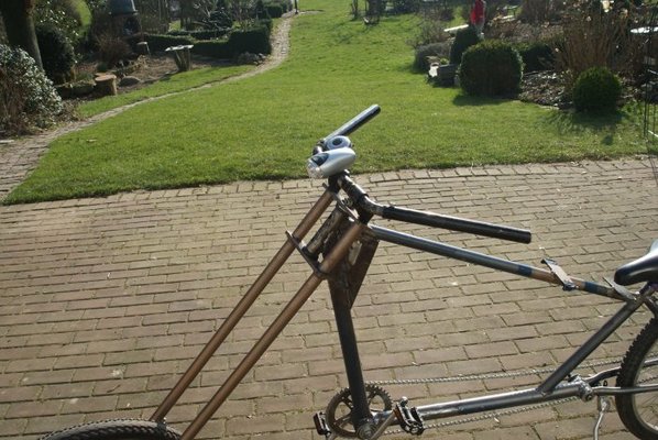

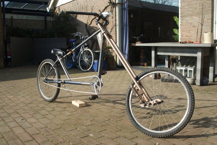

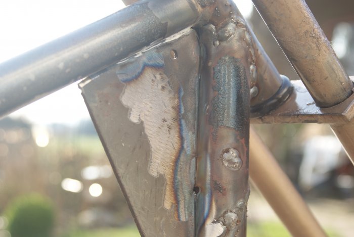

so i notched the neck and completed the welding on the frame.
at first i put a smaller front wheel on the bike and it handeld much better than before.....no more wheel flop. (did'nt make any pics of the bike with a small front wheel.
but then i thought i'd change the seat and go with the original idea. so i took the extra long seat off and went back to a normal seat. you'll see a seat from the kids bike on now but thats just till i bring the official seat from belgium.

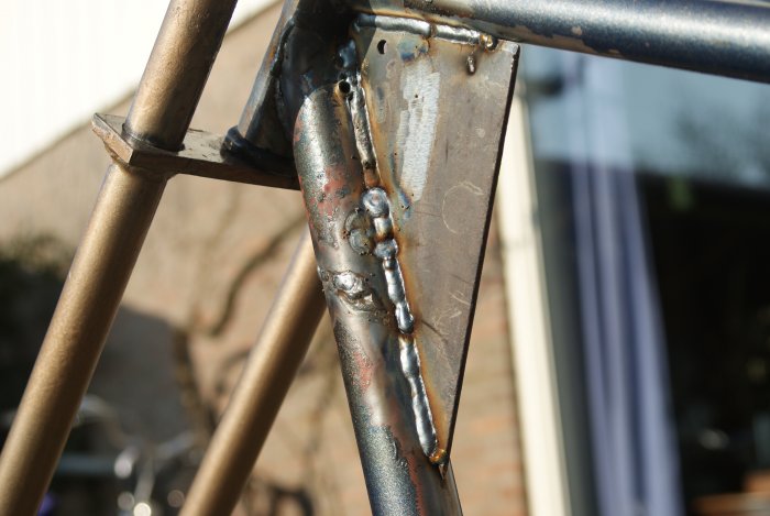

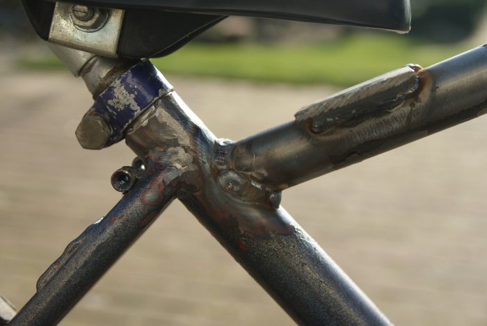

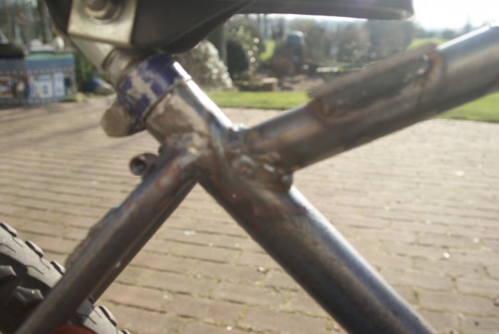

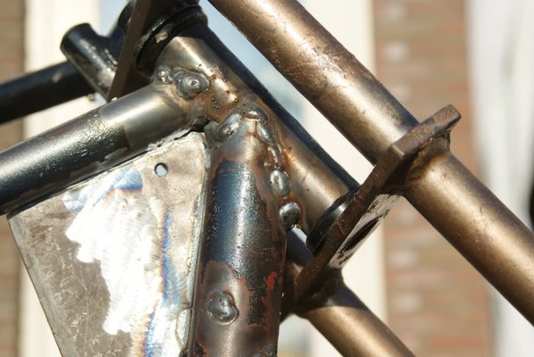

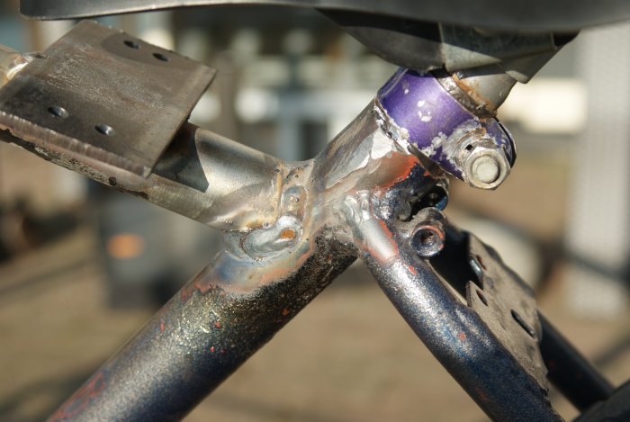

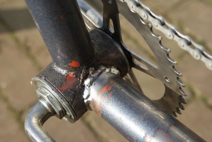

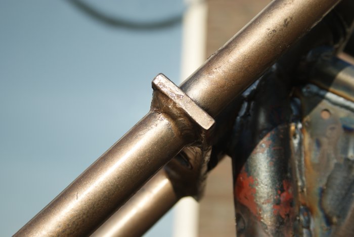

realized that this is a welding site.....so i make alot of pics of the welds....

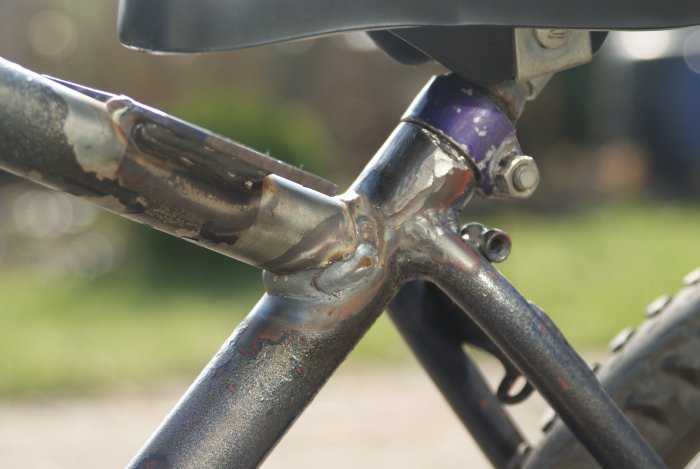

i had read somewhere that on bicycles you dont need wide, fat welds. that the weld only needs to be as wide as the thinnest material. for that reason, i used stringer beads on the joints......the welds are high and narrow......
i used a weave motion where the seat post meets the backbone,,,those welds came out wide and low....
im not planning to paint the bike until i've ridden it afew times to be sure all the structural bugs are worked out ( had to gring off a good bit of the first paint job....
now.....without furthur adu.......tadaah
notice the "full" handel bar....held together with two small bolts

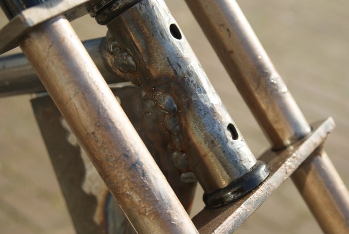

forgot to mention....i turned the steer tube around.
i was too much in a hurry when cutting it off and as a result, i grinded a little into the neck....not much but you could definetly see it was grinded. so i turned the tube around....hence the two holes. those two holes are normally inside the backbone and upright tubes

even with those "amature welds"......they are'nt TIG pretty.....but this is my first build....so i like the idea of being able to see all the "not so pretty bits"

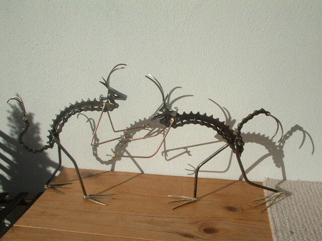

I was playing shed dragging around Exmoor ...Minehead / Porlock & Illfracombe last week and chanced to glimpse some amazing ferric art work including a 3 mtr high red rust sea horse .. it that where yours is ? .. I can't remember the place ..... I've been to sleep since then .
