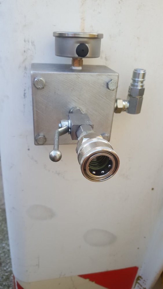

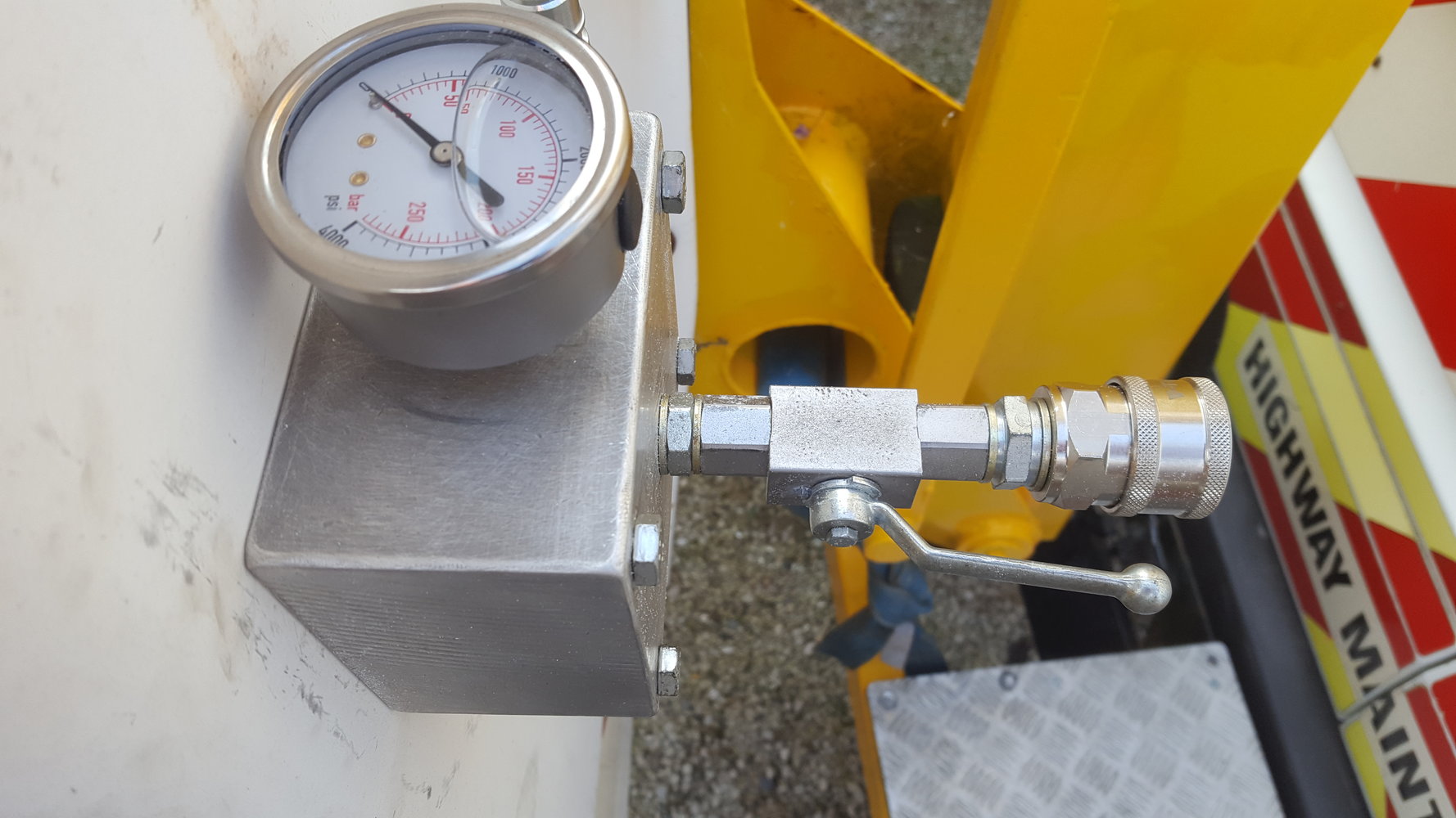

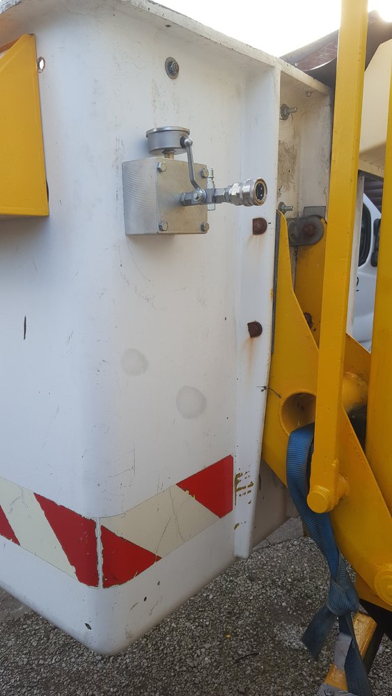

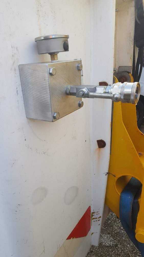

Knocked this manifold up today for our roof cleaning side of operations..Its a right pain to take the lance and hose up almost 45FT and clamp it to the basket while roof cleaning, now i have made this with a ball valve also to reduce flow when needed and fitted a gauge too. Connect ground hose to block and lift, i just need 2 meters of hose now to my lance in the basket, far more managable. ![smile :) :)](/forum/styles/smilies/smile.gif)
