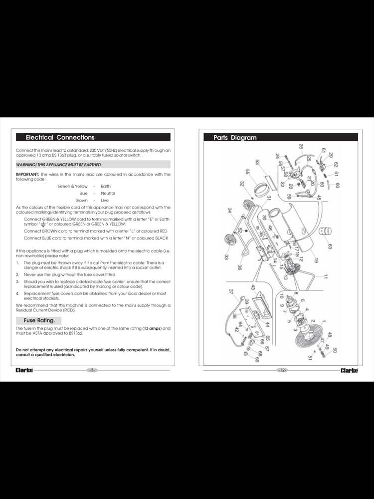

Stripping repairing & reassembling the air pump can be an annoying fiddly exercise. , mark everything & photo it as you strip things down, take notice of the radial orientation of things so you get the impellor cavity ring facing the same direction & all bolt holes to align perfectly ...One I have (same type burner but direct heater) recommended either kerosene or diesel but only to leave it off-line with one or the other - but cannot remember which.
One heater I have needed a new air pump rotor. Got the part but not yet sorted it. I may get round tuit one day….
