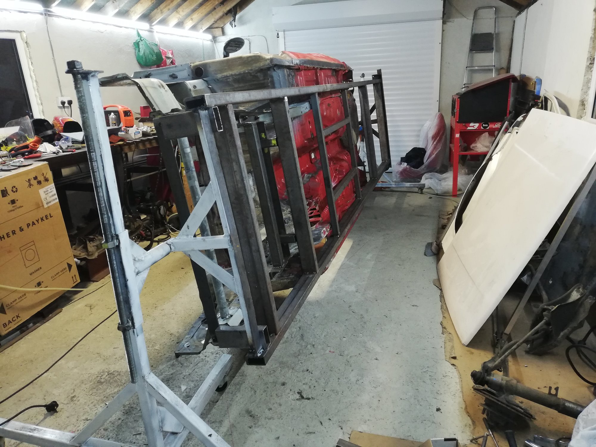

    It would be perfect for what you need. But getting them is usually the issue.
    A old blackhawk is where I got my bread and butter for nearly 12years doing crash repair.
    With an actual jig they usually have pickup pins also which means you can align everything as you go. Rather than just using tape measures and or plumb Bob's.

    That looks like quite a heavy grade I-beam... It's be staying on the floor :D... design looks fairly straightforward ....

    On hold due to recent spending (see 'ae86 booter' post).... bank holiday here tomorrow so I'll be pricing H-beam (if available) and rectangular box during the week.
    As I see it: H-beam or rsj would be less liable to twist but box would be easier to weld and cheaper. I'm also more likely to re-use the materials afterwards if it's box,whereas rsj is going to pose a problem of storage.
    Also I don't intend getting into collision repair I just need to keep everything in line for welding, I'm still leaning towards box.

    If you use I beams you could weld plates and then bolt the corners for dismantling.
    Possible sell it after your done as someone else may be is a similar position to you are.

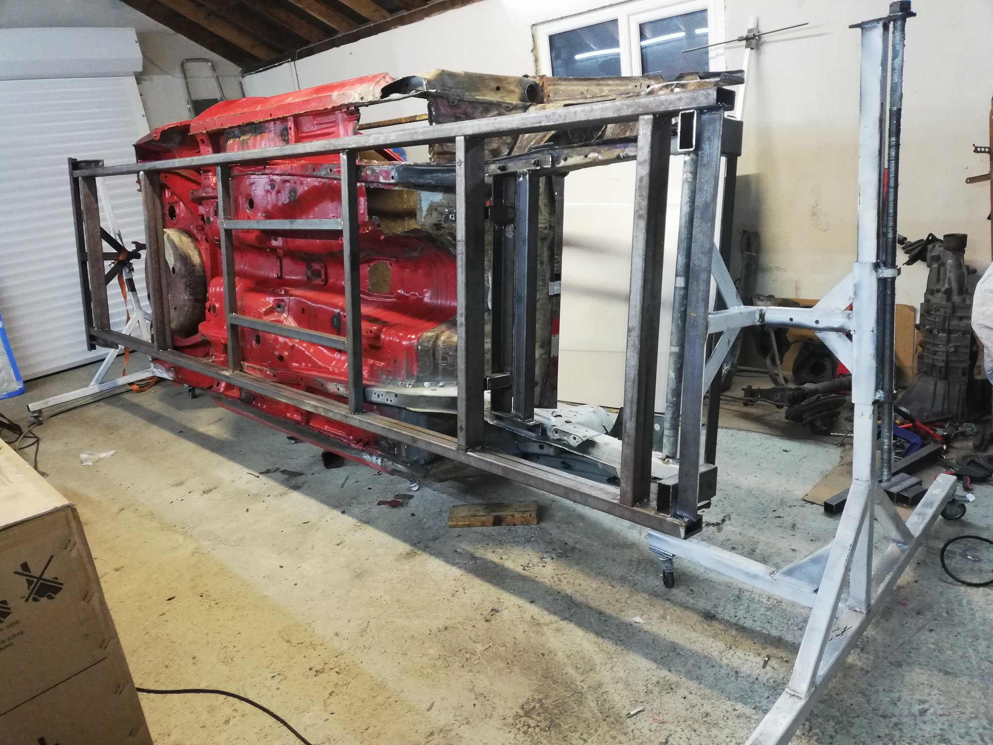

    So here's what I've ended up with:
    ....may prove interesting when it comes time to remove it :doh::D.... anyway, I'll cross that bridge when I get to it

    I once built a Lotus 7 Chassis on a surface table, might be worth buying and selling on when finished?

    Stunning work.
    Looking forward to the next progress.
