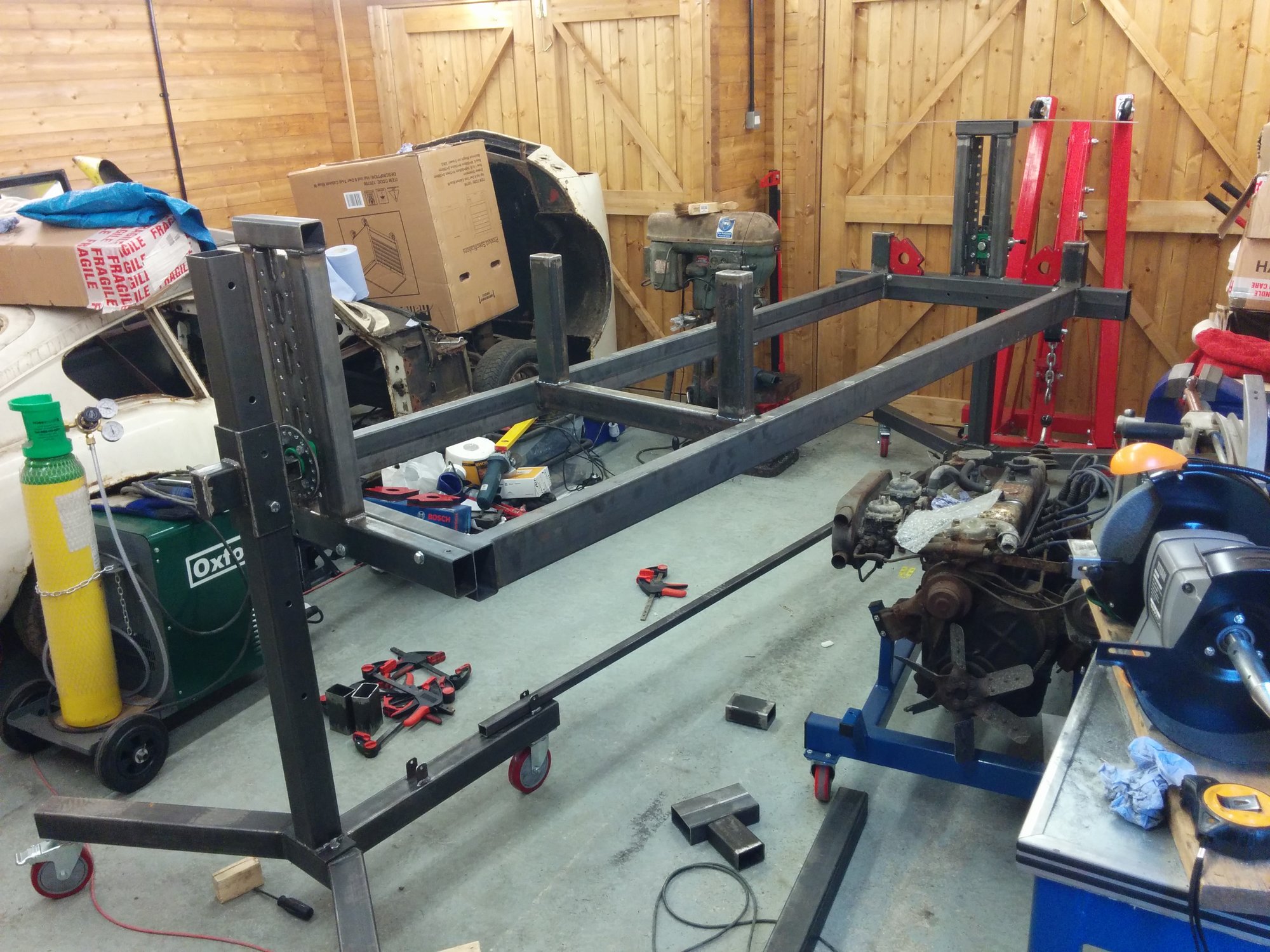

    Similar build to this style was how we did ours.
    But then again you could just use 2 I beams to pick up the floor pans.

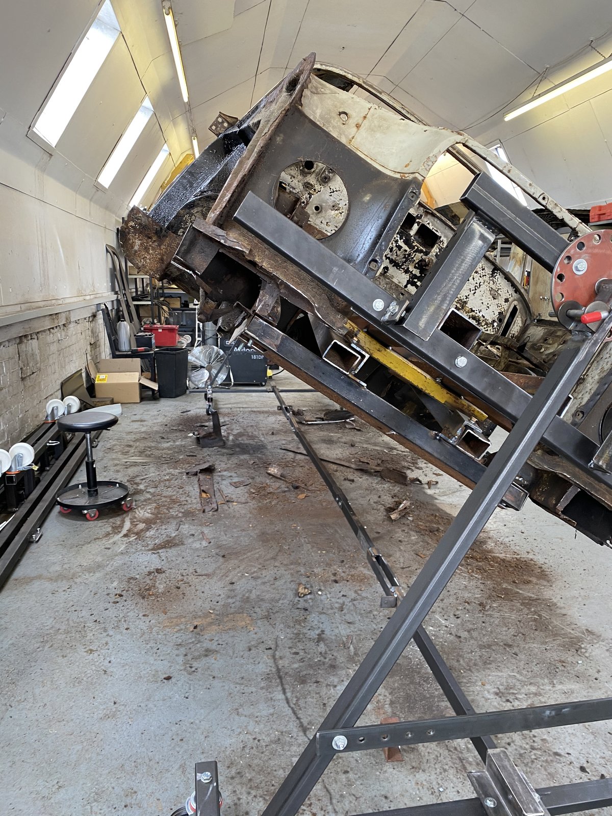

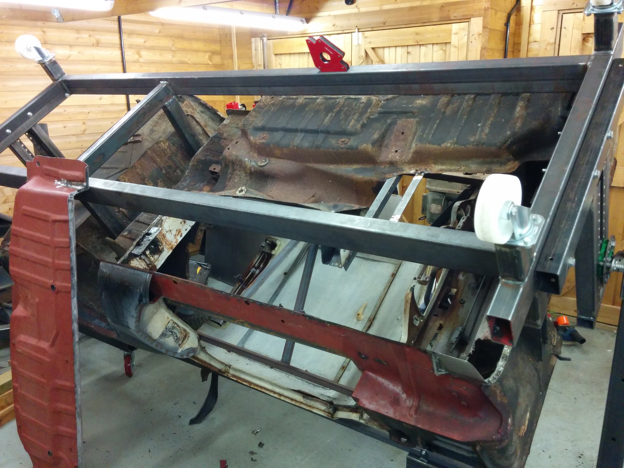

    Really depends what the purpose of the jig is and how many mounting points you intend to have. I used 100 X 50 X 3mm for the body jig part of my GT6 rotisserie, but I still cross brace the body tub since there are only 4 mounting points.... IMG_20180426_173953.jpg

  11. daedalusminos Member
    Messages:
    1,071
    Location:
    Norwich
    The GT6 has a separate chassis so the jig picks up on 4 of the original 8 mounting points. For a true monocoque the subframe or suspension mounting points would be good.... But you need to ensure they're structurally sound. Also make sure you have enough room to perform repairs and that the jig isn't going to get in the way.

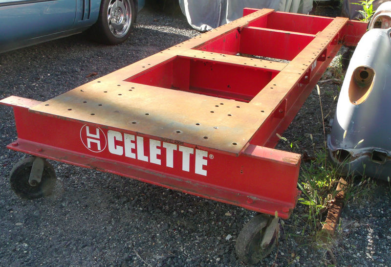

  13. stuvy
    stuvy Member
    Here’s a 5mtr long car on the rotisserie I can’t find a picture of the old jig but google ‘Celeste’ there’s nothing better

  17. 8ob

  18. stuvy
    stuvy Member
    that breaks my heart to read that
    we had one where I worked years ago and it was brilliant but sooooooo big it was actually a pain to move plus all the extra parts for it taking up room
