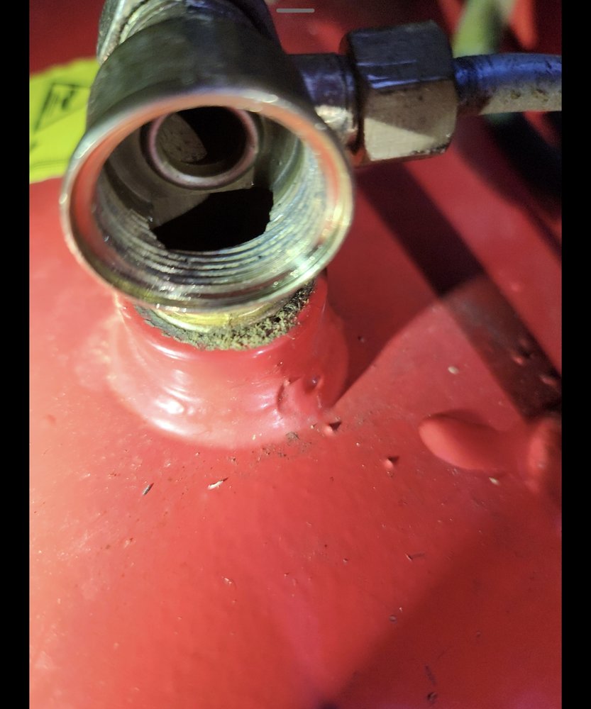

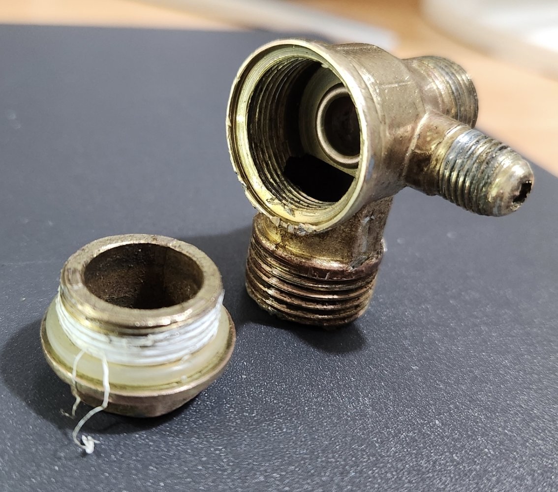

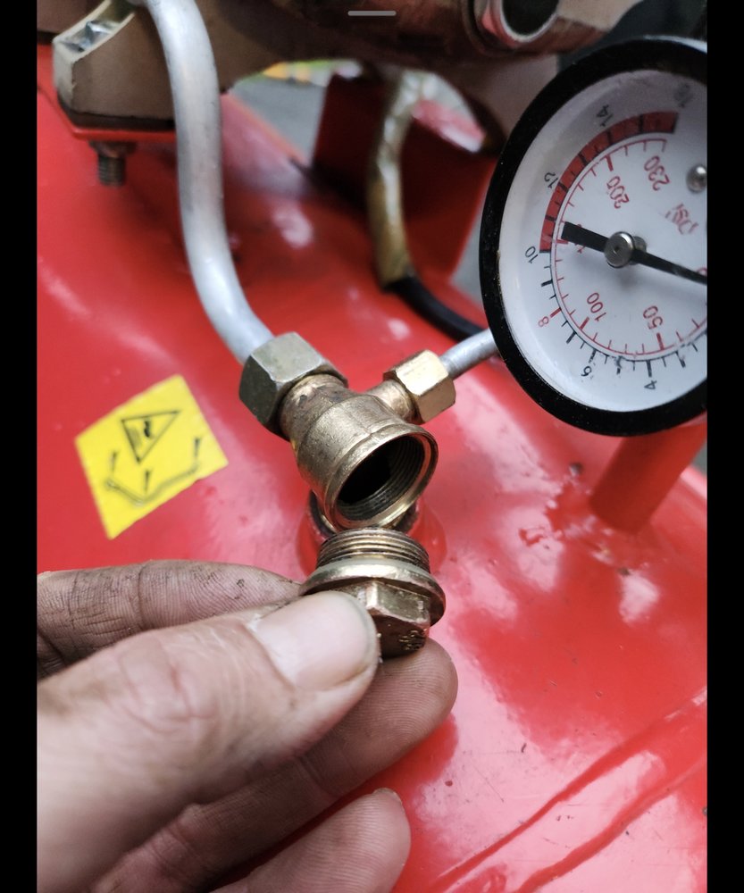

That is a very valid point sirWhich hole? If you mean the dark one at the bottom then yes. How else is the air going to get to the receiver
Thanks mate, I think the best thing is to go to a pneumatic local, I can take it with me then. Is there any special thread paste/lock I should use, cautious dealing with compressed air etc.You’ll need to check your thread sizes, have a look at this one
Air Compressor Valve Non Return Check Valve Spare Parts Tube Connector Tool UK | eBay UK
