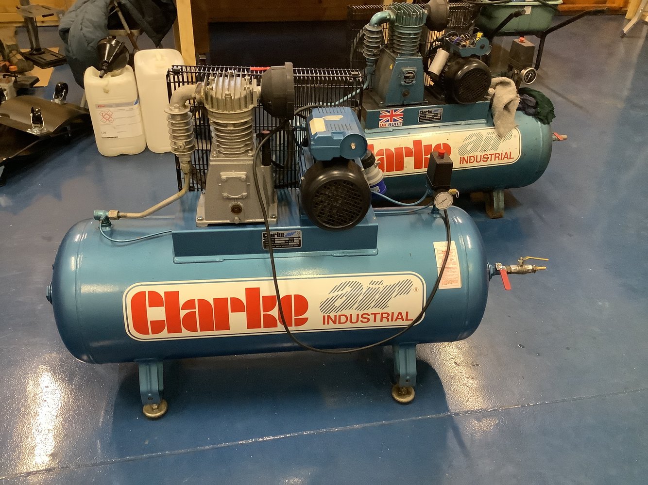

I paid £300 for both of these, one needed a new motor so £440 in total, all parts easy to source.
They’re both 150 litres so 300 in total, I’d been looking for months Mark, then within 1 weekend both turned up on Gumtree at the same time and both local, separate sellers but identical compressors, what’s the chances, you have to be prepared to act quickly though if a good deal turns up, as the old saying goes if you’re not fast you’re last.Wow, great deal, 100l too? I'm not in a massive hurry, weather wise it's not good for outside spraying (car touch ups) yet anyway.
