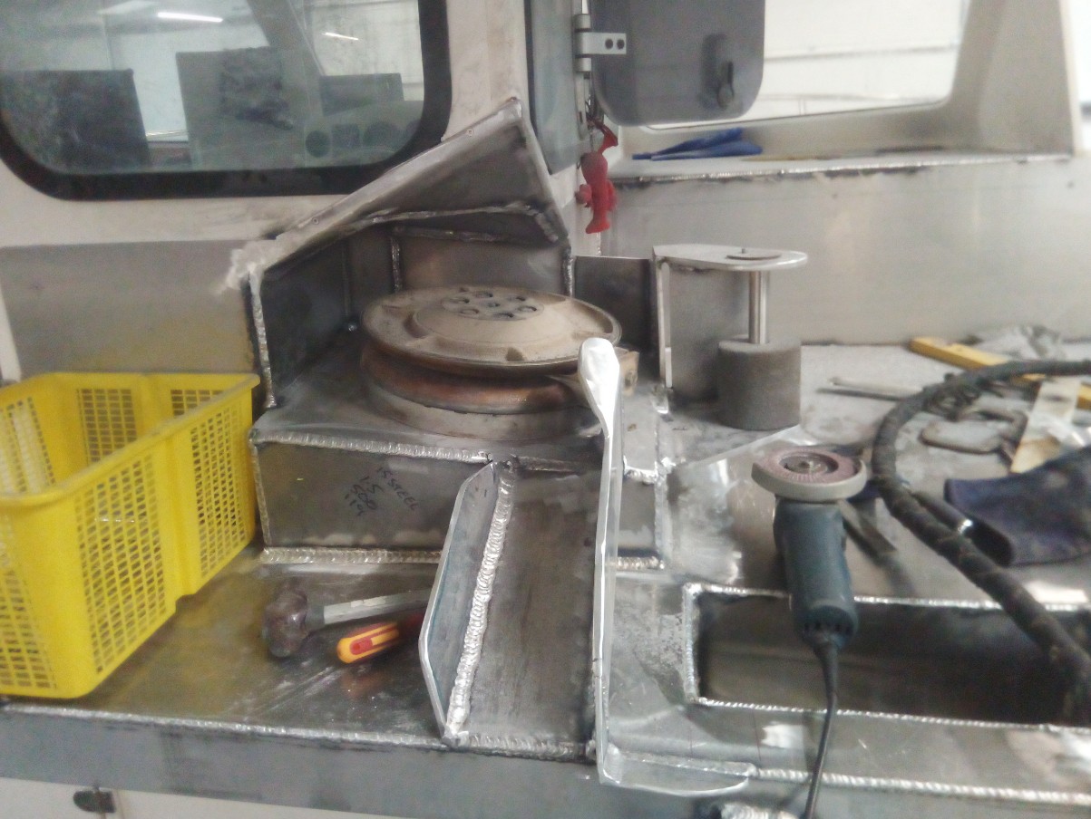

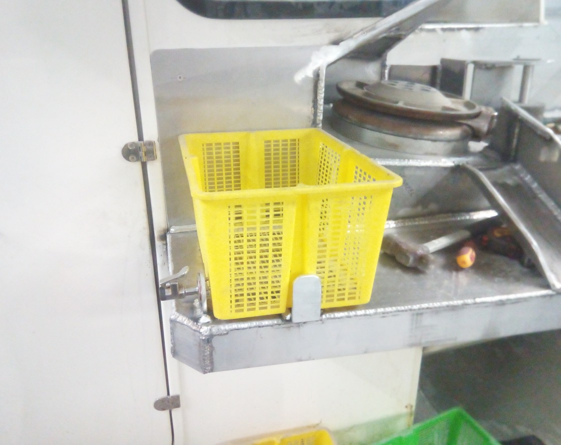

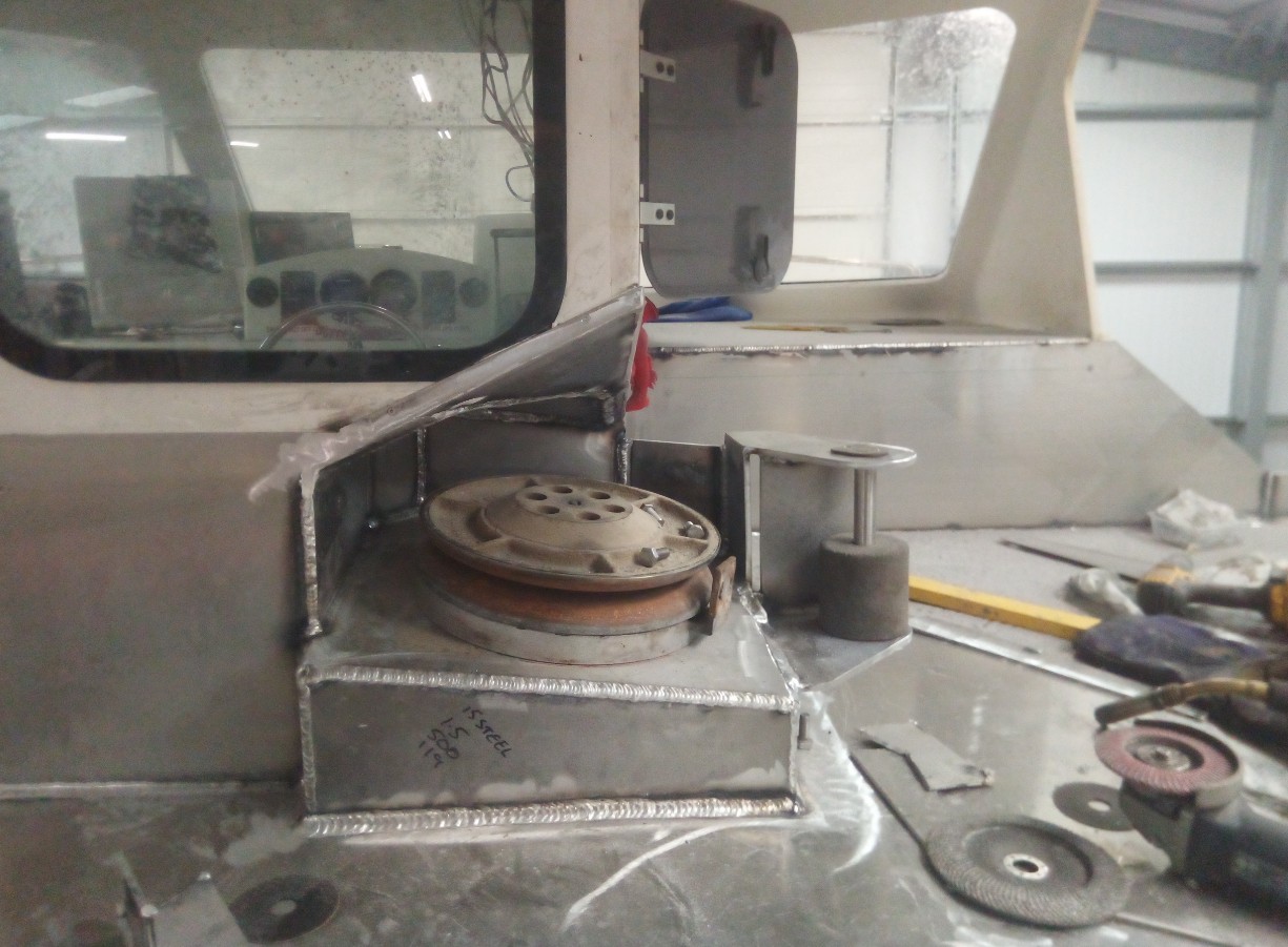

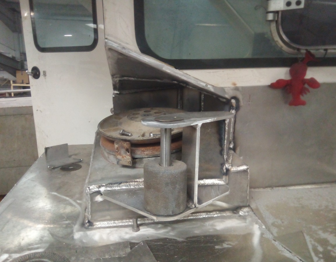

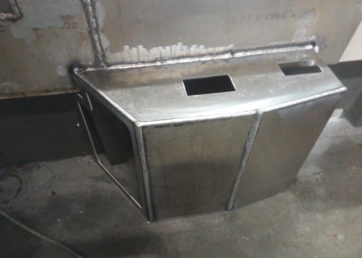

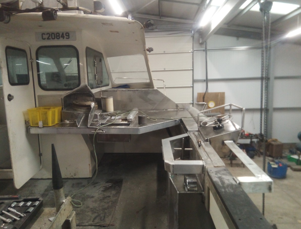

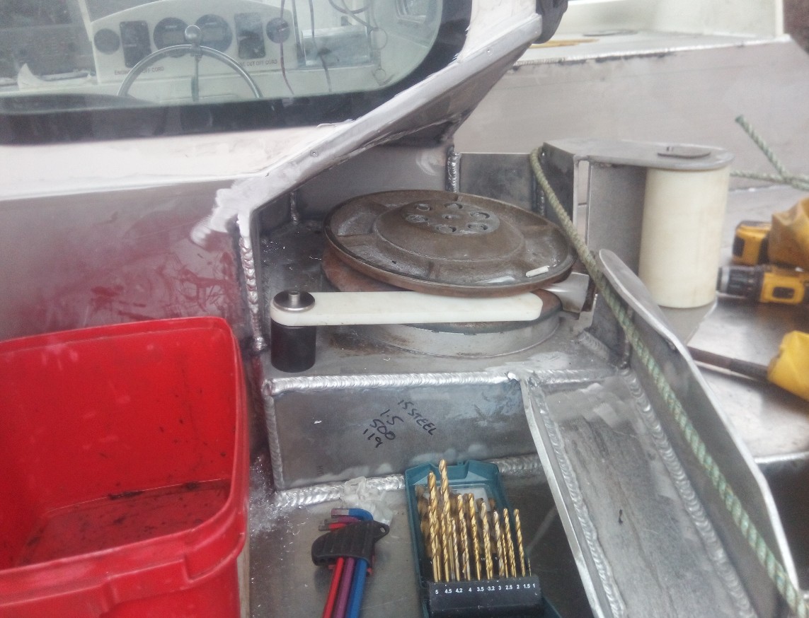

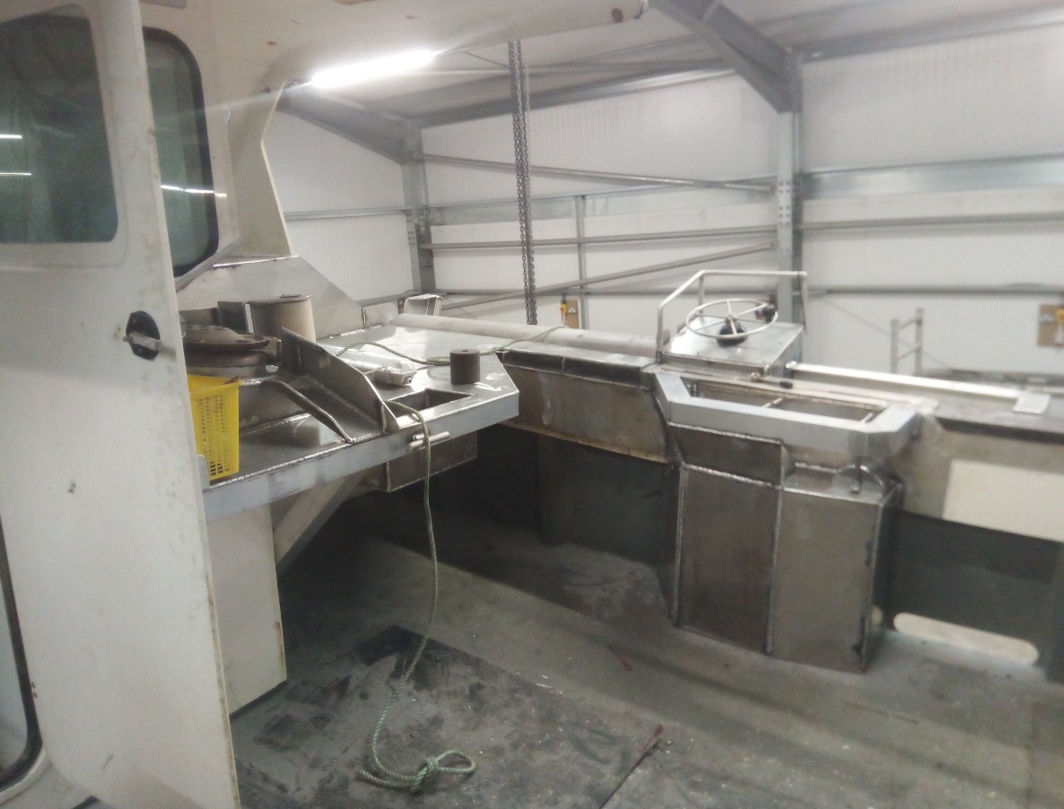

Got the hole cut in the wheelhouse for the hauler. Packed up the hauler to get the required angle and then measured for the 8mm plate that I cut on the plasma on my way home.
I also got the 5mm plates on the bulkhead and wheelhouse welded.

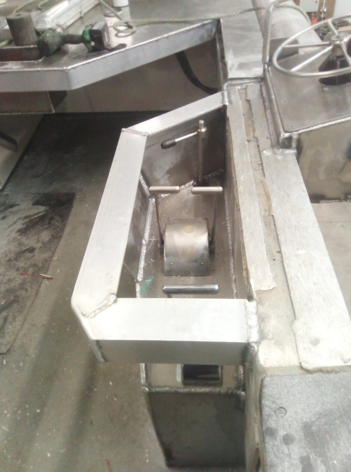

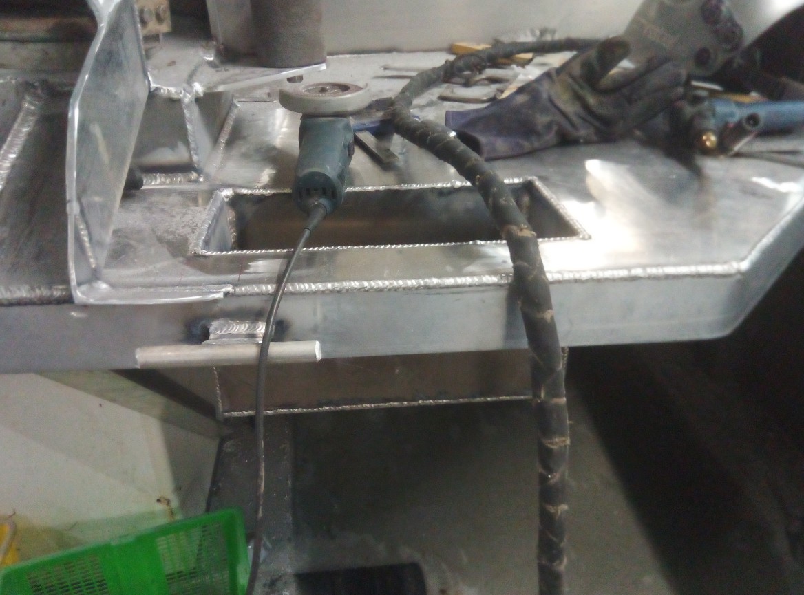

Welded up the box for the secondary helm pump and got that fitted and also welded in the top plate for the control handles. That allowed me to measure up for the front and sides which I also cut on the plasma on the way home.
