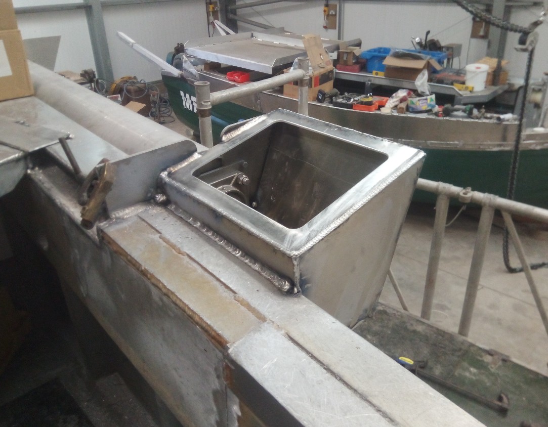

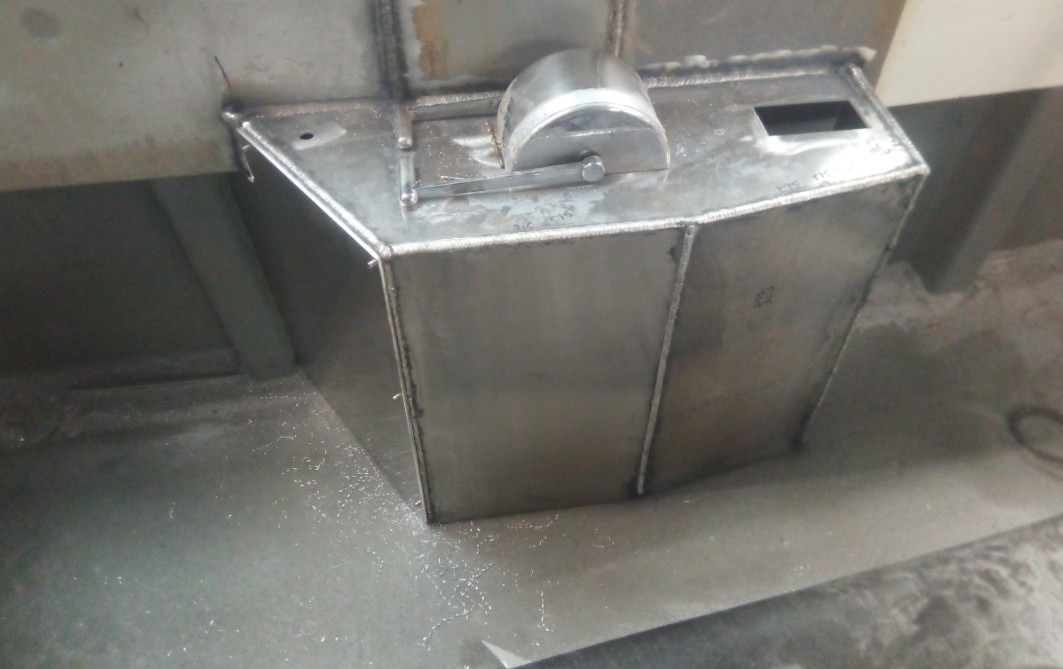

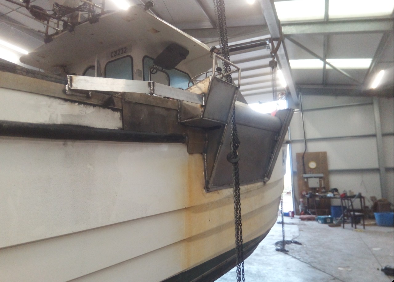

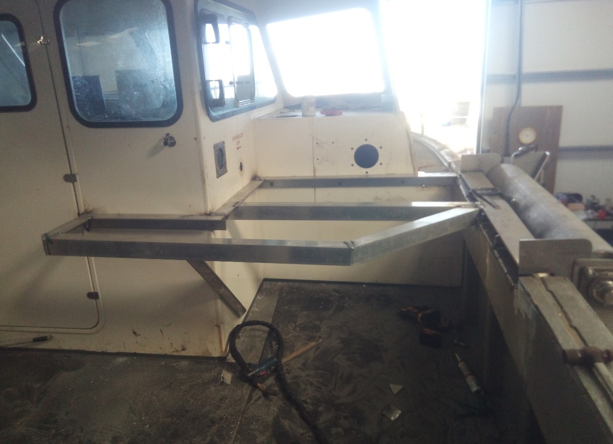

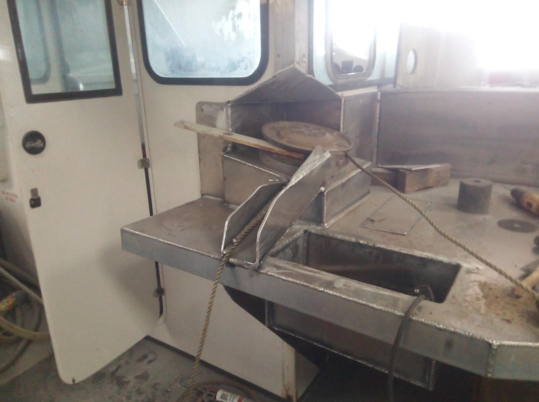

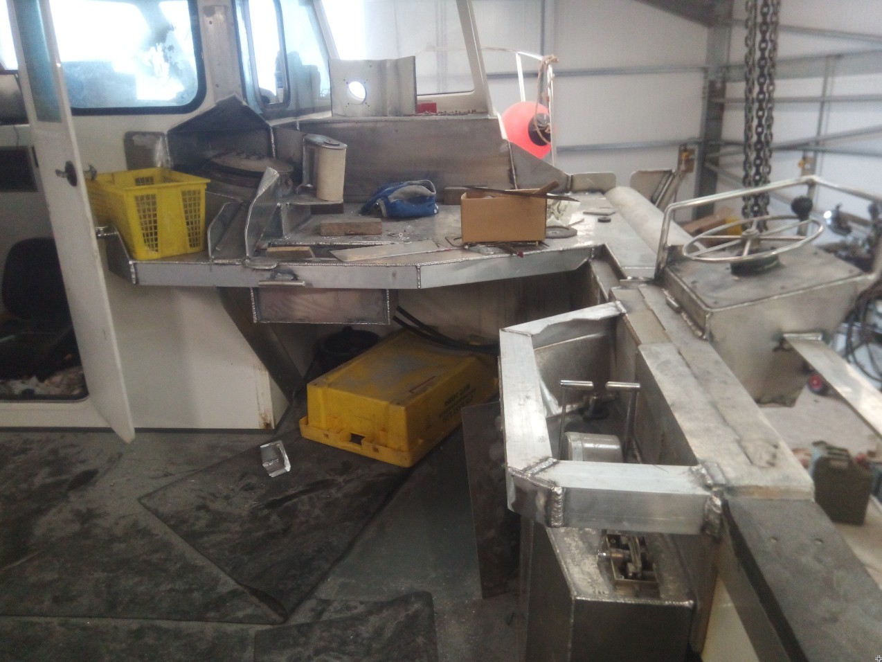

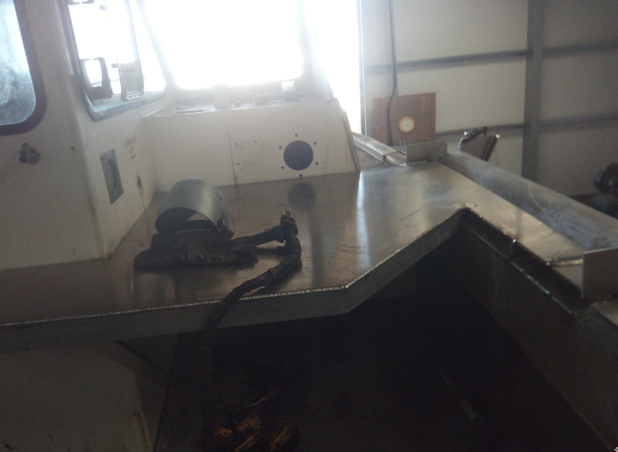

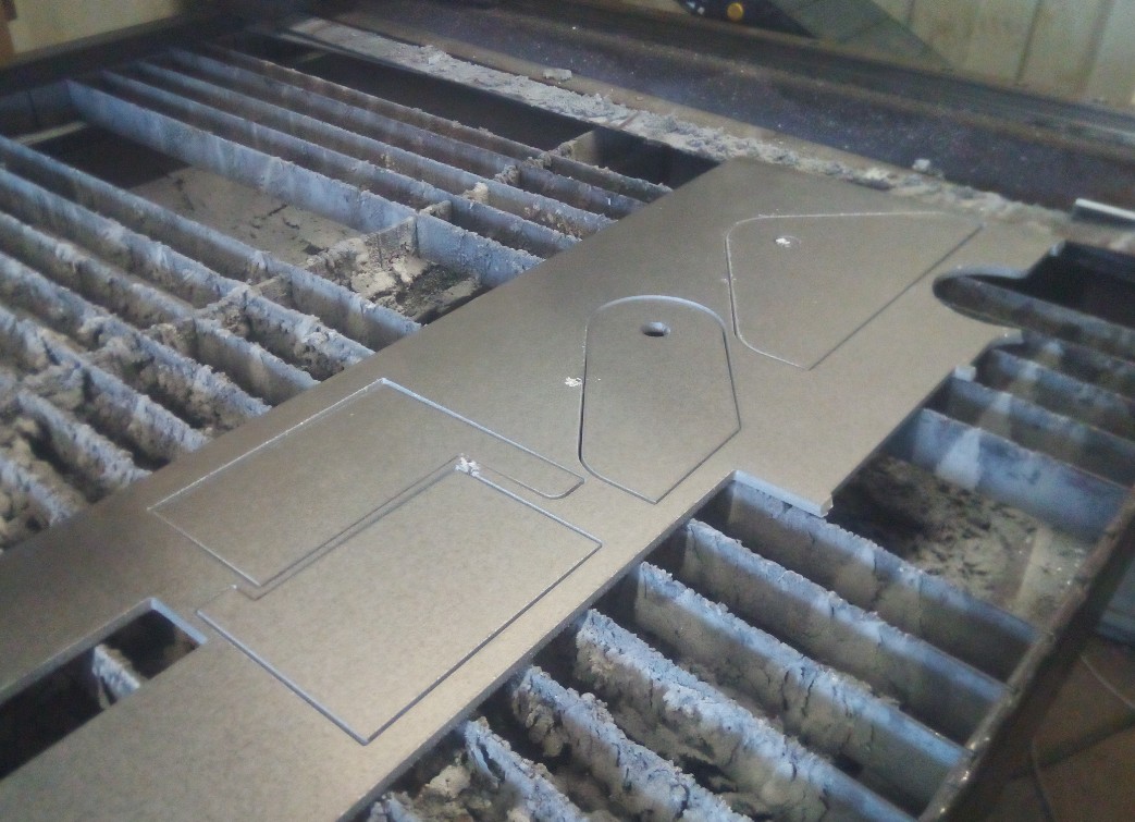

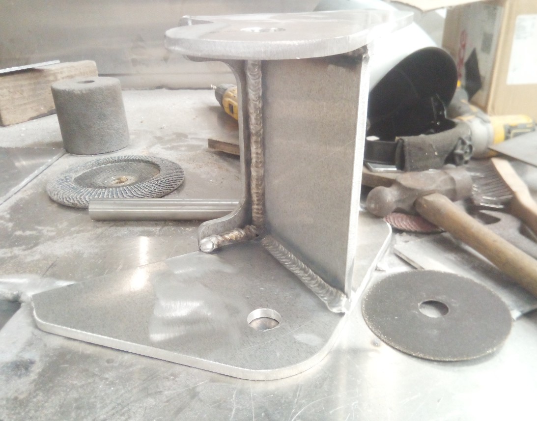

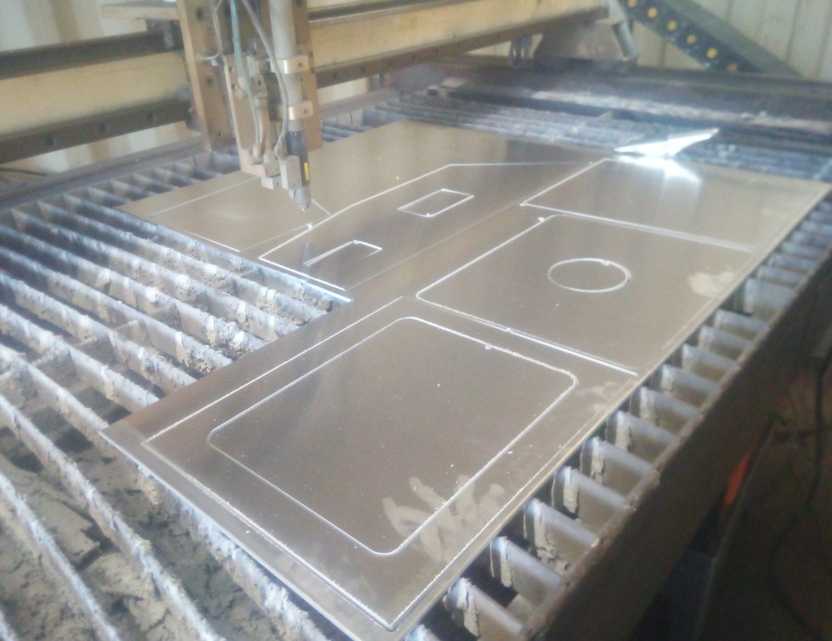

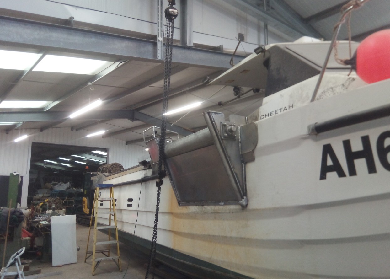

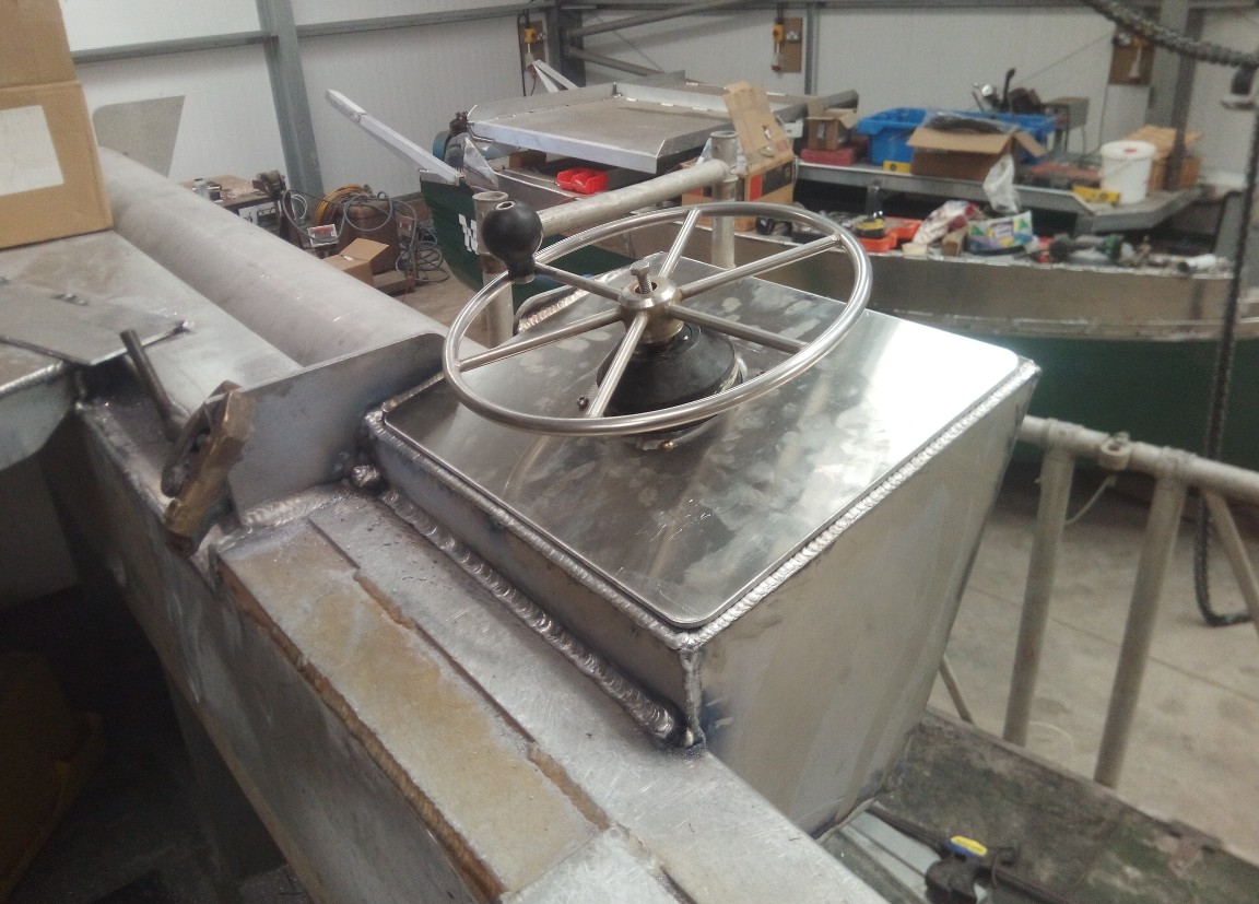

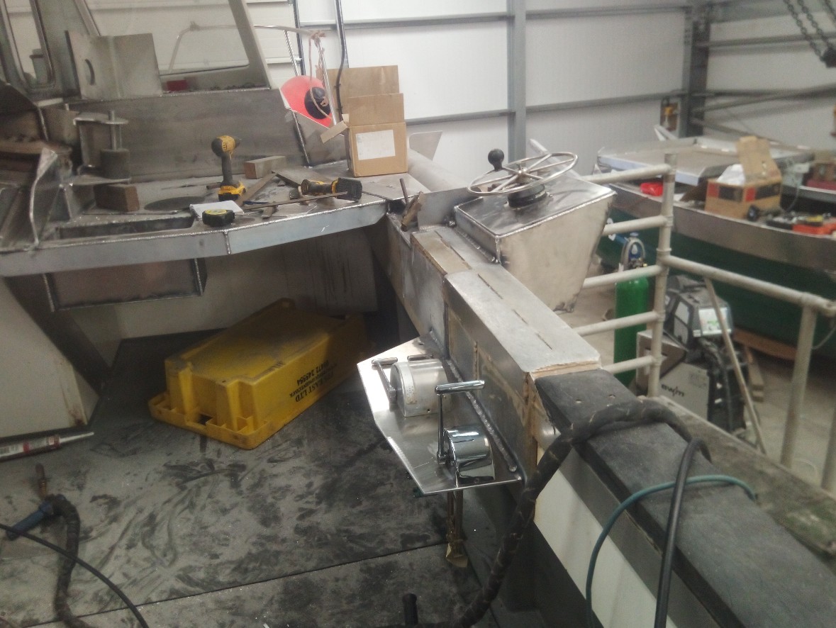

This afternoon I got the 8mm plates welded to complete the hauler box.
Also got the front edge between the wheelhouse and roller welded in.

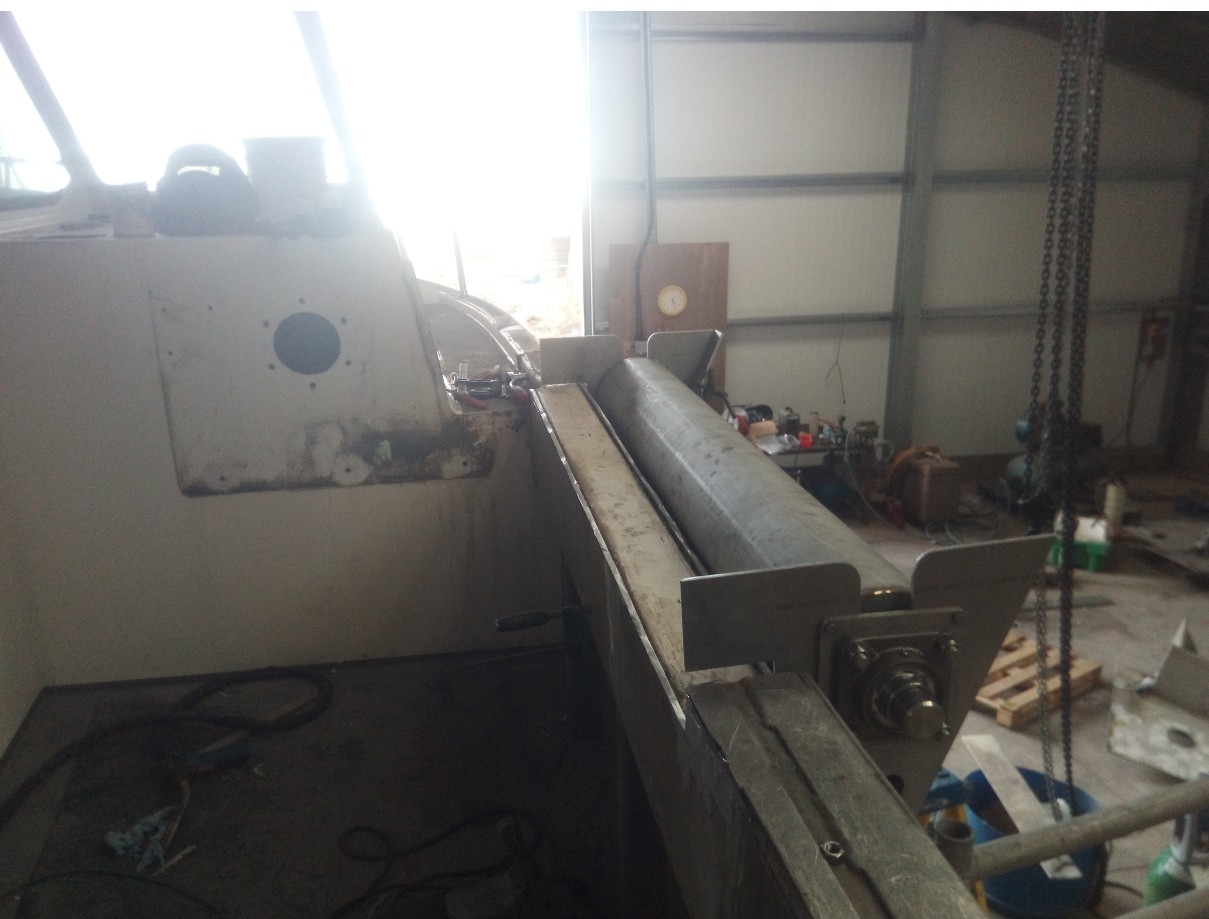

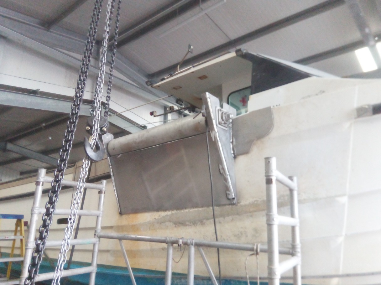

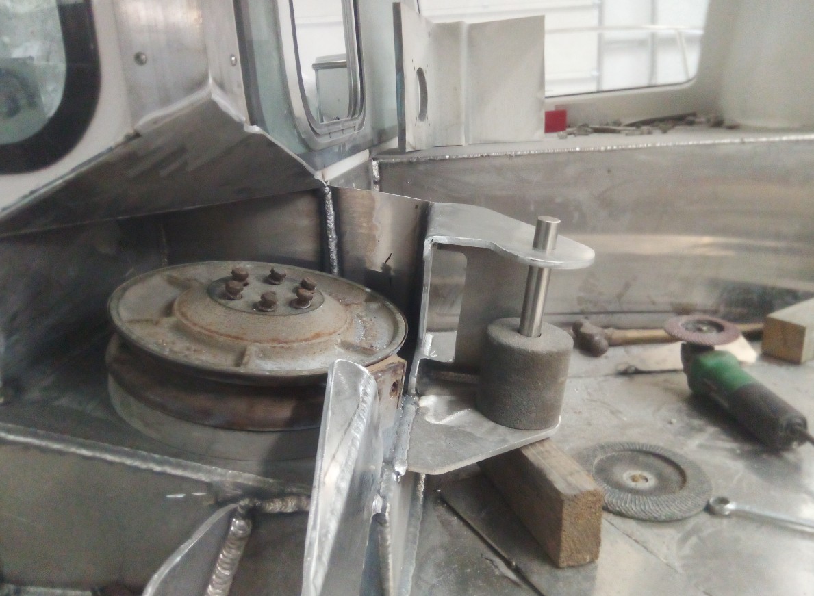

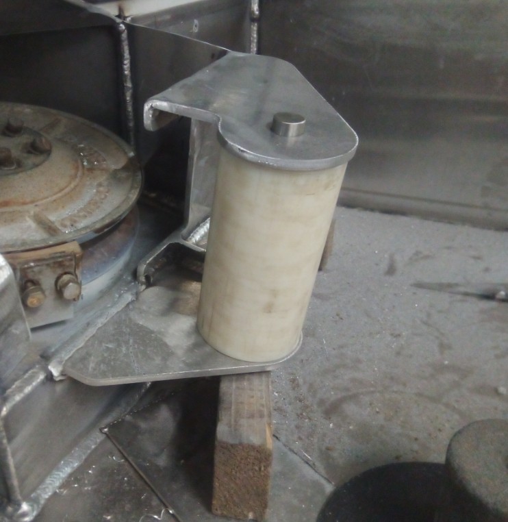

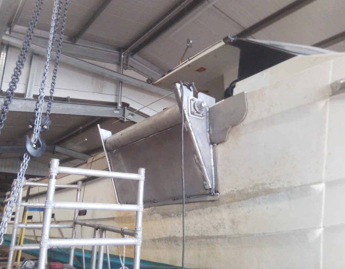

Next up was a working out where the guide roller will go and measuring up for the brackets.
Then I got the rope guide/chute welded in and tested, seems to coil the rope exactly where we wanted on the deck.
