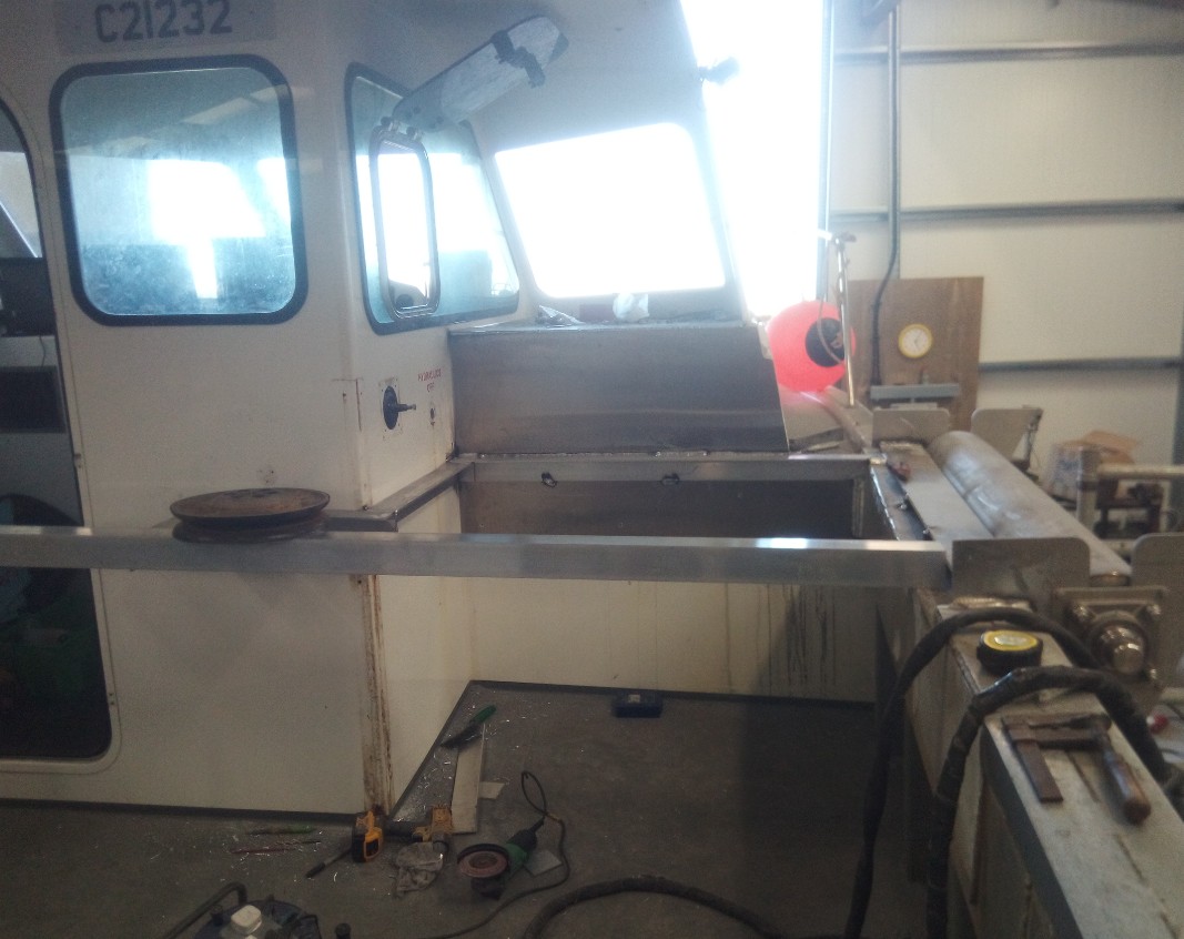

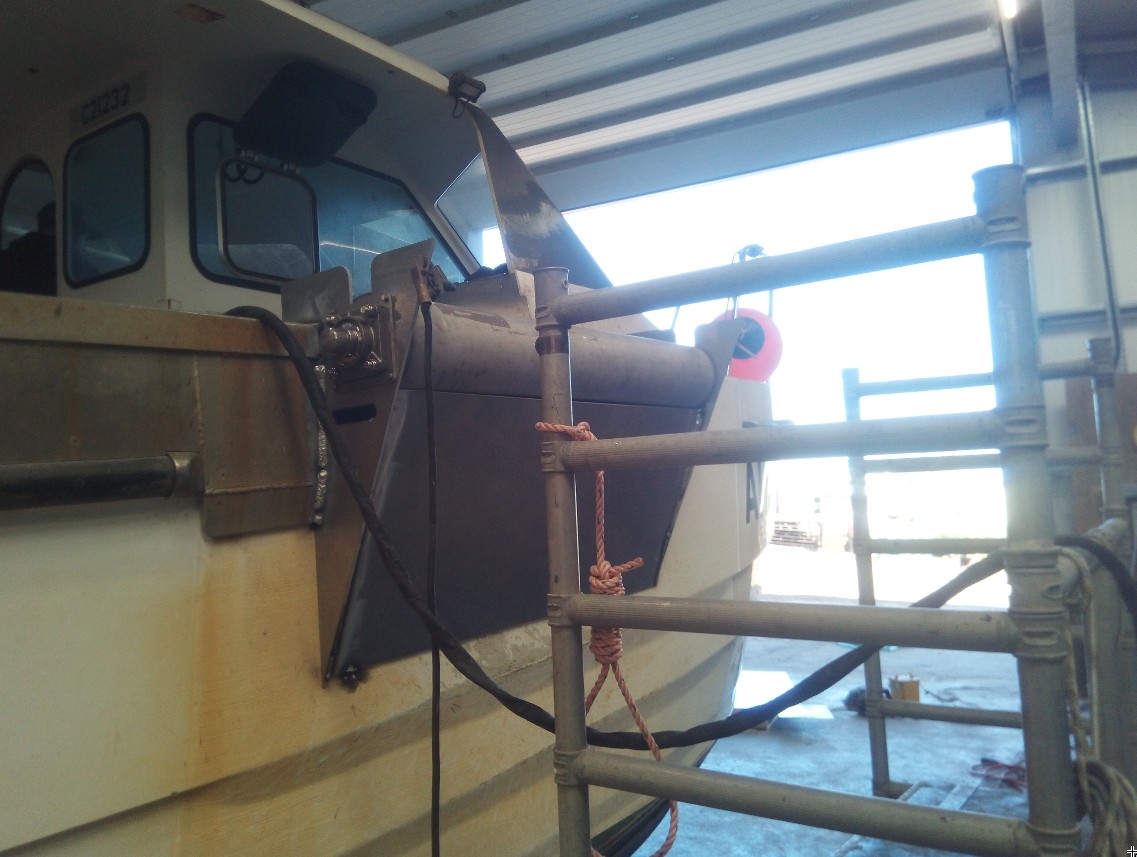

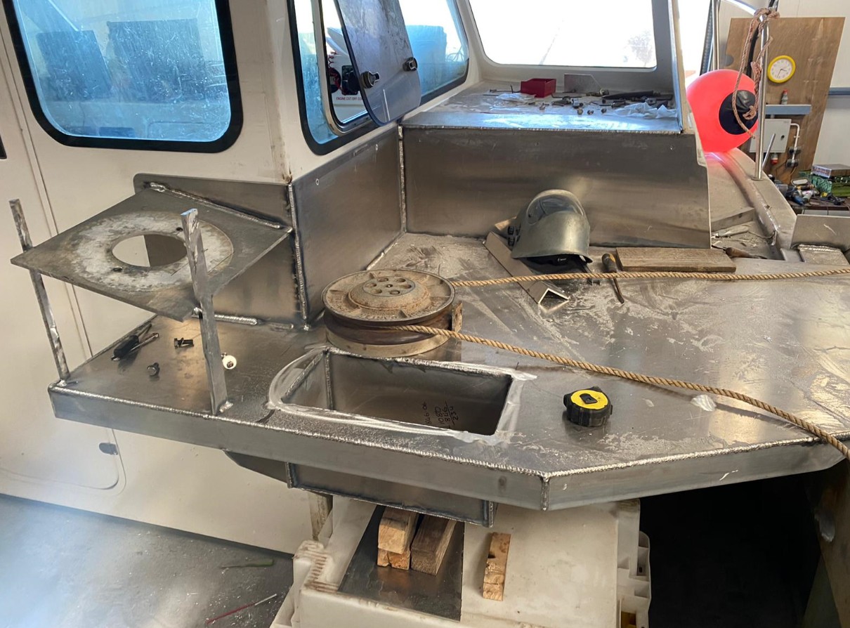

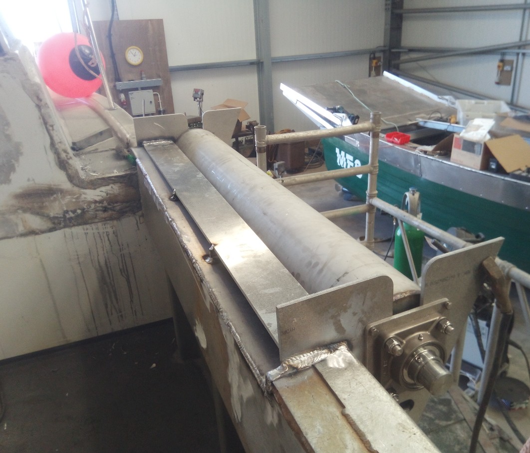

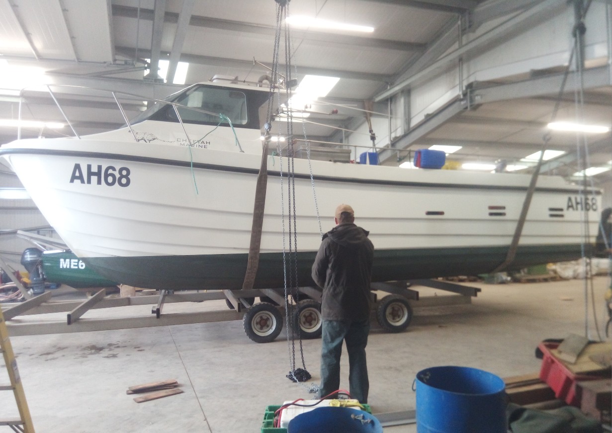

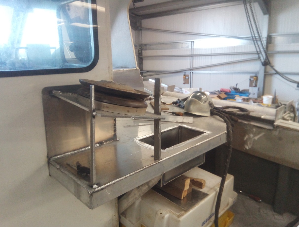

I have started on the latest roller system I will be putting on a boat. This is on a Cheetah Cat I fitted out about 2 years ago and it had a davit fitted at the time.
It is the outside one. I will be fitting the same to his brothers Cheetah later on in the year, that is the inside one.

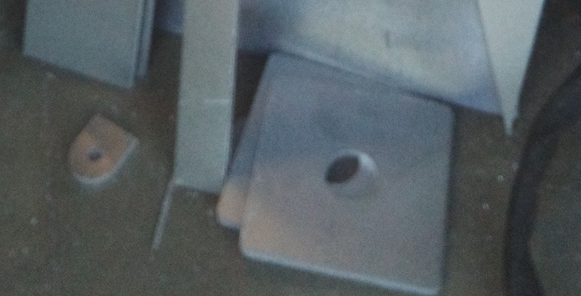

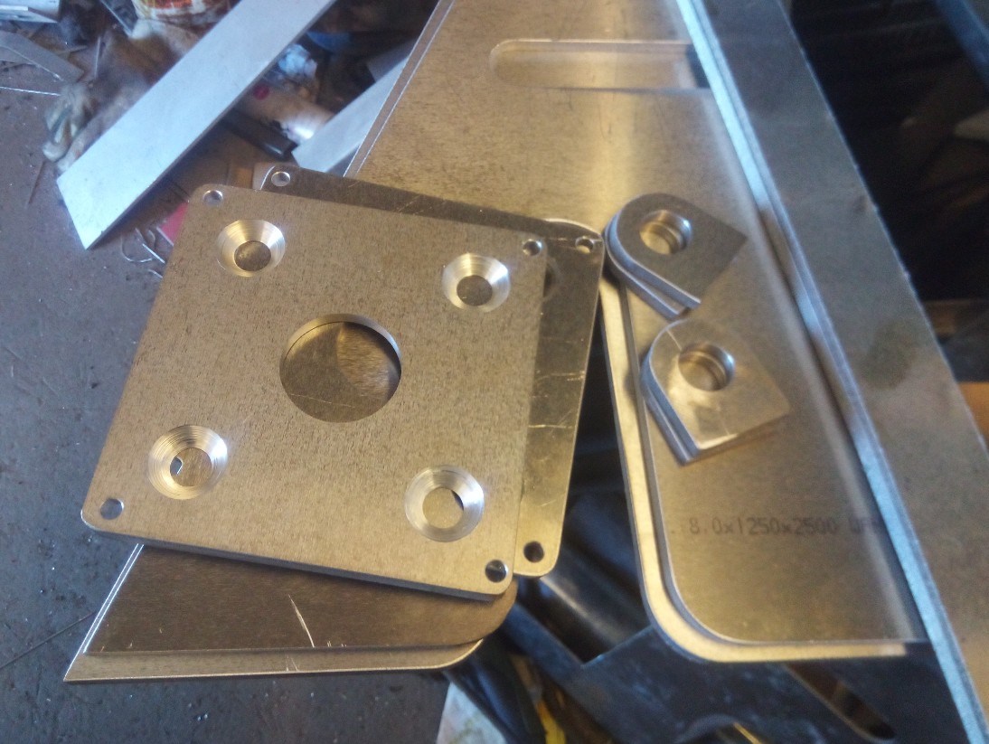

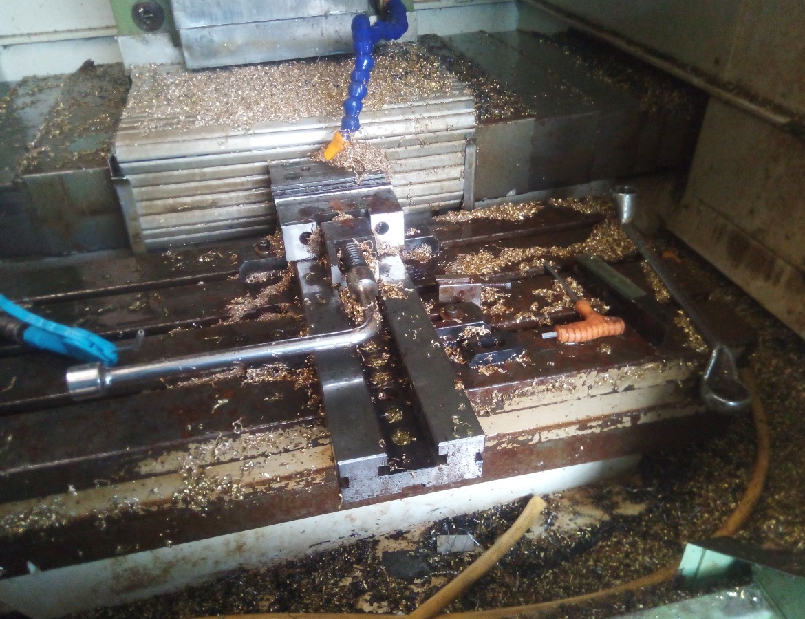

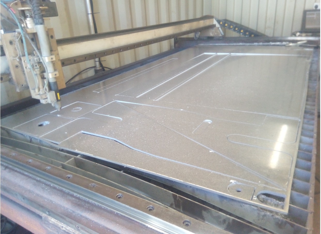

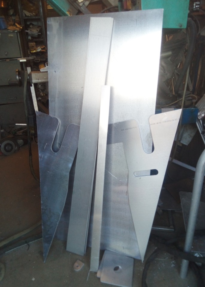

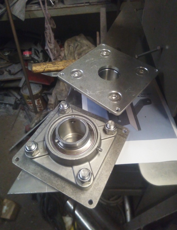

Last week I got some 8mm Aluminium cut up on the plasma.
Today I got the bearing plates (bottom of pic) milled out and contersunk and fitted the stainless housed bearings.

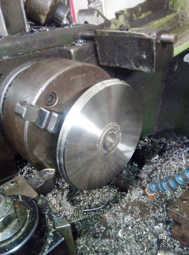

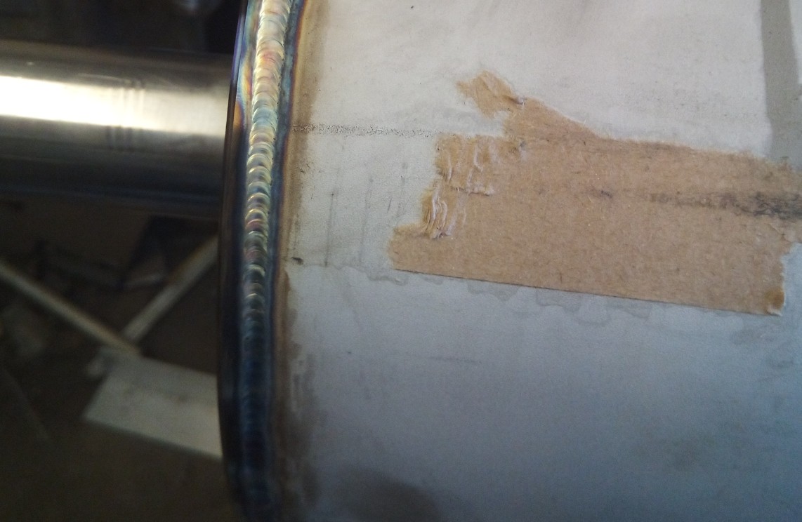

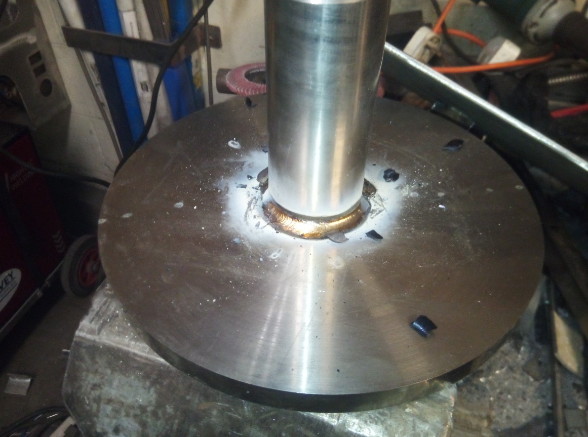

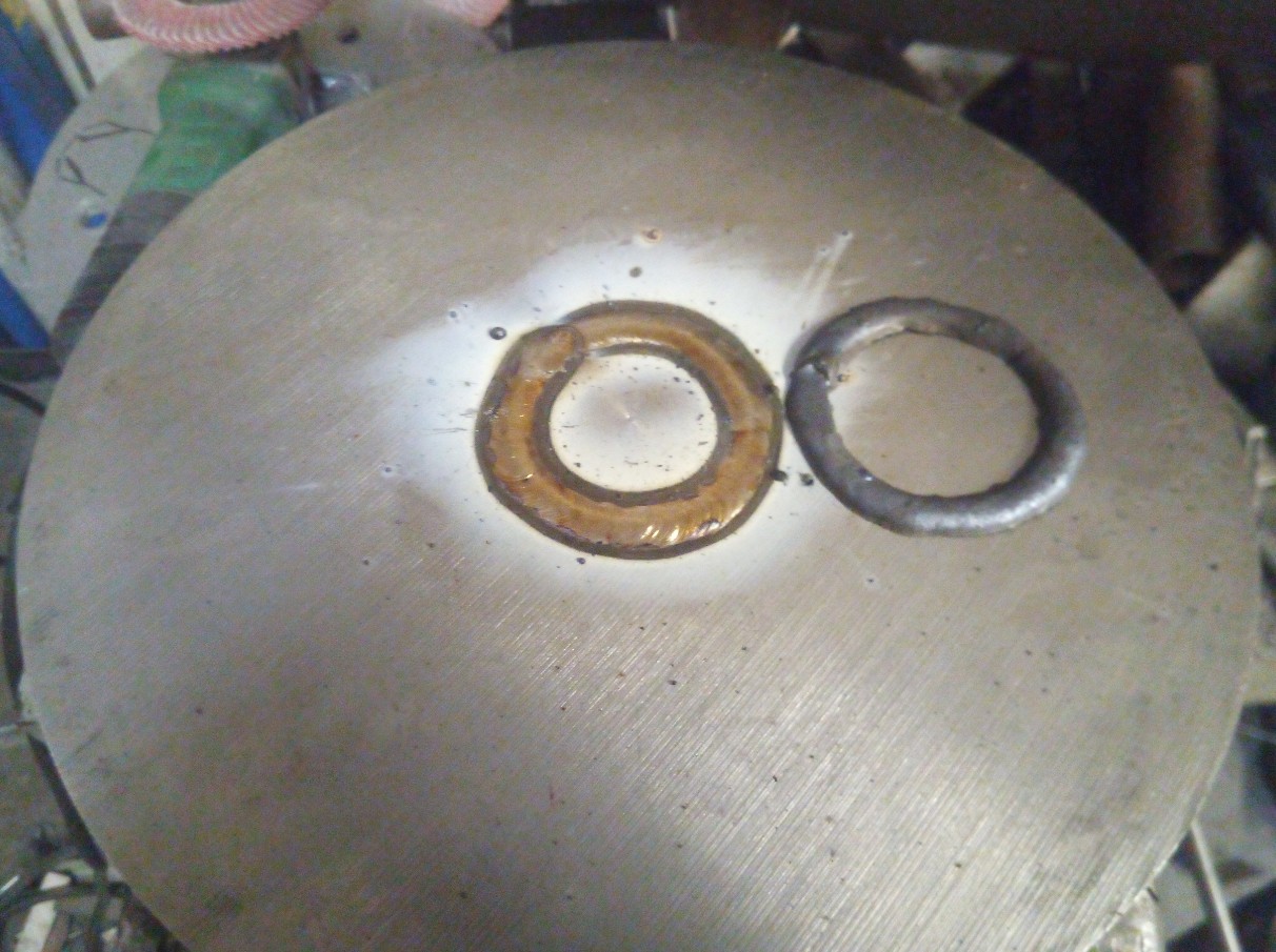

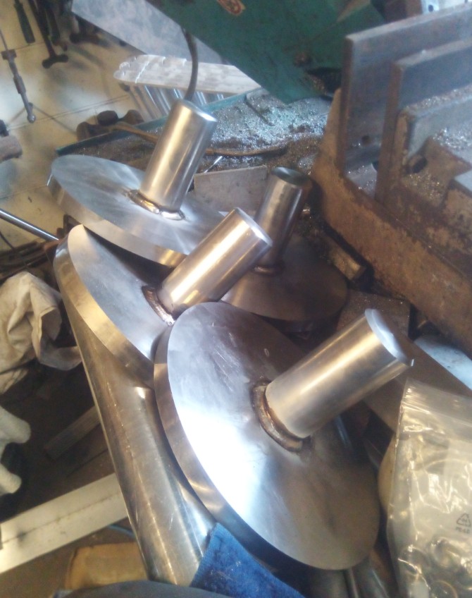

I then bored out some slices of 228mm Dia x 16mm thick 316 and then welded in some 50mm stub shafts.
Even managed to make a slag ring, usually the slag pops off into 3 or 4 pieces but this one popped off intact
Got the other side welded.
Then did the other 3 (2 for this, 2 for the next)

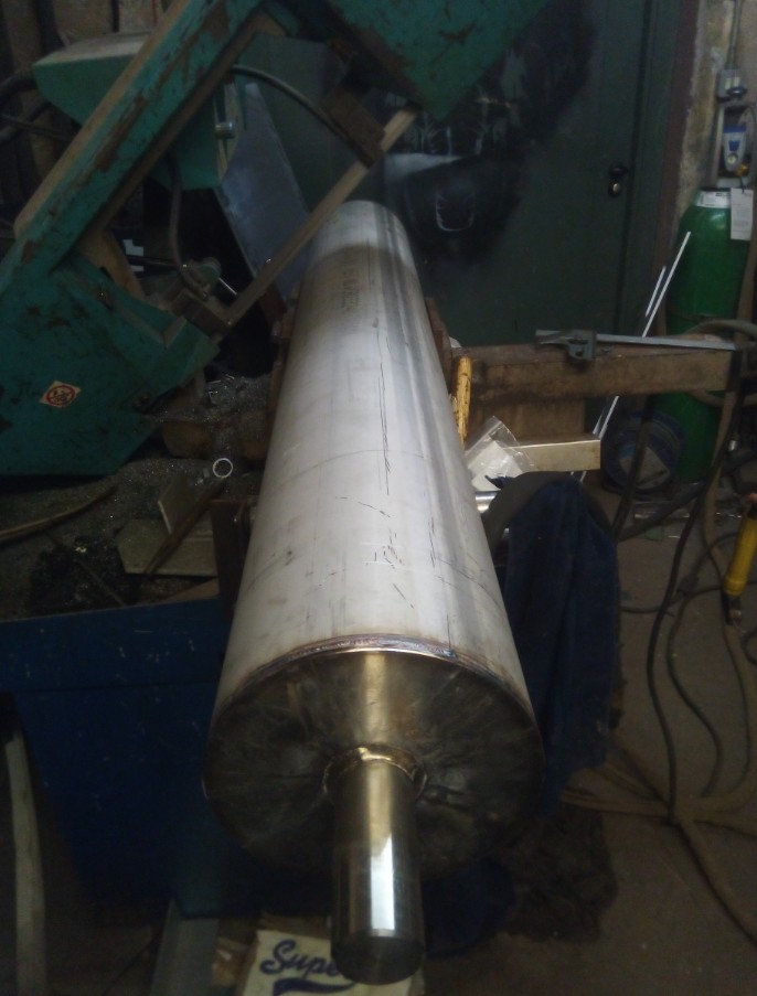

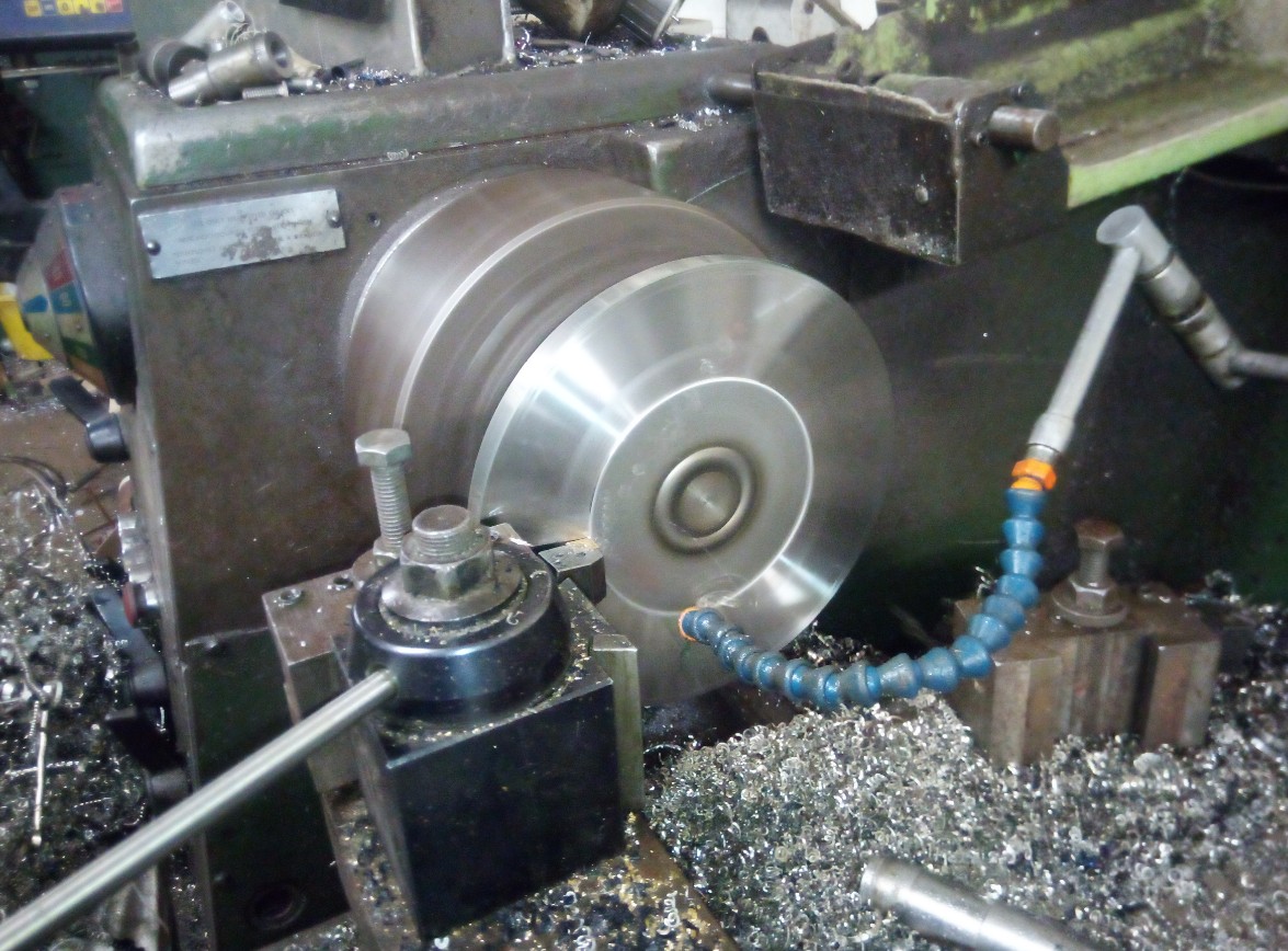

Popped them back in the lathe to turn the OD to size (220mm Dia) and a stepped section for fitting into the 8" nominal bore pipe.
Then got the the two of them welded into the pipe to make the roller, it is 1420mm long.
