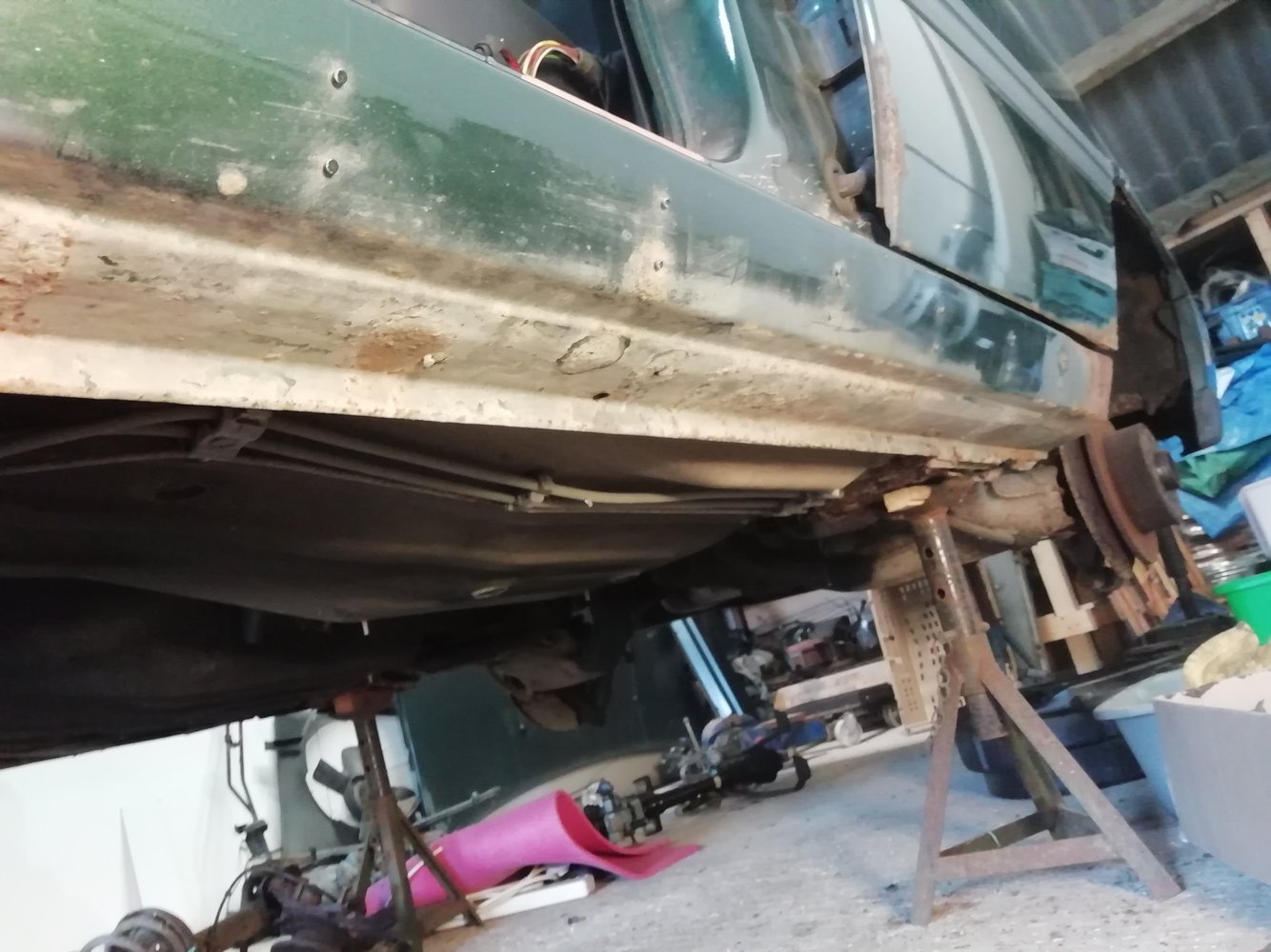

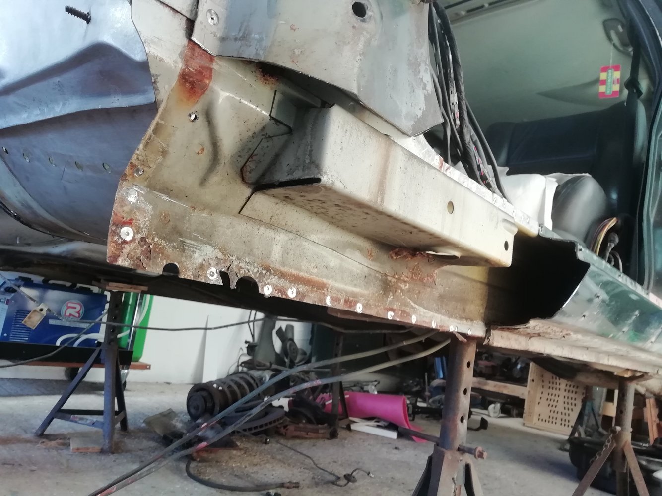

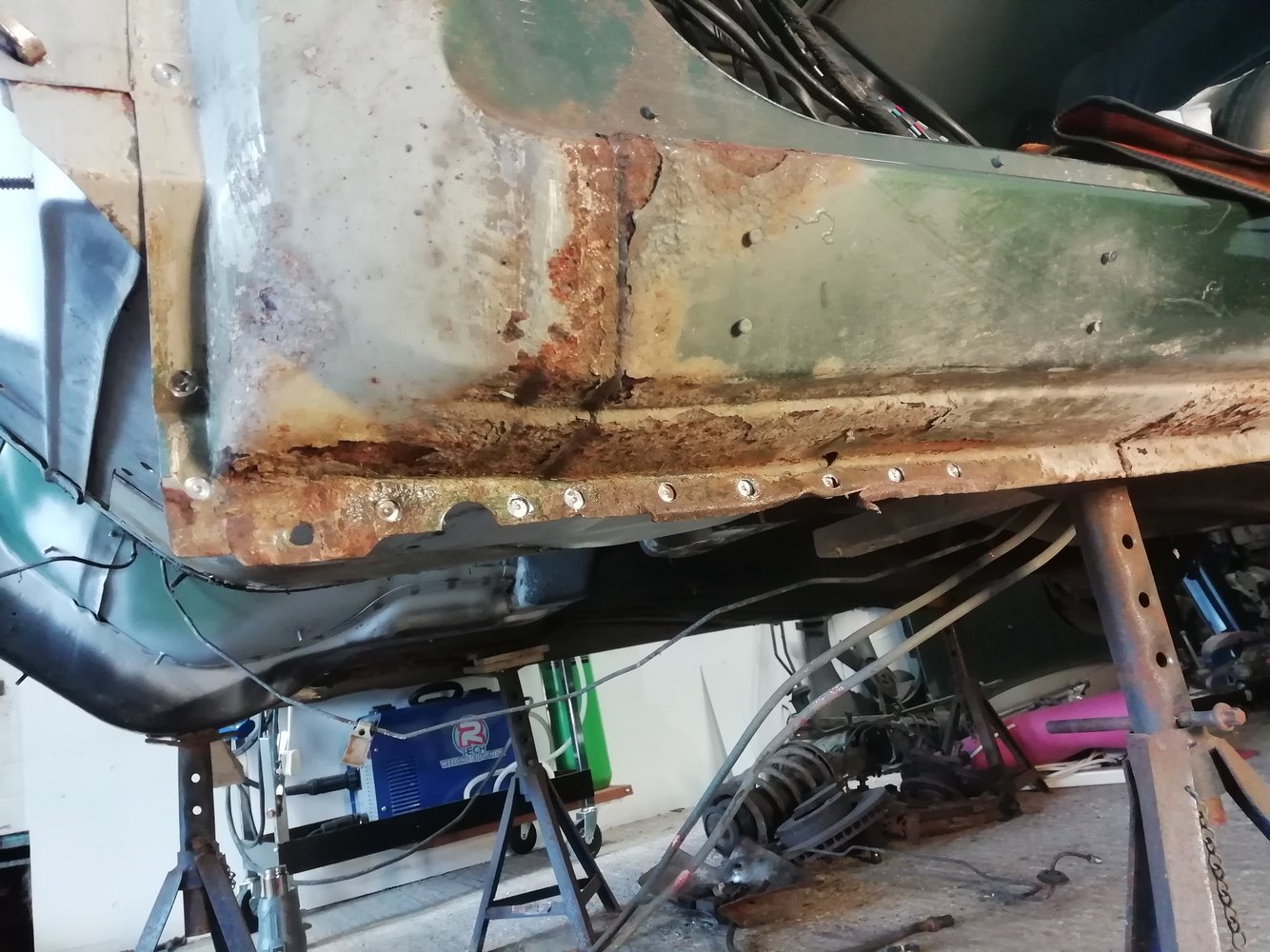

Didnt manage a great deal today, before I can finish the floor and get the chassis leg welded on the Bottom A post area wanted checking, standard trim for these is the big full length plastic sill covers which hide a multitude of sins! the whole sill on this side is pretty horrid looking having had a few big MOT patches over the years

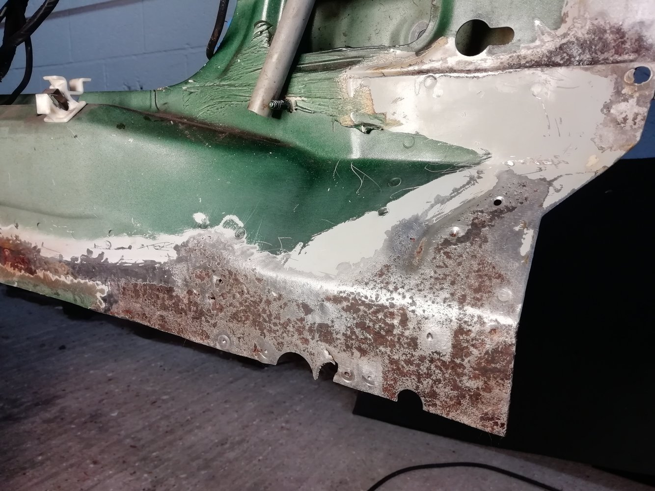

Popped a chunk off the front to see what's hiding, Oh that doesn't look bad at all considering the sunroof drains into that corner as well, just means the whole sill needs to come off now, luckily I've a couple of new old stock genuine sills which should make a nice job
