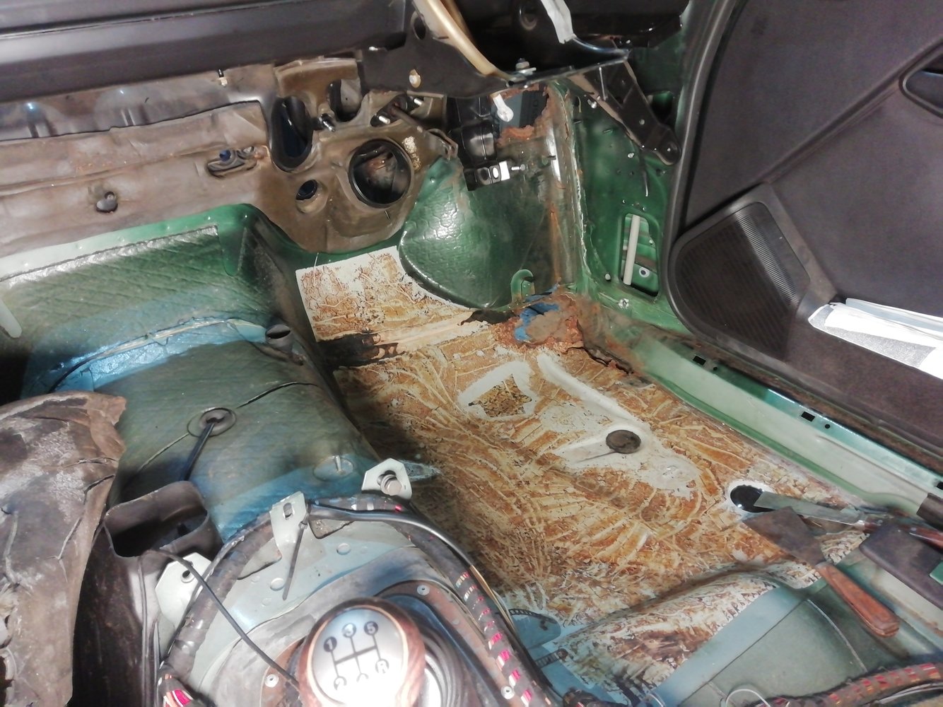

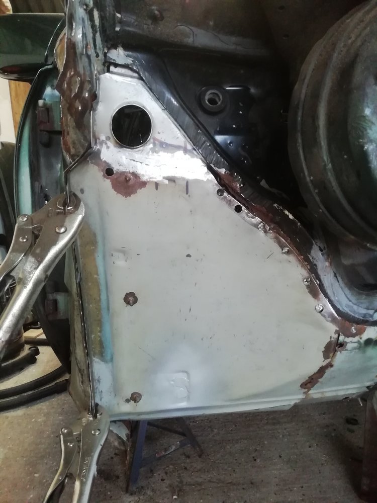

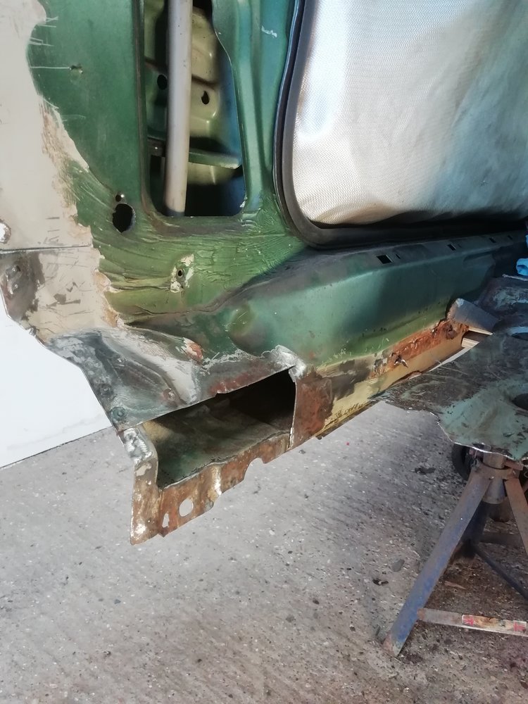

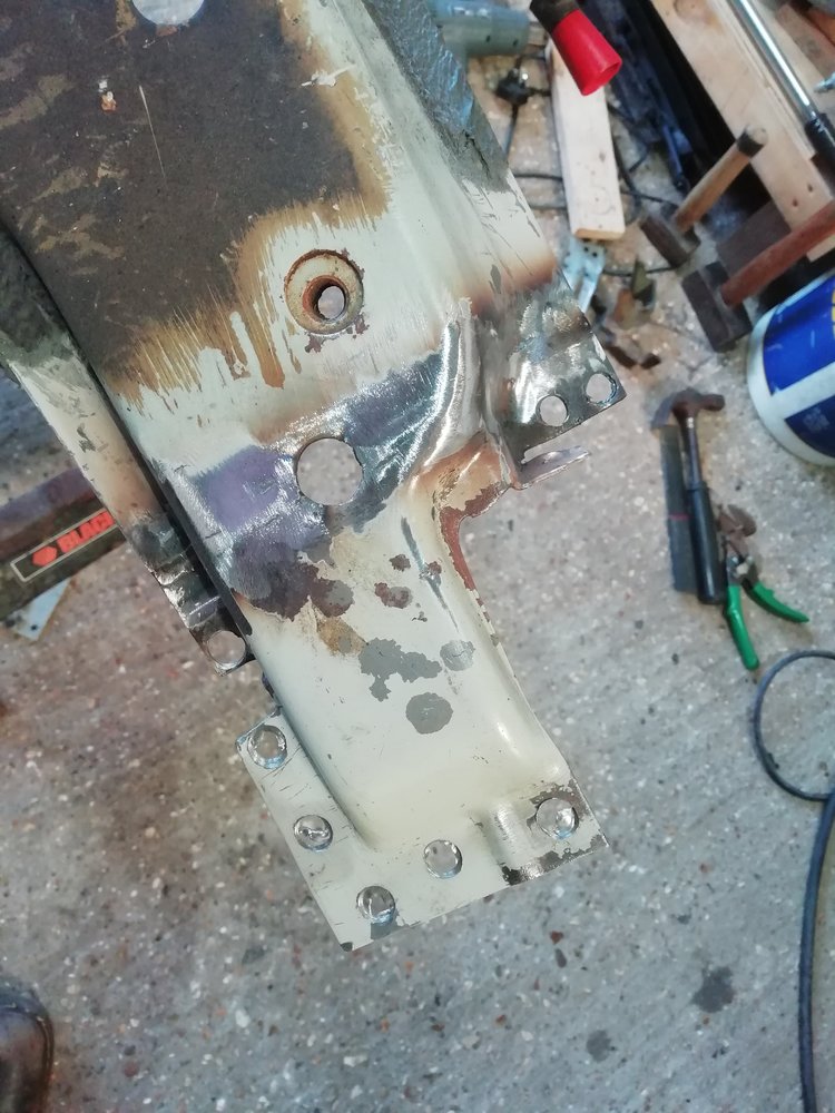

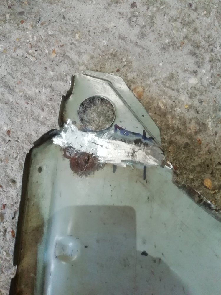

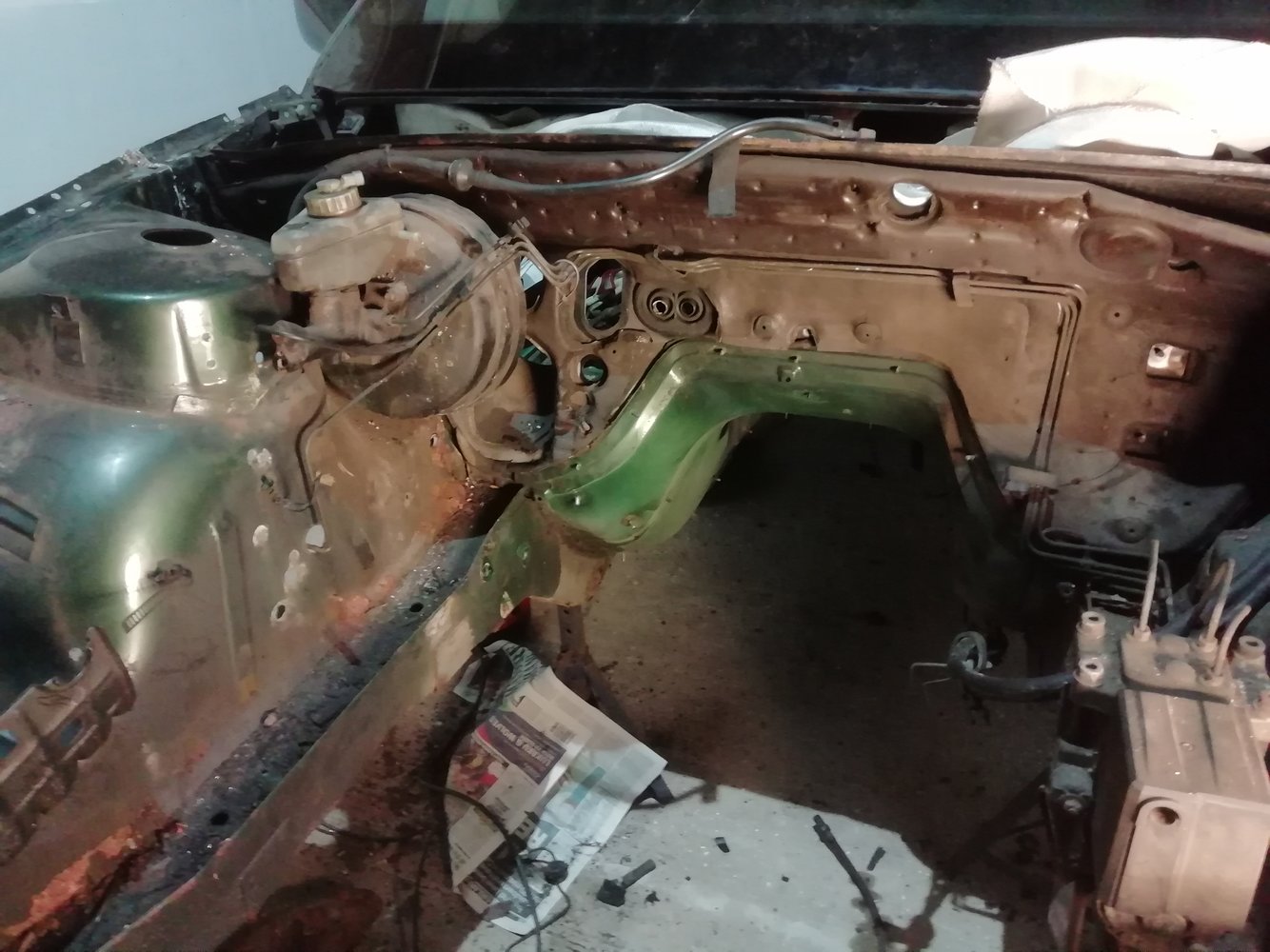

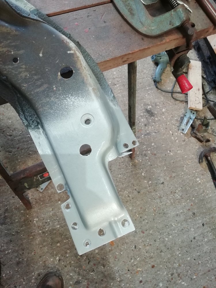

Been a bit of a drag with me 98 year old dad in the hospital so havent done much but that changed this weekend, lots of stripping still, steering box, steering column, pedal box, heater box and sound deadening to get here

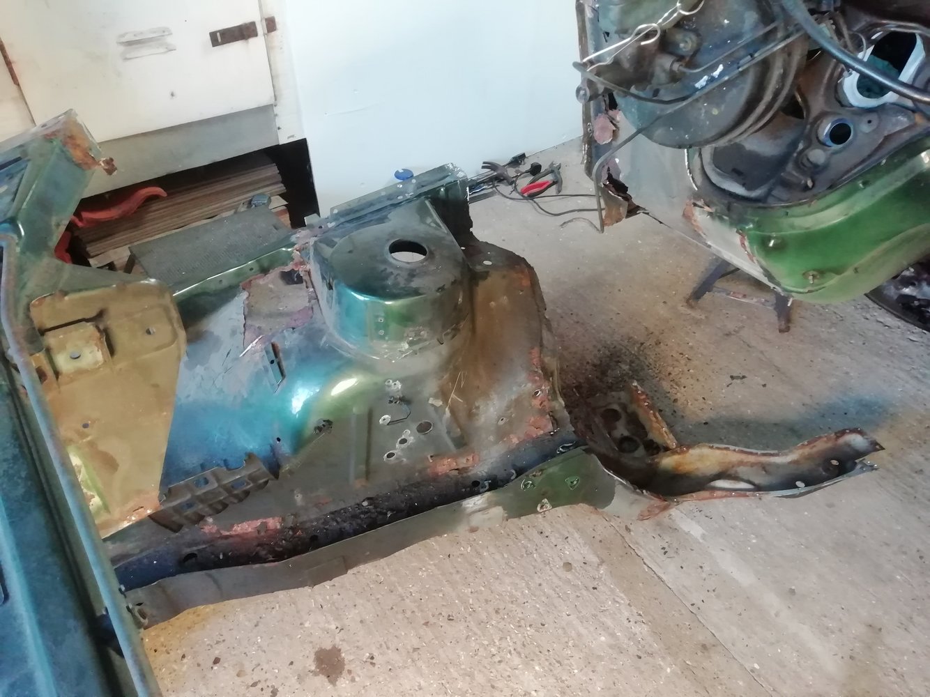

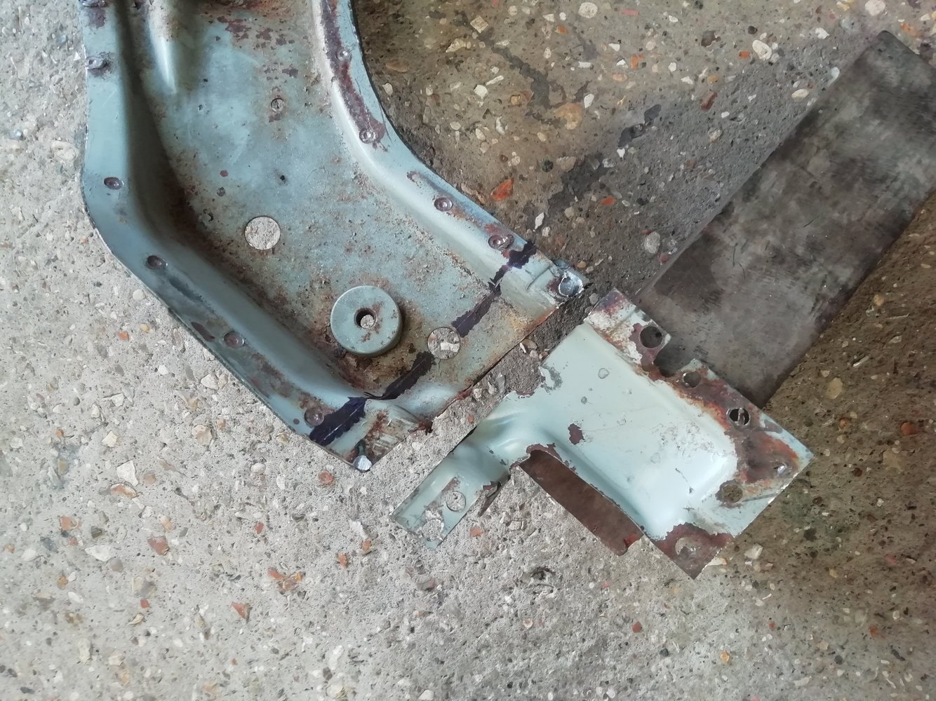

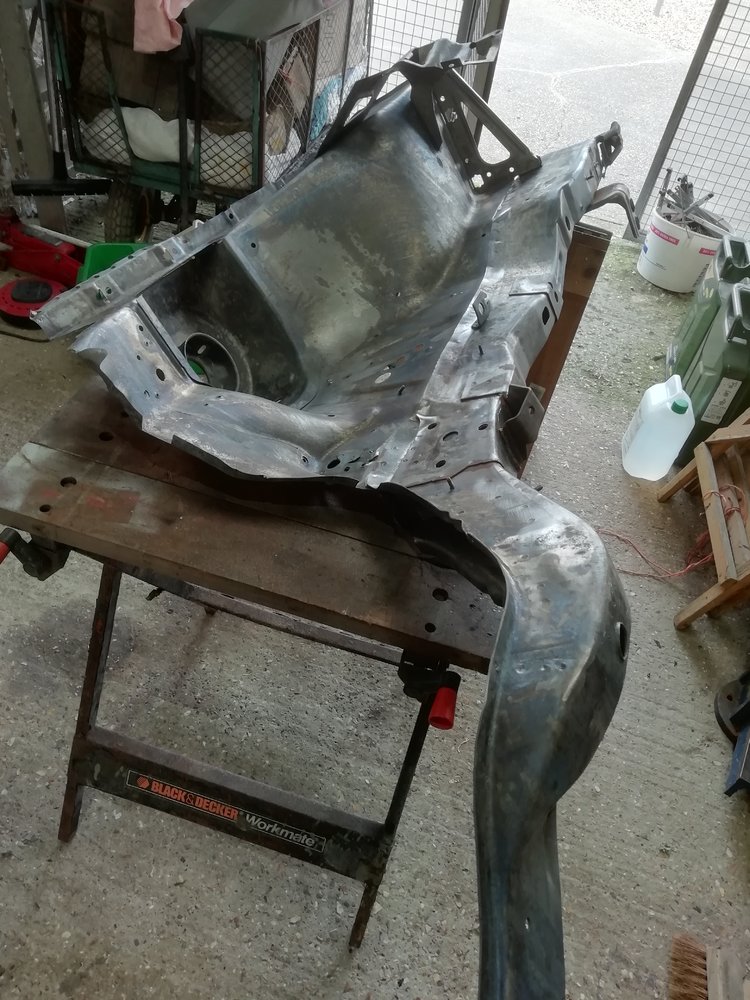

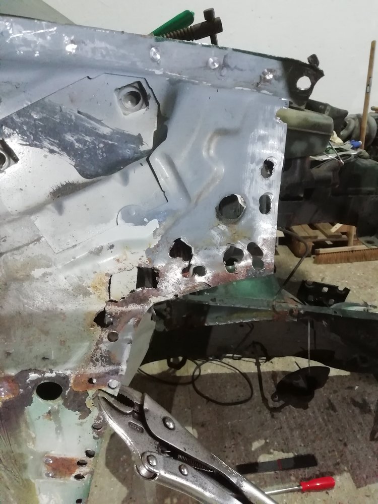

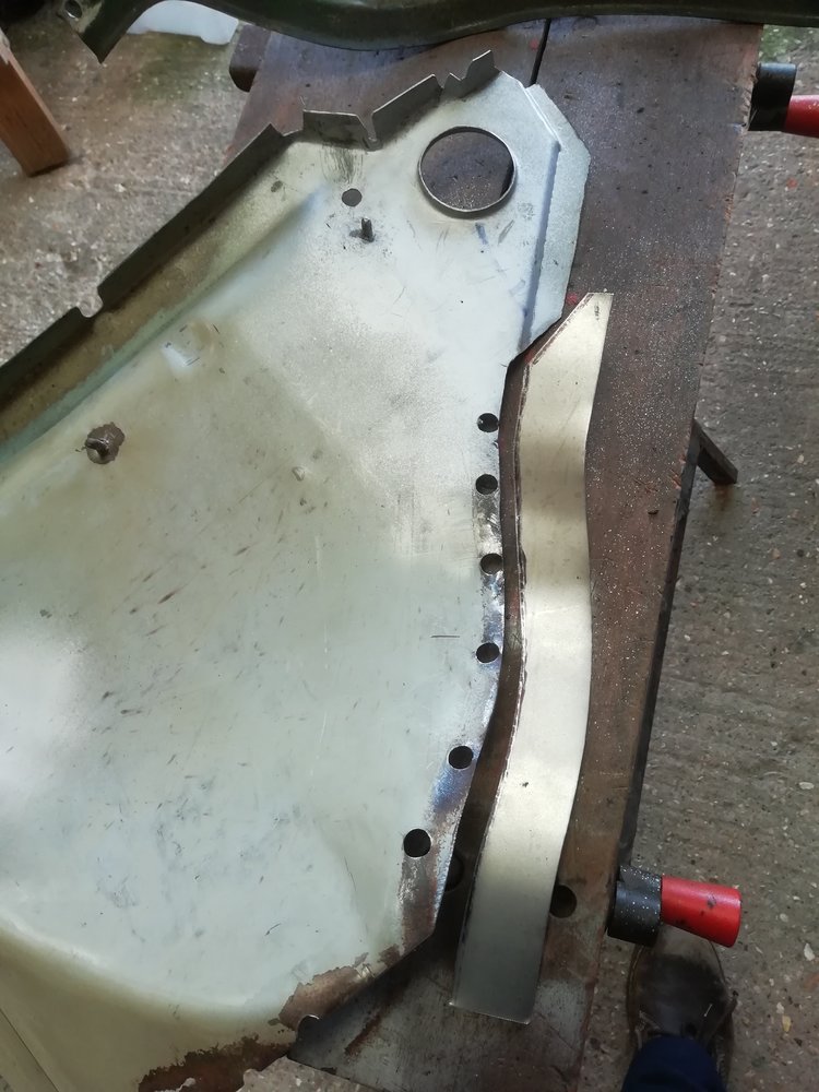

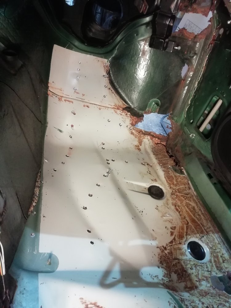

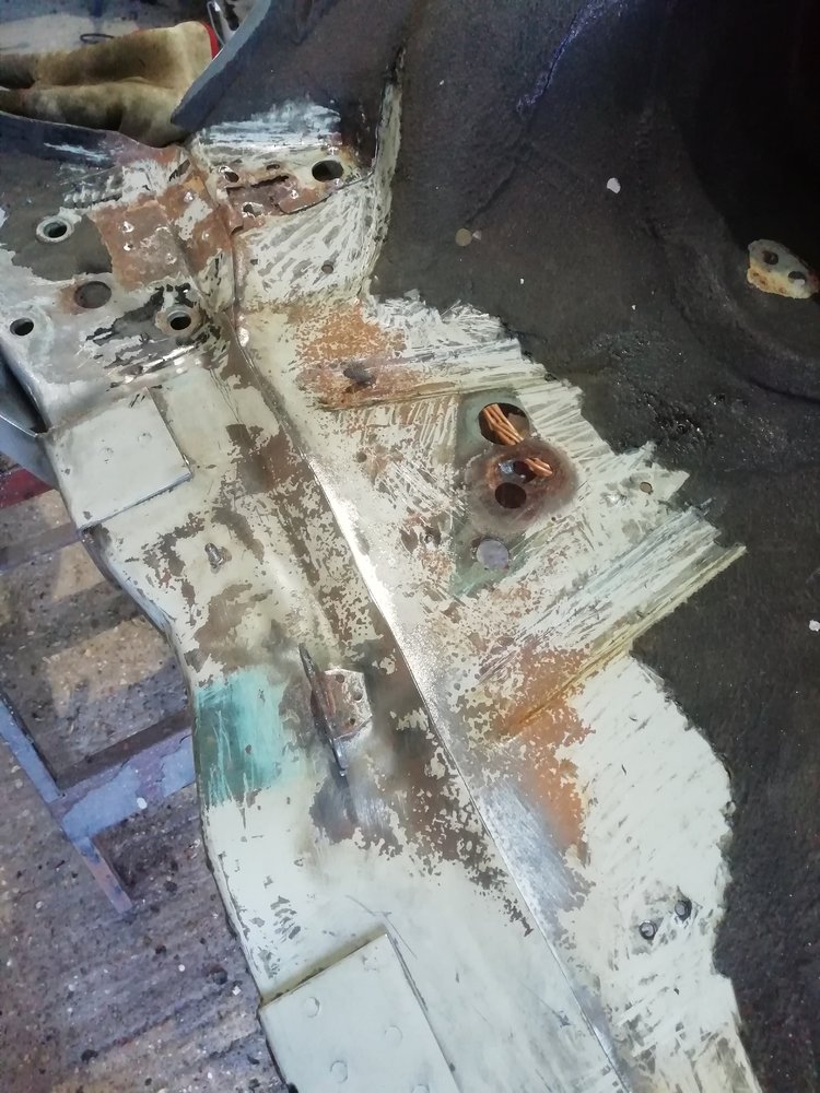

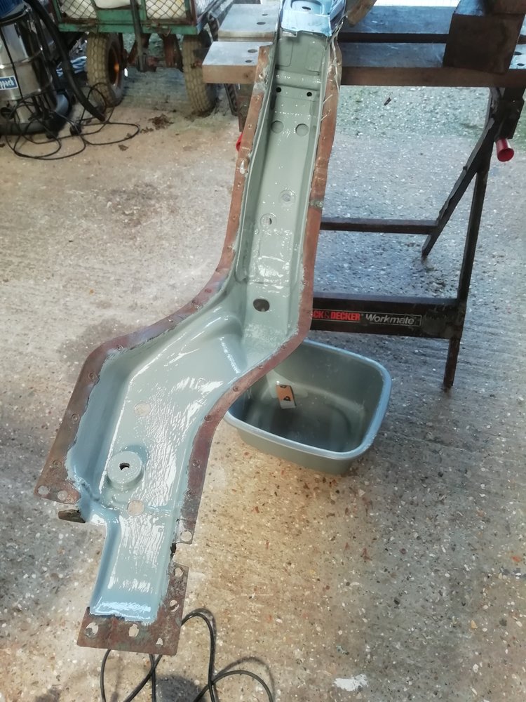

Floor pan cleaned up and spotwelds drilled out to get the chassis rail and wing assembly off

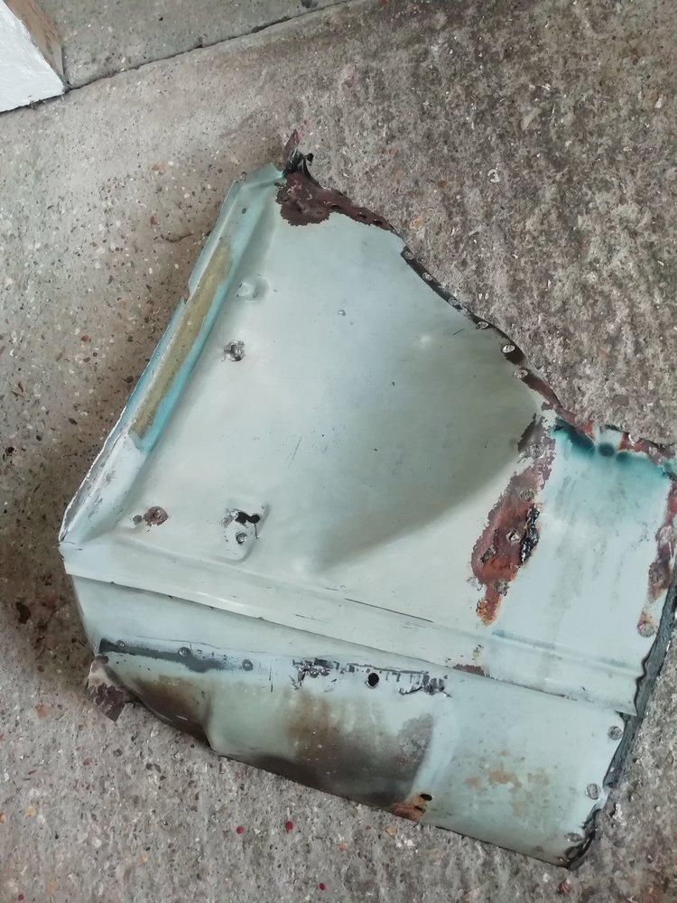

and leg off!
With the body cuts I have "installation is reversal of removal"

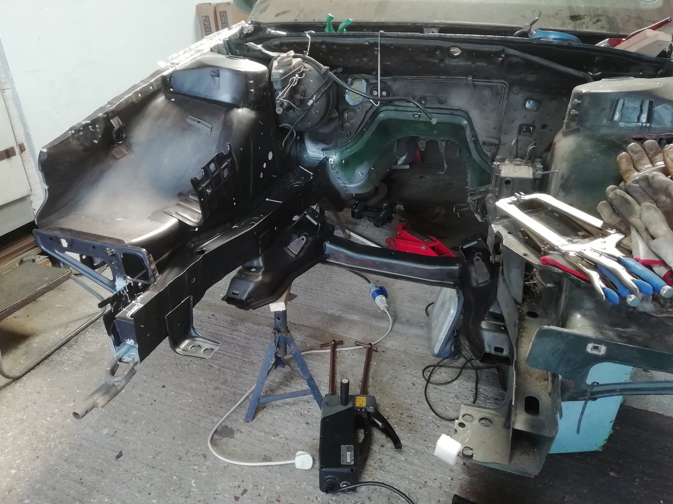

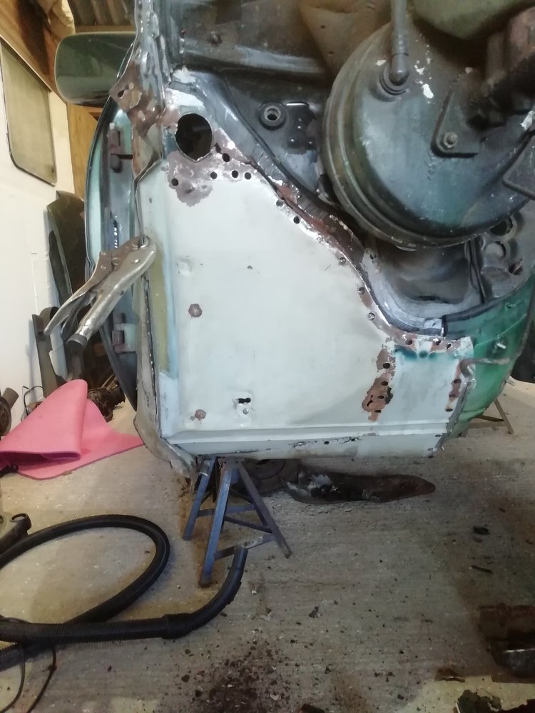

and leg off!
it will be a case of trawling the net to get various conflicting ideas and then do something else!
