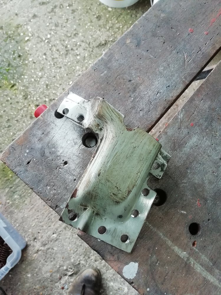

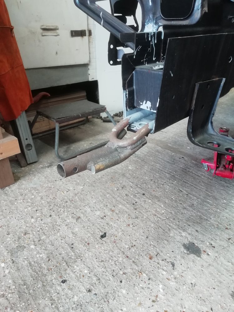

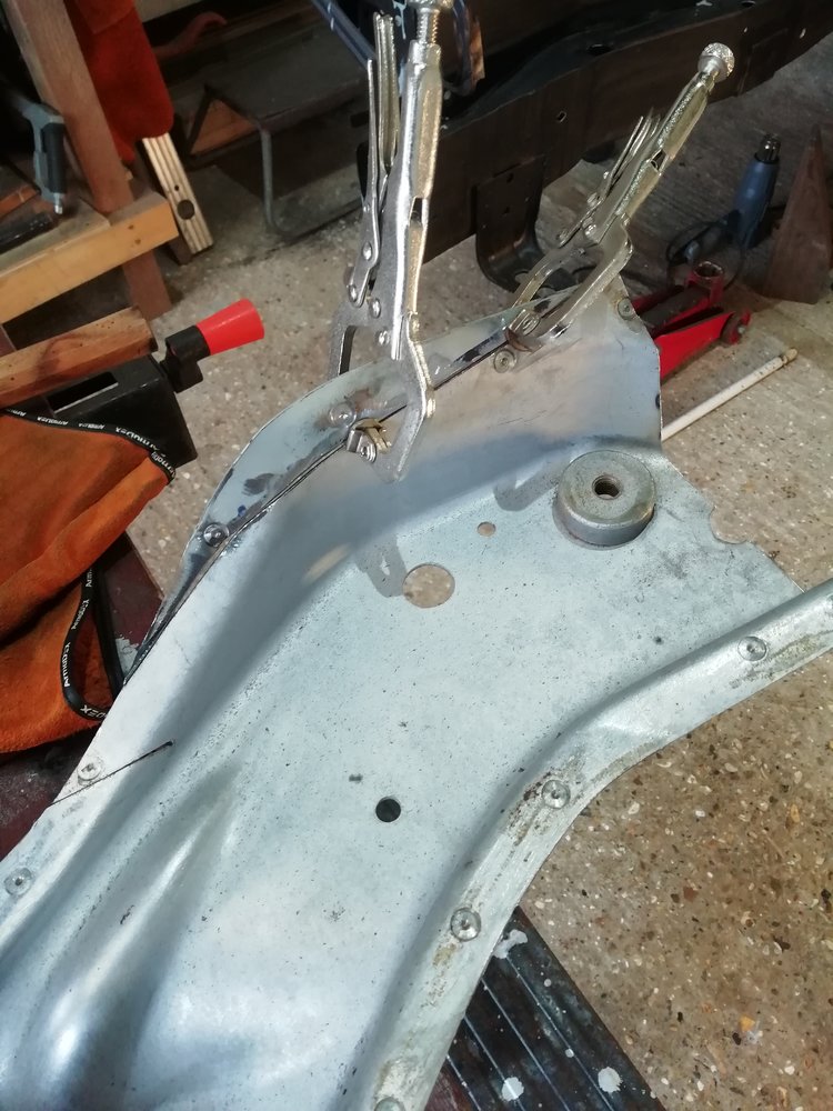

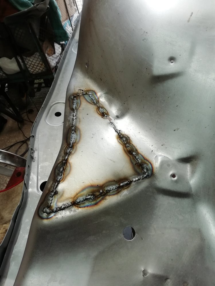

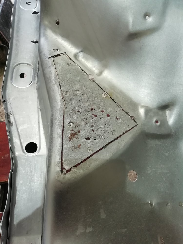

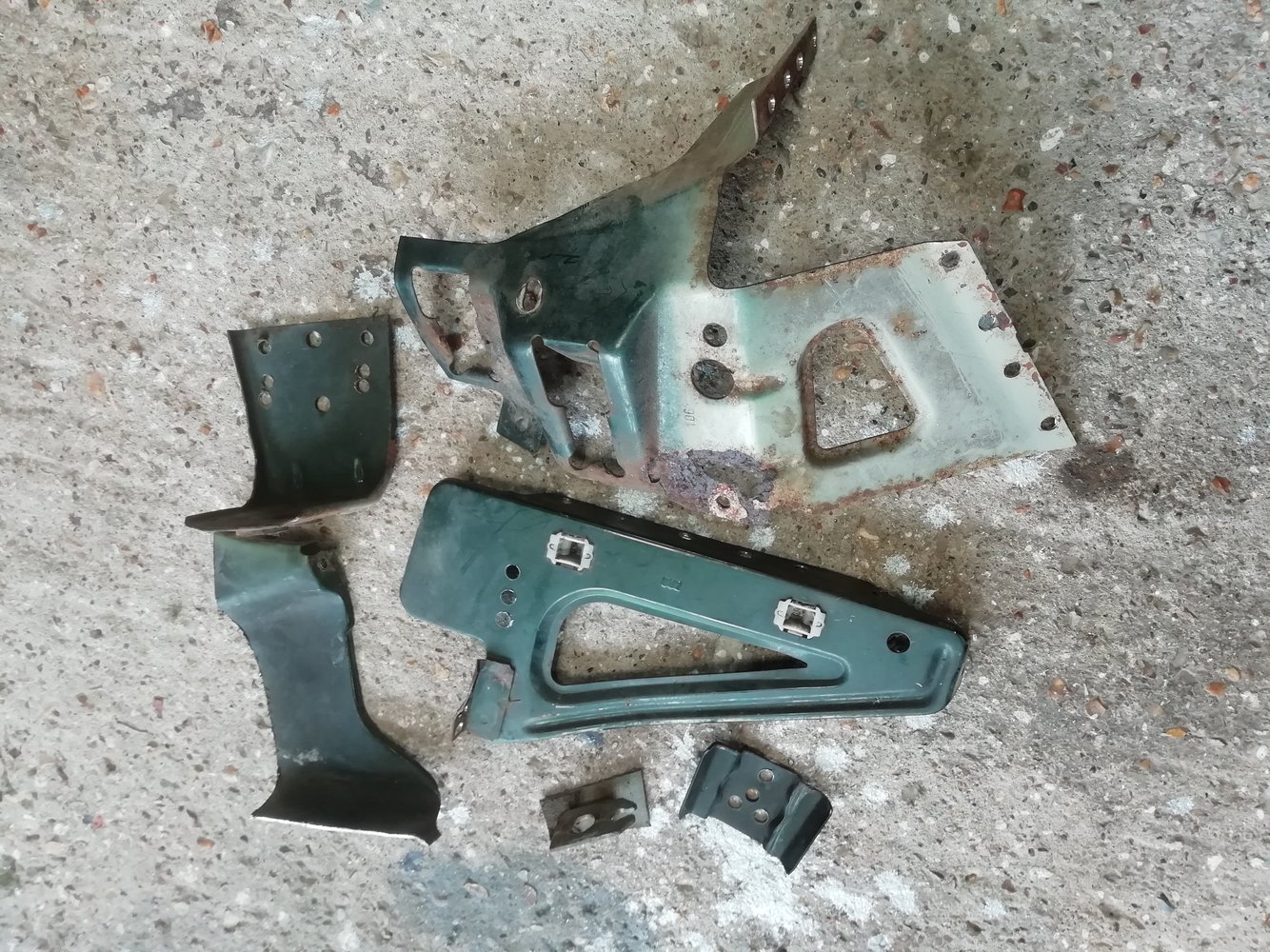

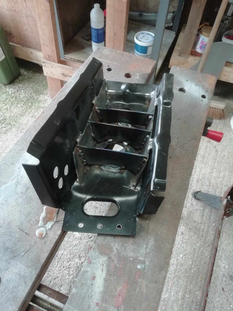

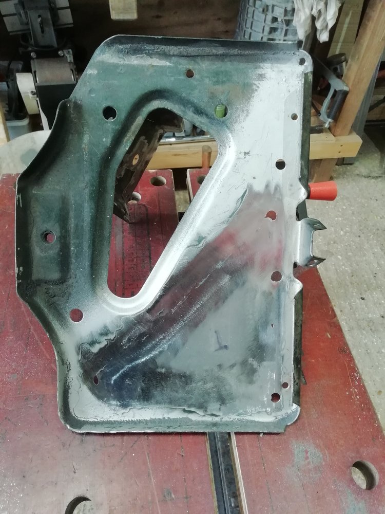

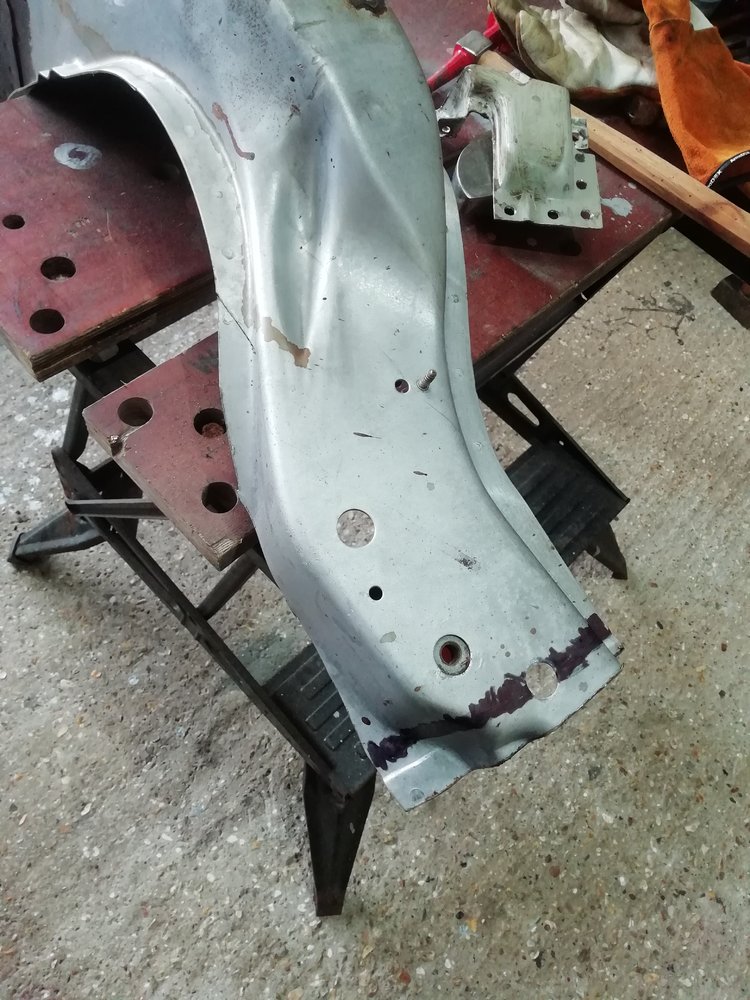

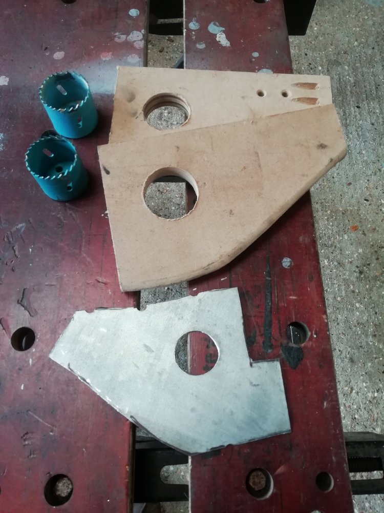

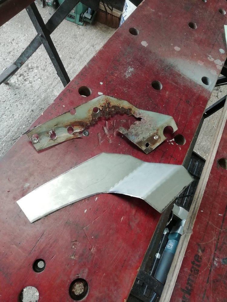

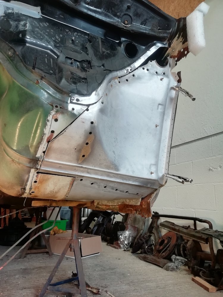

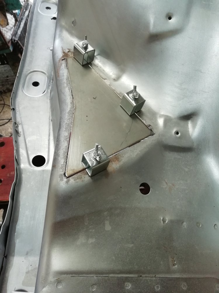

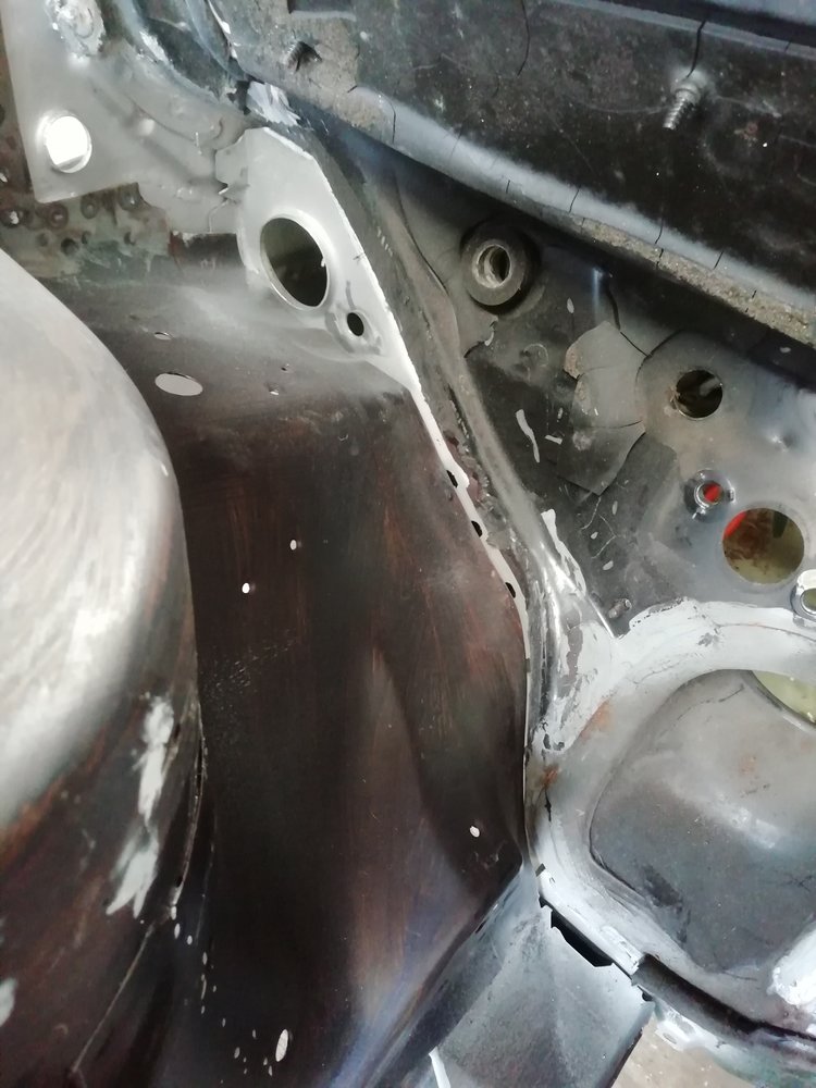

Bit more done, I suppose you call this the outrigger, joins the chassis leg to the bottom of the A post, also part of the jacking point and one of the few new panels it going to get!

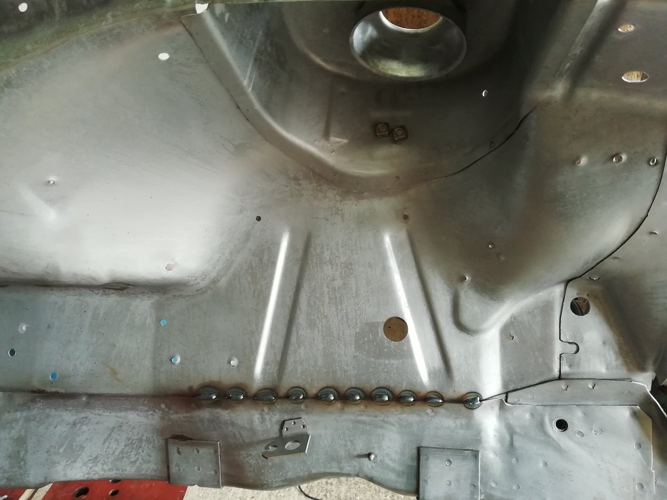

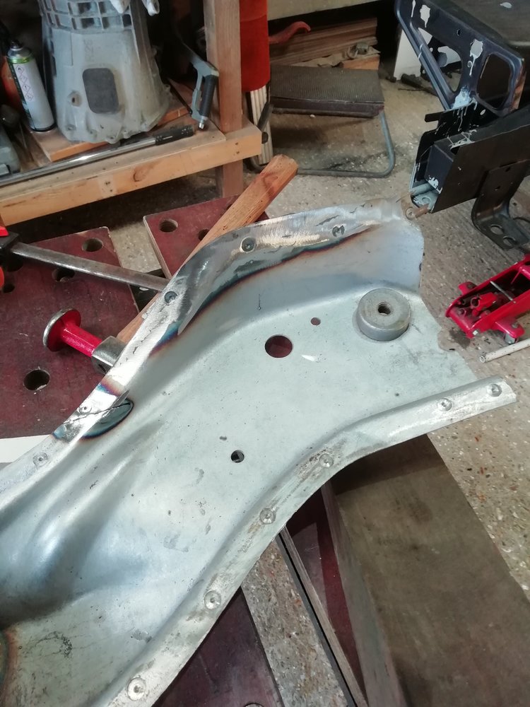

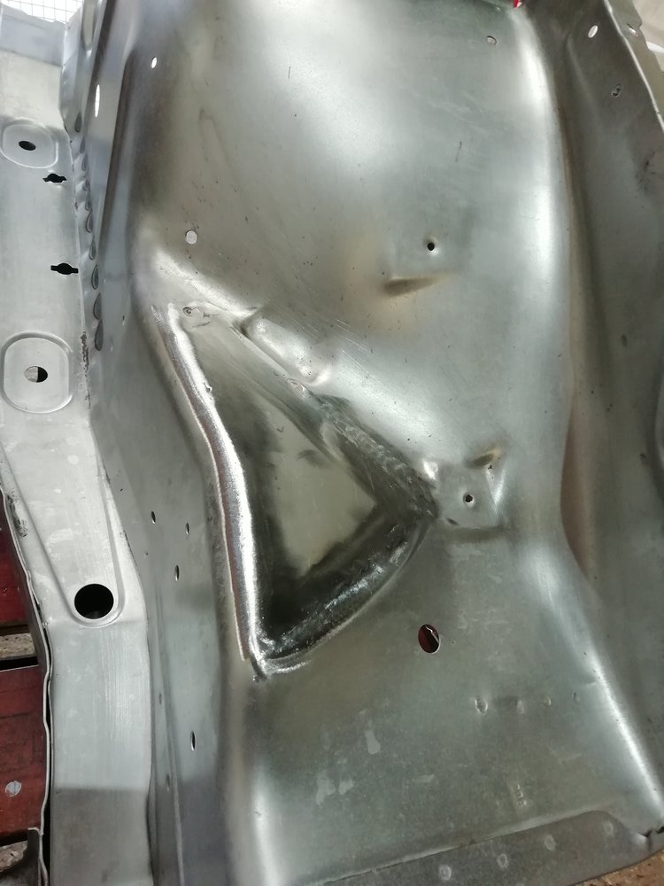

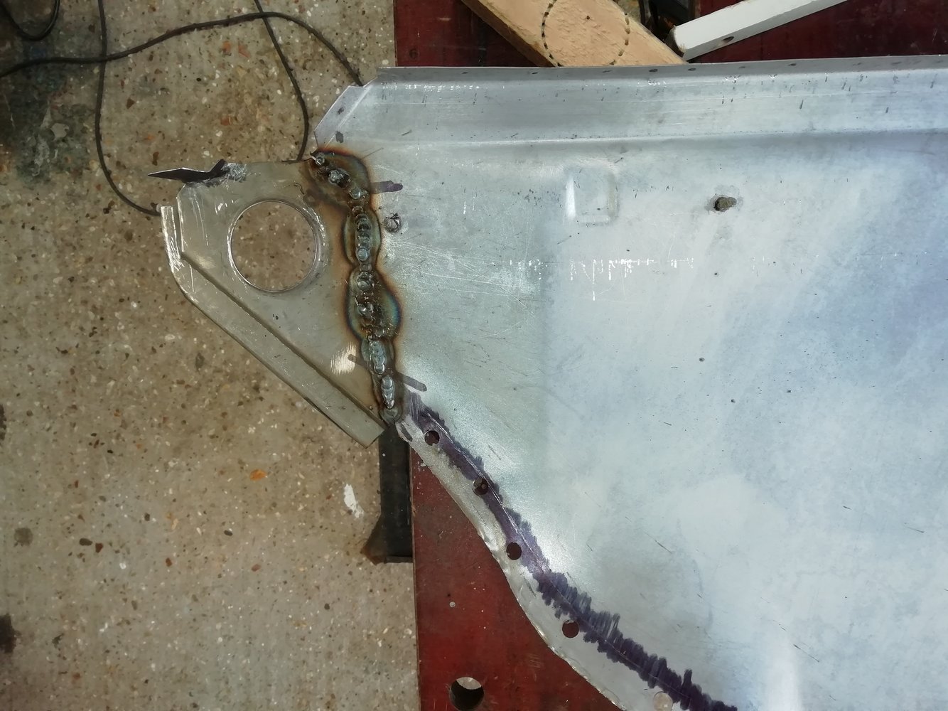

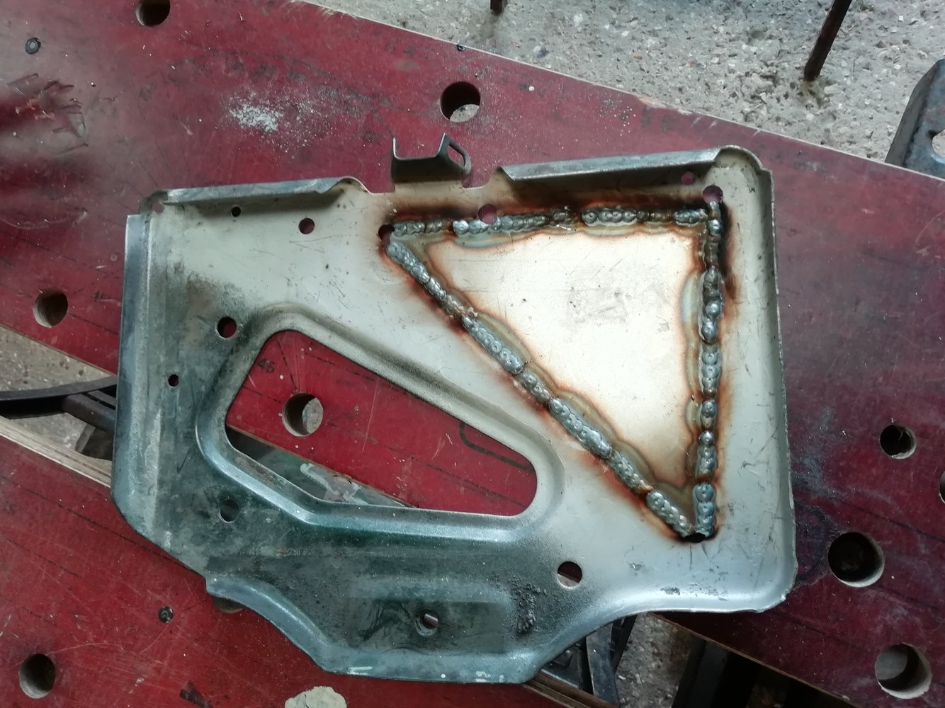

They always get crushed and mullered so a bit of quick and dirty internal reinforcement with some shocking welding

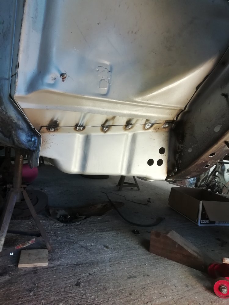

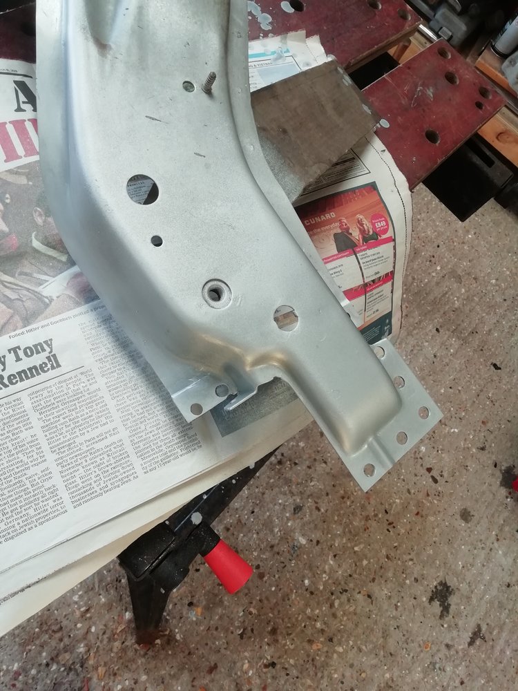

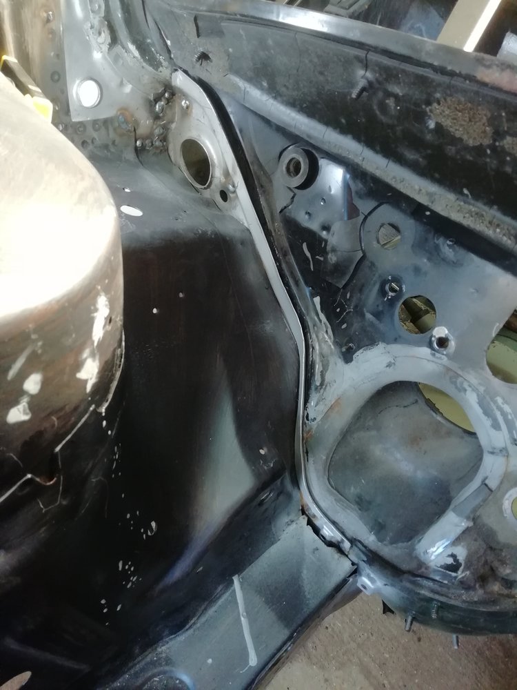

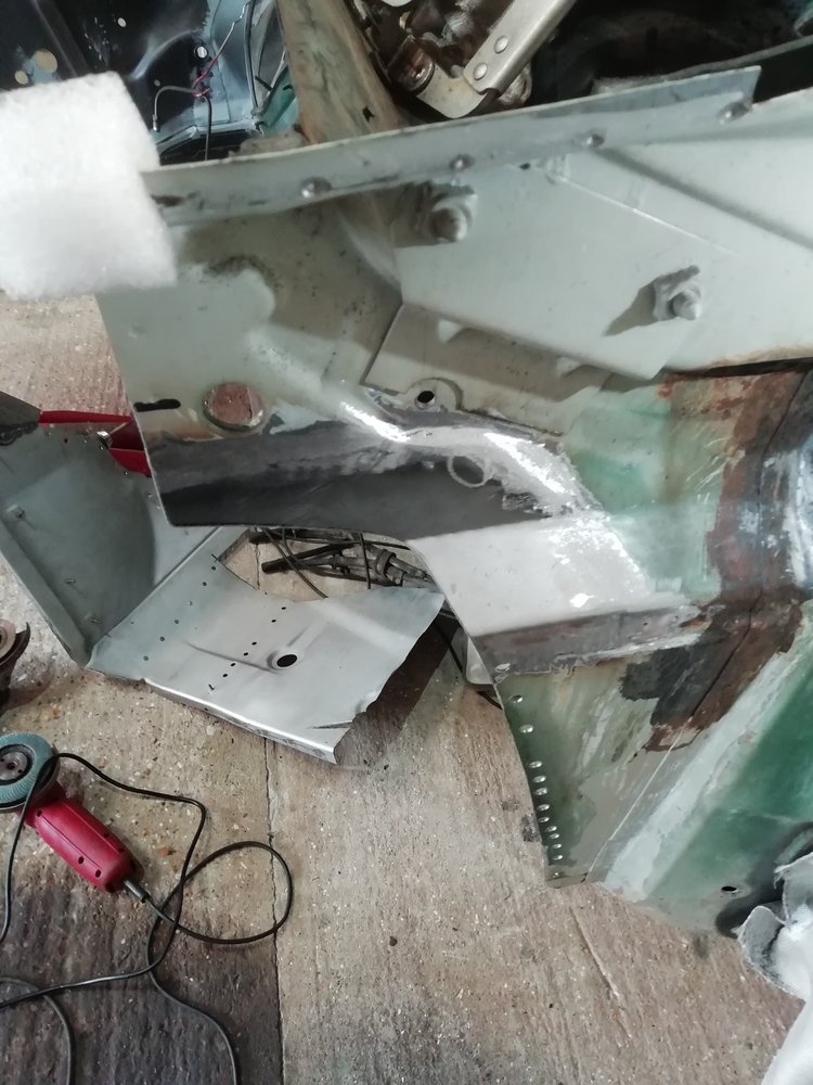

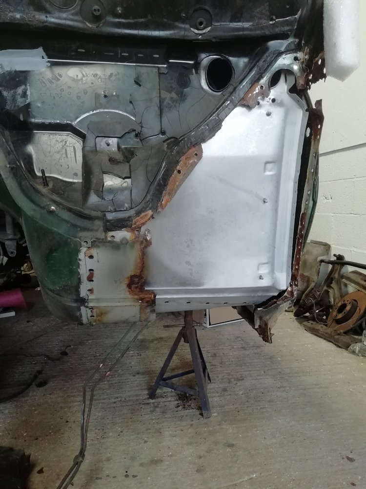

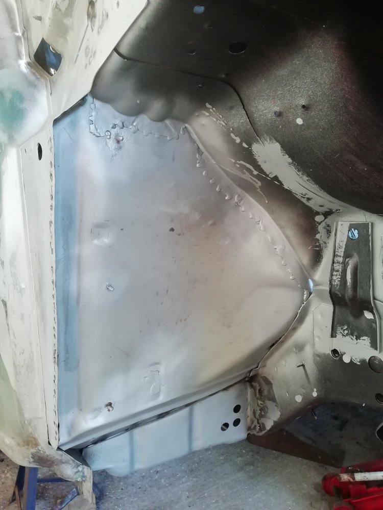

In and welded, looks like im going to have to get busy with the epoxy primer soon
