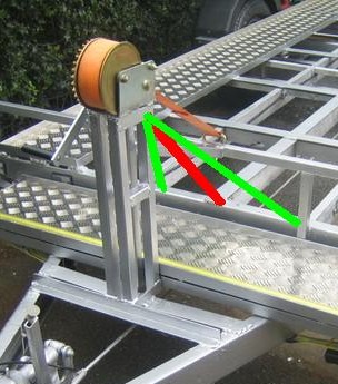

Spray painted 3 coats all the steel after much wire brushing and scrapinglooking good.
Is it galvenised or just painted?

Yea that'll stop the safety catch from moving, just check if theres any wear in the plunger, a quick test we used to do was to hook it up to a motor, and jack up under the A frame to load the coupling, it surprising how many jump off.
there is a rig available for testing which uses a load cell,
Wise decison Your hitch looks as if it might be prone to the same defects mine has I would make it safe ie: tie the release catch up by either drilling or for fast fix tieback or something to stop it releasing that catchwe have a hitch like that one on our little trailer tent
it's from the late 60s so it might the same make ?
and we have been using for most of last summer and this one
i'll have to give it a test before taking it out again as were fond of it and wouldn't like to lose it

With them old hitches as a temp fix hook it up, push the plunger down and catch in, then wrap insulation tape round the catch part to hold it in

as for the coupling on the trailer tent i'll do the jack test on it and if it passes i'll clean it up
if it fails then we'll upgrade.![]()
i like the winch
so much better (& safer) than the cable type
