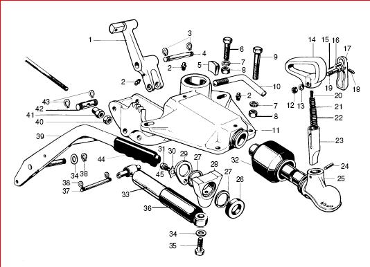

Would this do its on ebay dont know if i have added the link properly but here goes Link is at the topThat was me, in the late 70s I worked for a while as a caravan service engineer, peaks were well known going off on their own, one the problems is with the springs and the catch on the coupling head going rotten, one of the fixes apart from properly repairing the head, was to use a hitchlock that wraps around the handle, and locks it in the down position, alternatively you could replace the hitch with a B&B unit which is what the caravan industry adopted as a replacement, you'll need one of the manual reverse types though not the later auto reverse model. if your interested in more info just ask.
