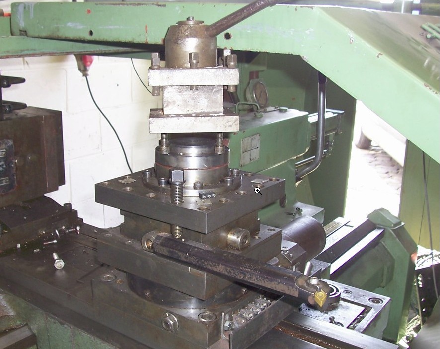

Ha ha that would eat mine and for breakfast and still be hungry.To give you an idea of the bulk of the Computurn here is a pic of the original front 4 way toolpost with a 32mm Dia boring bar in it and the 4 way toolpost from a Colchester Triumph sitting on top.
Bet that's got a nasty bite if things go wrong.
