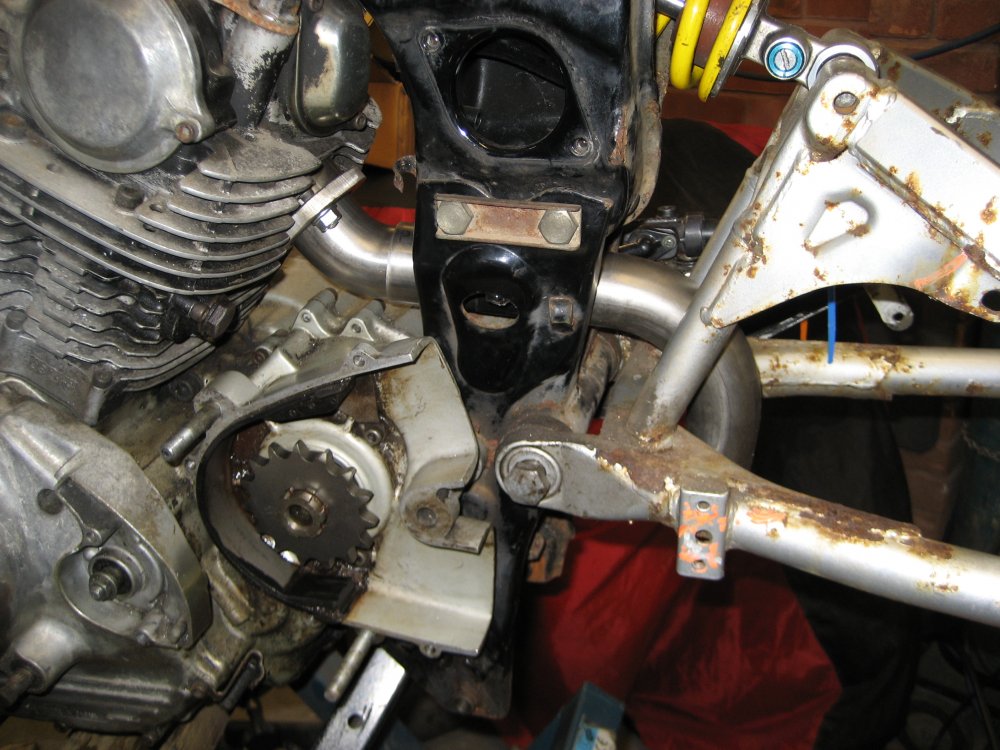

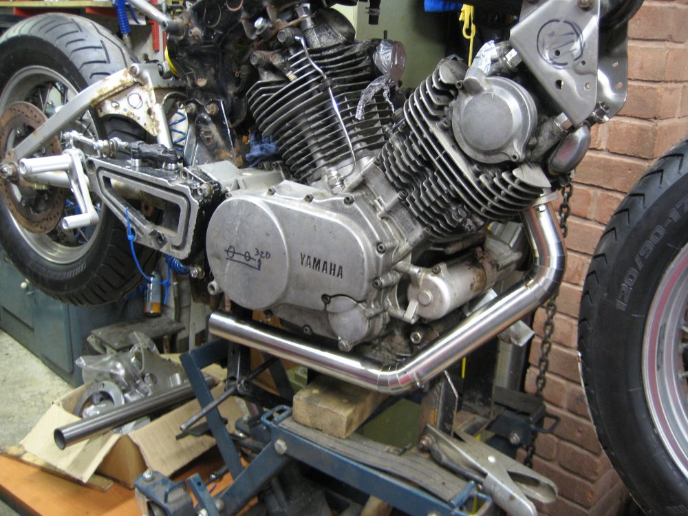

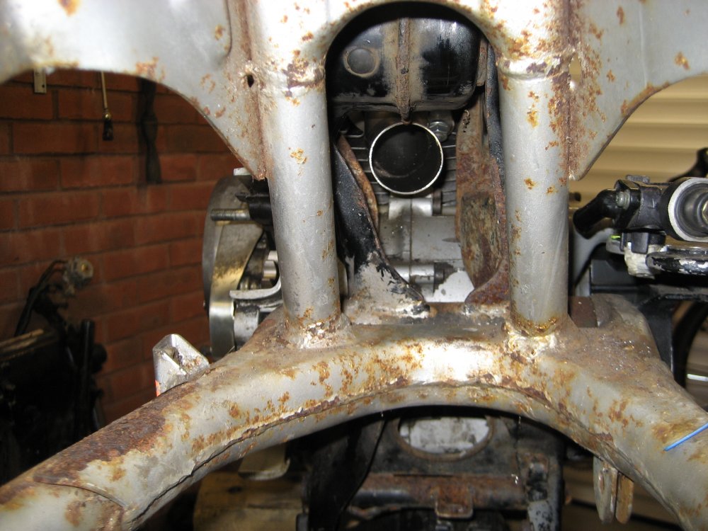

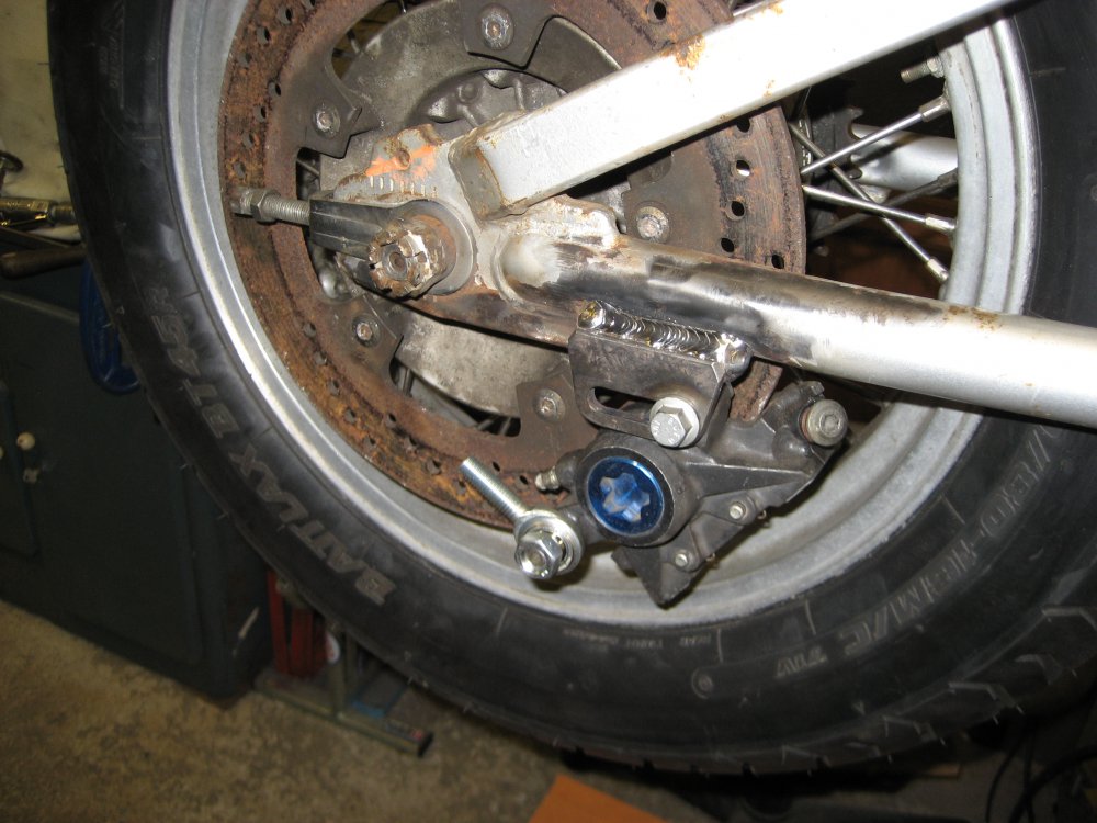

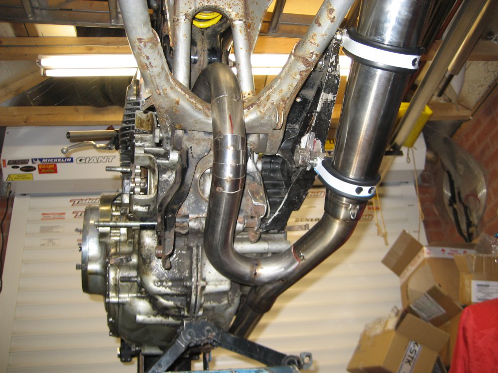

Ouch the motors a mess, Im building a special myself.
Its a 79 husqvarna cr frame with an xt600 motor shoe horned in. Hence the reason for the need of a welder, frame needed to meet mr hacksaw. Now need to meat mr welder. Was going to braze but gas set up to much out lay for the amount I would use.

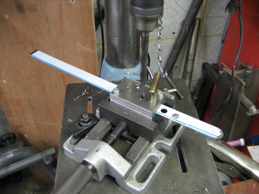

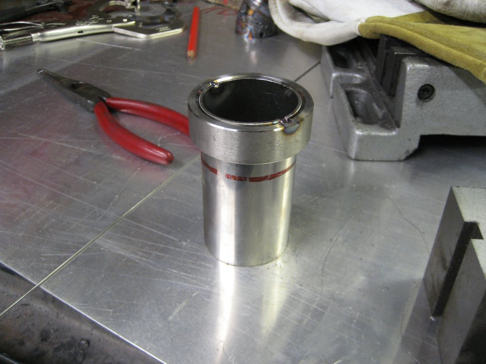

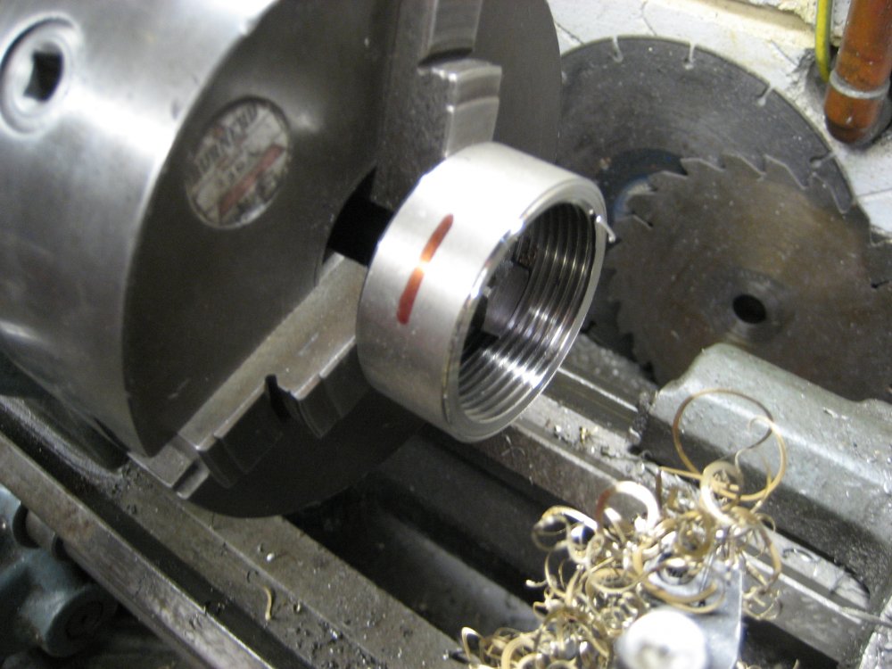

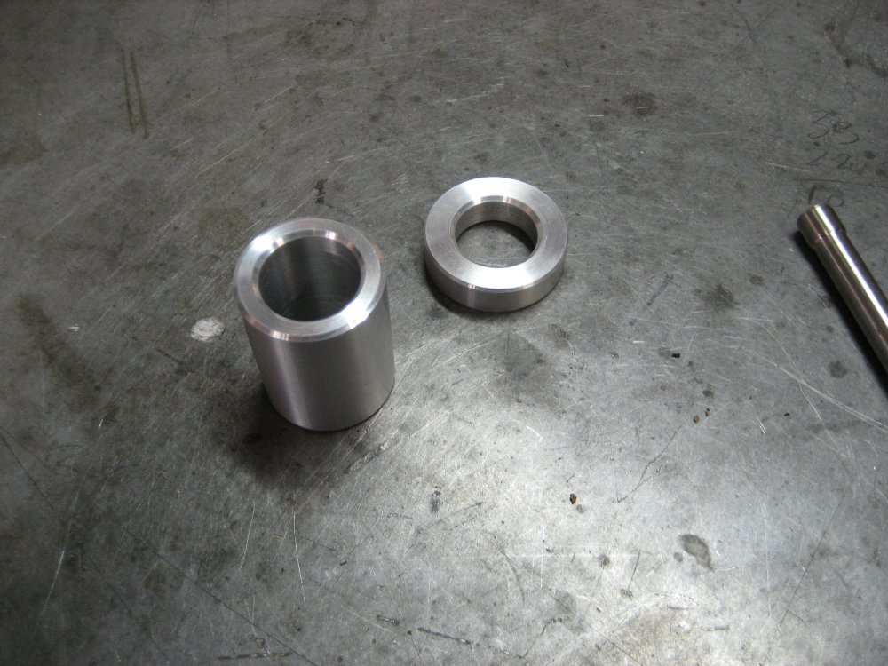

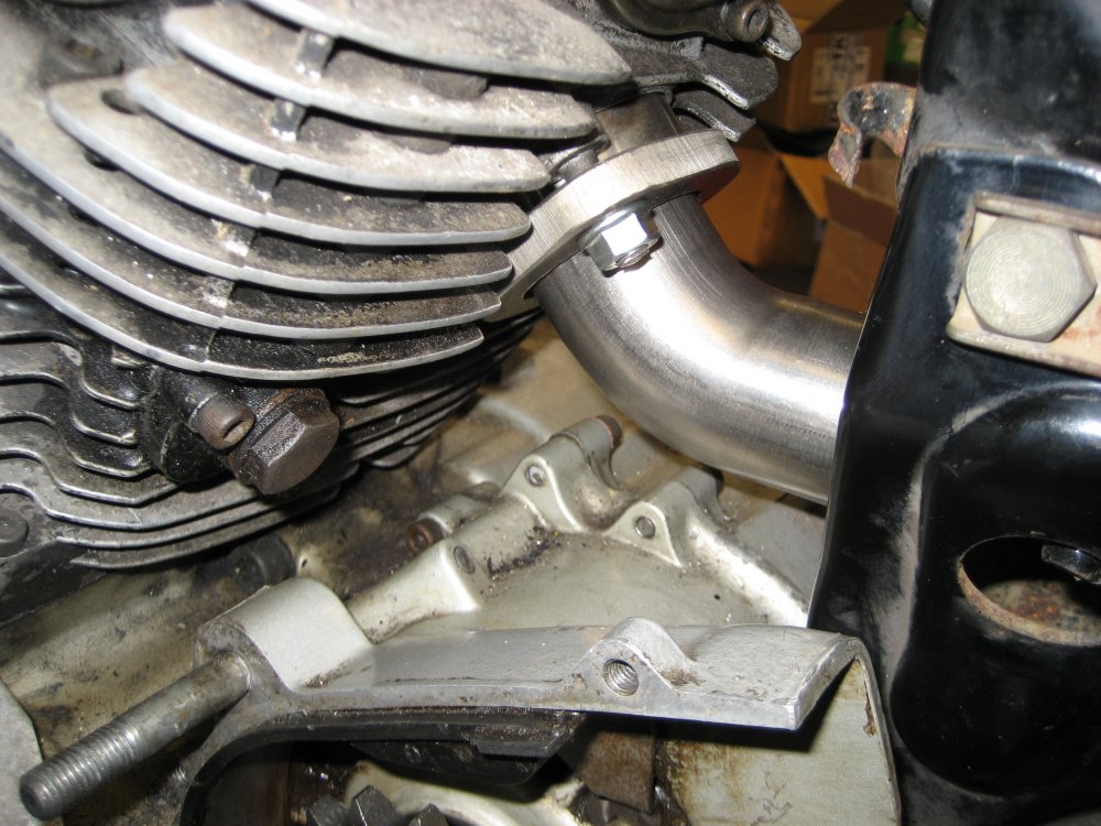

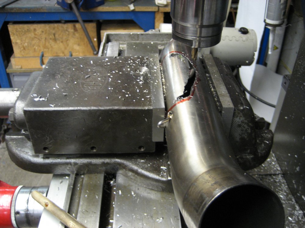

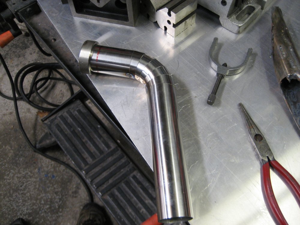

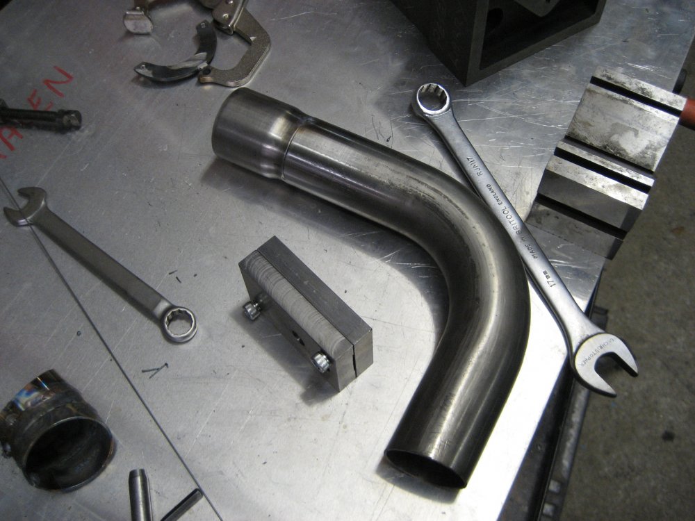

How did you fabricate those neat flanges?
chopped a bit of 10mm stainless plate I had into a squarish shape....bunged them in a four jaw and bored them out, the rest I just scribed, milled the flats the rounded off bits on a linisher...................wish I had a CNC sometimes, but that's like cheating
