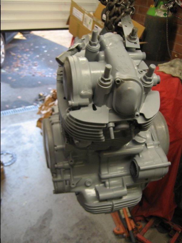

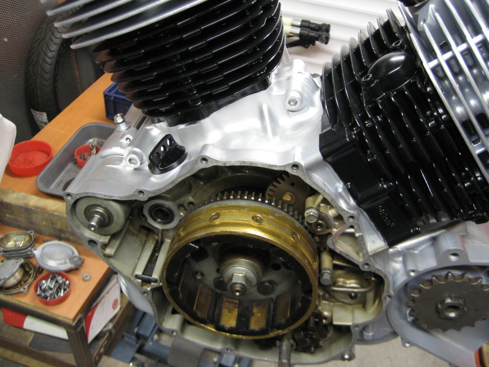

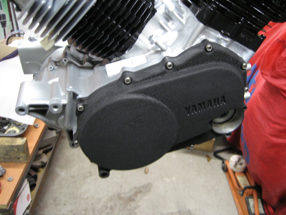

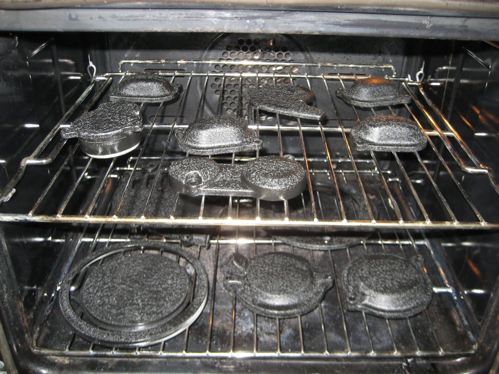

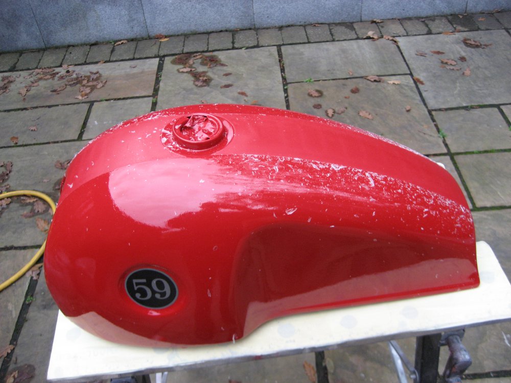

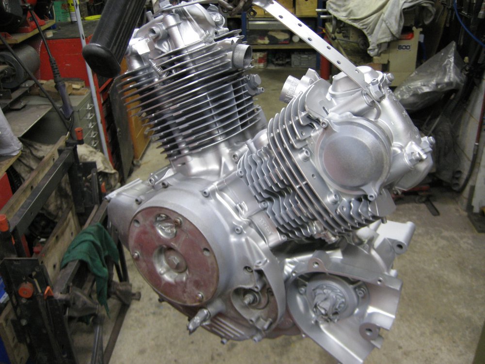

Nice job on the paint finish

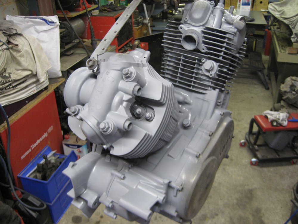

still not sure about the "speed blocks" will have to see how it looks when finished.

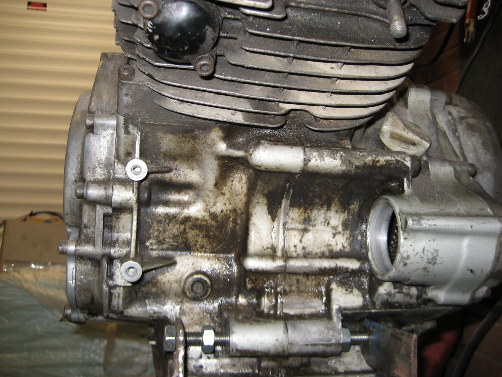

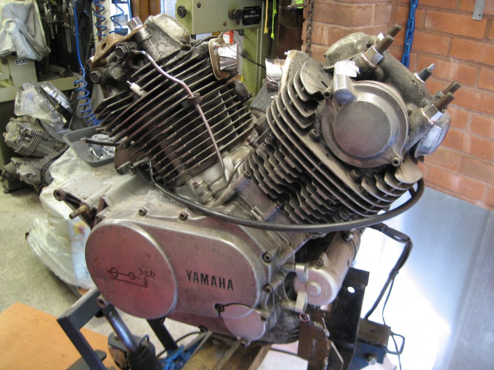

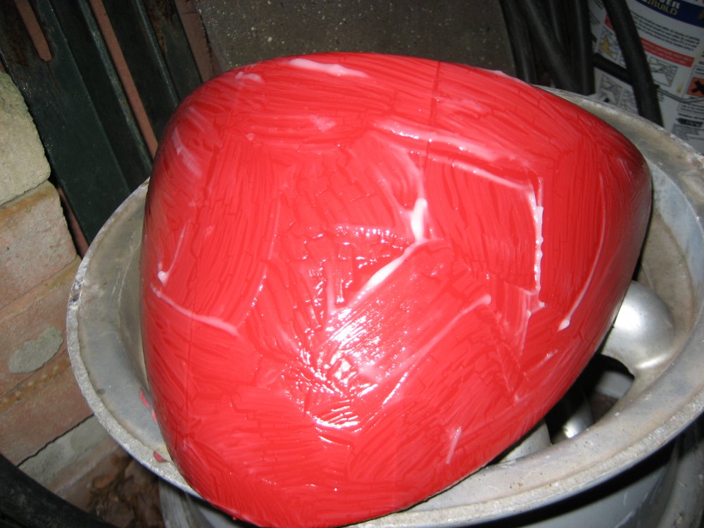

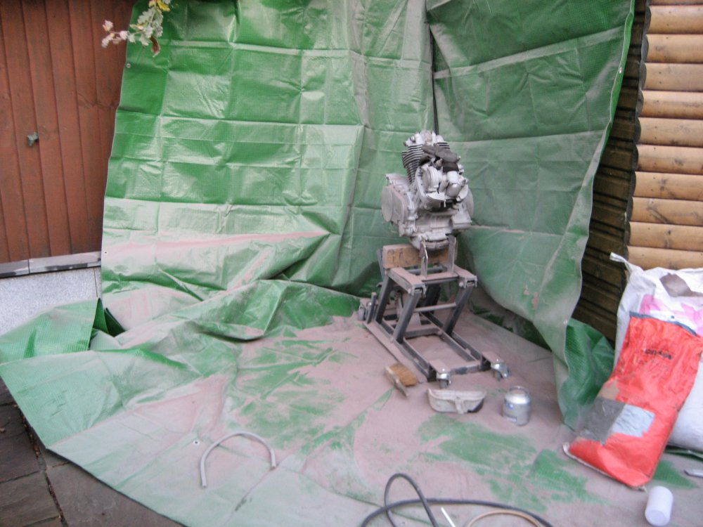

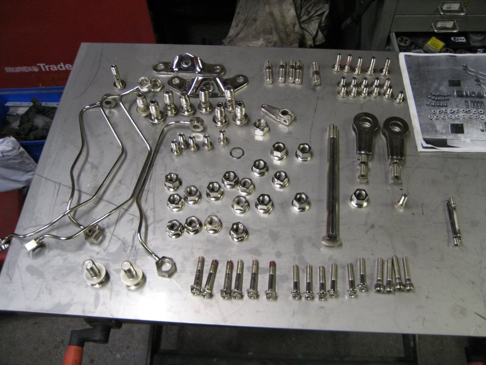

...................never again, what a messy job. I knew it was going to be, that's why I've been putting it off
..............my right glove is now a little bit tight and my finger has got about 5mm wider and thinner..........and there was a little bit of swearing
yeah got some left but won't be putting them on a helmet.............?Do you have any decals left for the helmet?

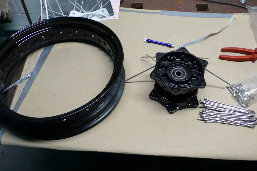

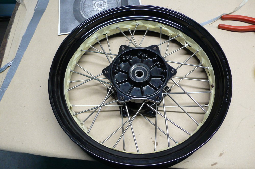

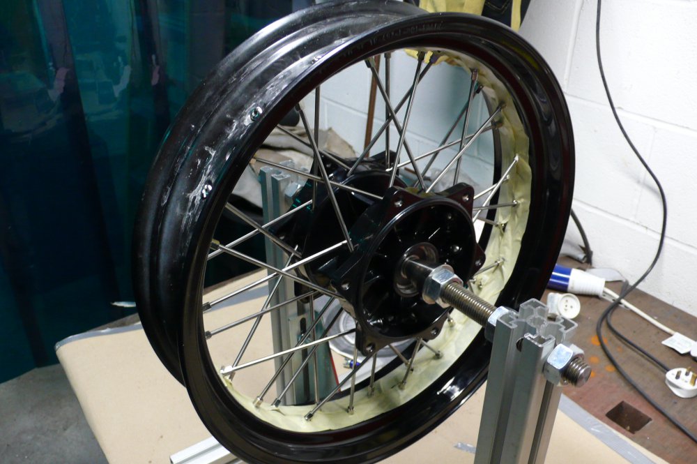

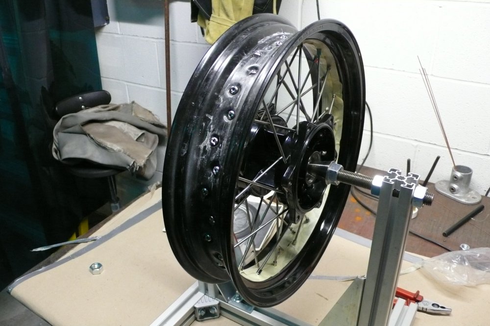

Like the wheels, what tyres are you going for?

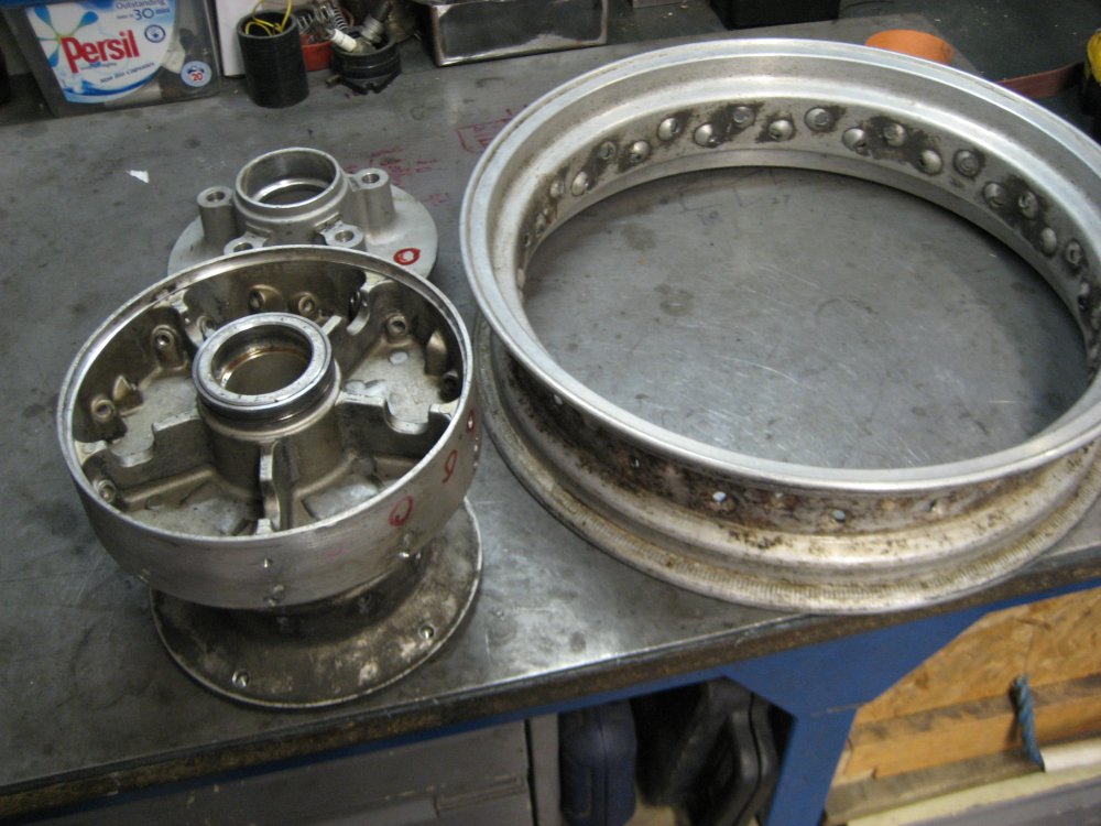

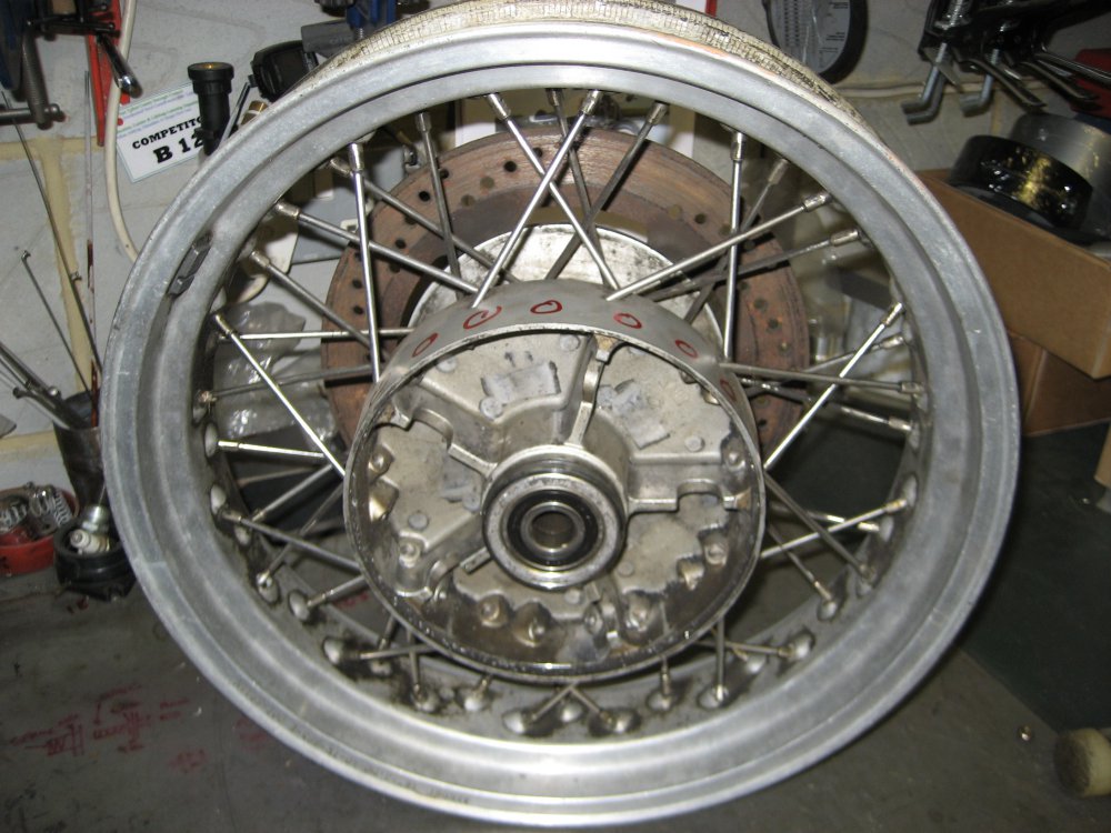

I sometimes wish I had the chain drive 920 as it would be a lot easier than fitting spoked hubs to the shafty!
Still I'm in too deep now......

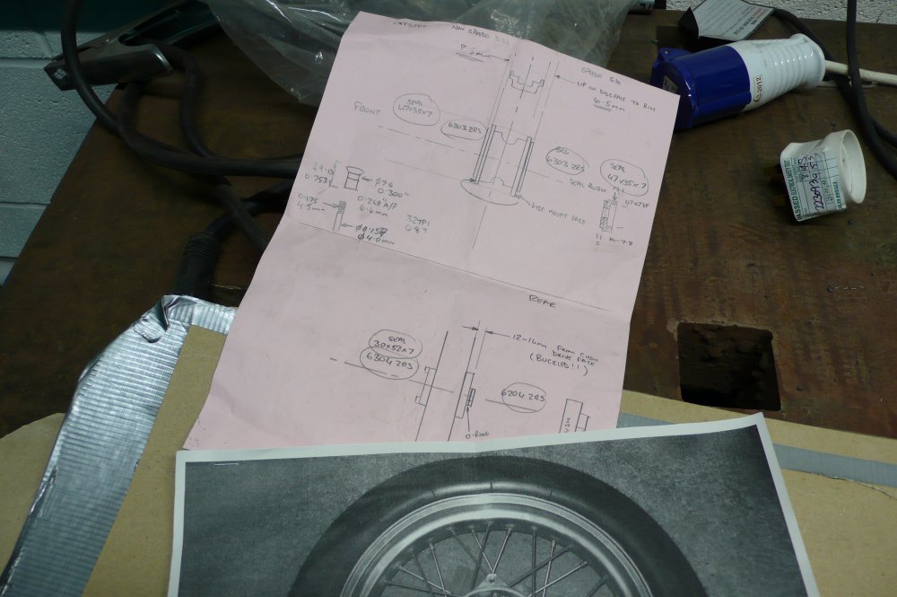

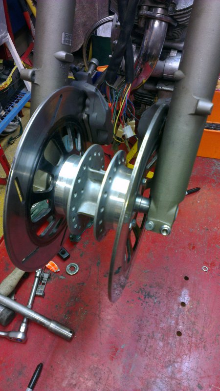

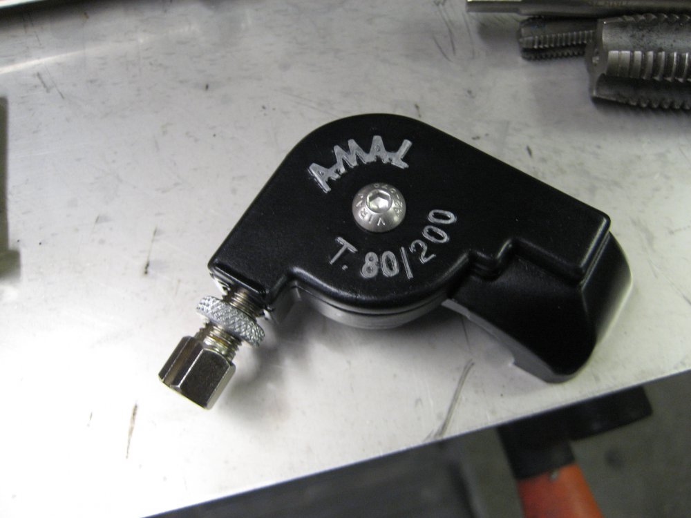

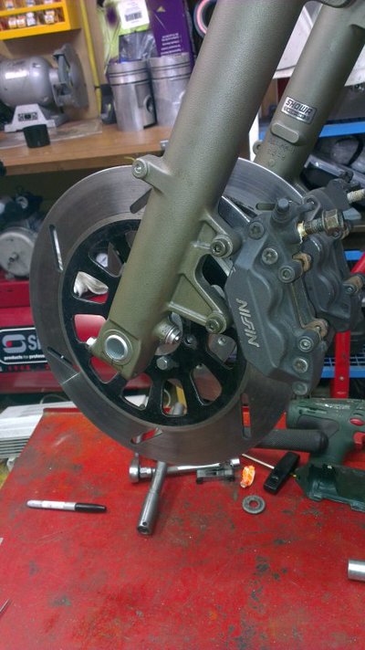

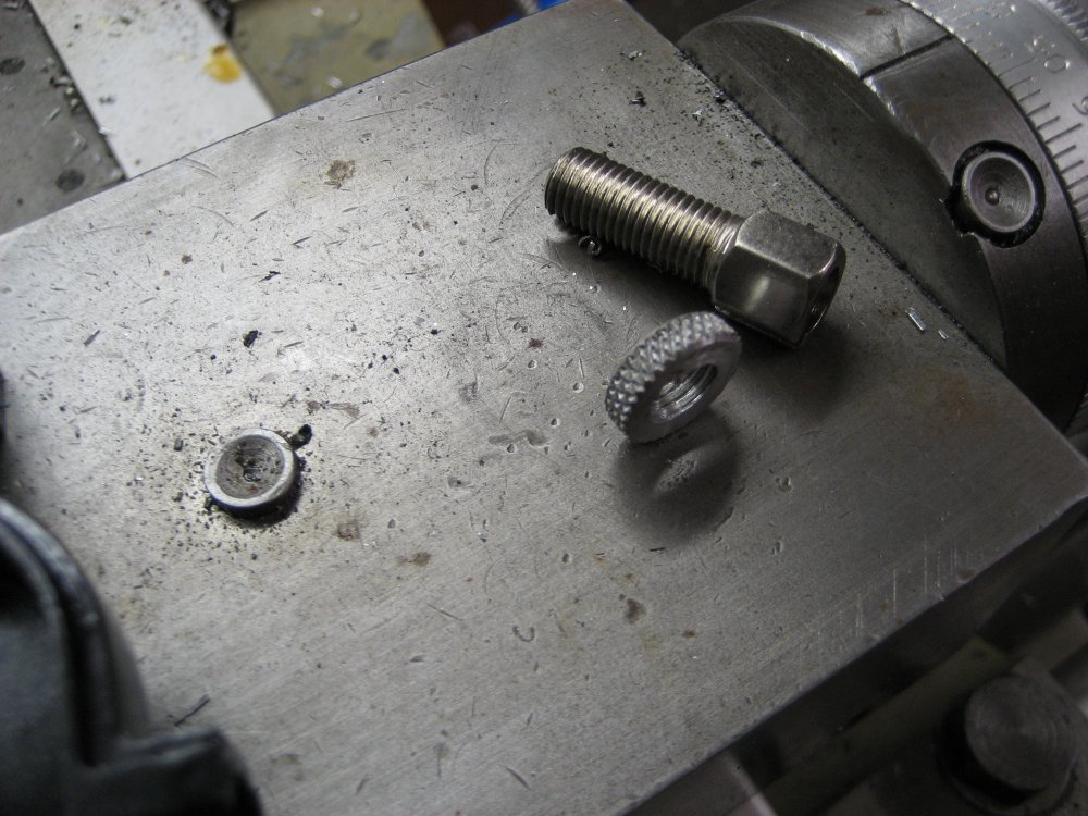

Here's a couple of pic's of the front twin disc hub with my 14mm 7075 spacers.
Took a LONG time to make on the lathe as they were my first real "job" as such.
I need some longer disc bolts now anybody know where to get some?
Your a braver man than me, building spoked wheels has never appealed to me.
Your using r1 forks, can you do me a favour please. Measure from spindle to top of the leg with the bike stood up, i have a little idea brewing.
I remember reading a big debate on bolt spec for discs and what to use and what not to use, sure it was on britchopper forum
