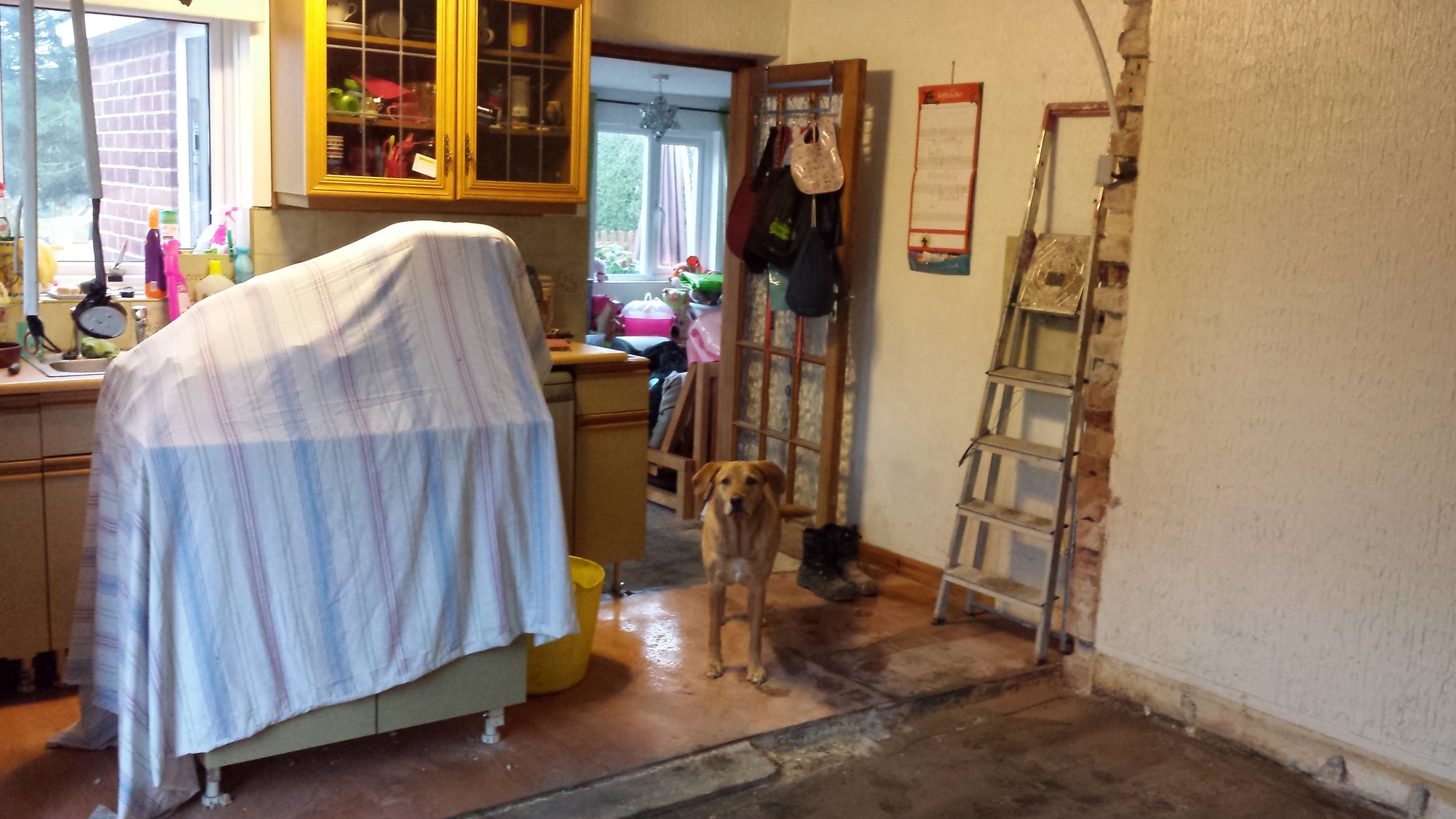

That's how I clocked we had an issue, the carpet and underlay did a great job of suppressing the water coming through, so it took to the walls![]()
I thought I was going mad looking for it. Assume you mean the kitchen cabinet with stuff on top?Is that a lathe in you kitchen @Rig Pig ?![]()
The copper is under the screed in our extension(in that brown fluff plastic backed insulation), Dad put it down in the early 80's my job after the screed was set was to pain white lines on the floor following along the runs, to prevent that very thing happening.Friends bought a new house and builder allowed carpet fitter access before the final exhange of contracts. On getting the keys friend found the house flooded - turned out buiders had burried central heating pipe in the screed and carpet fitter had put a nail into it when fitting the door strips !
