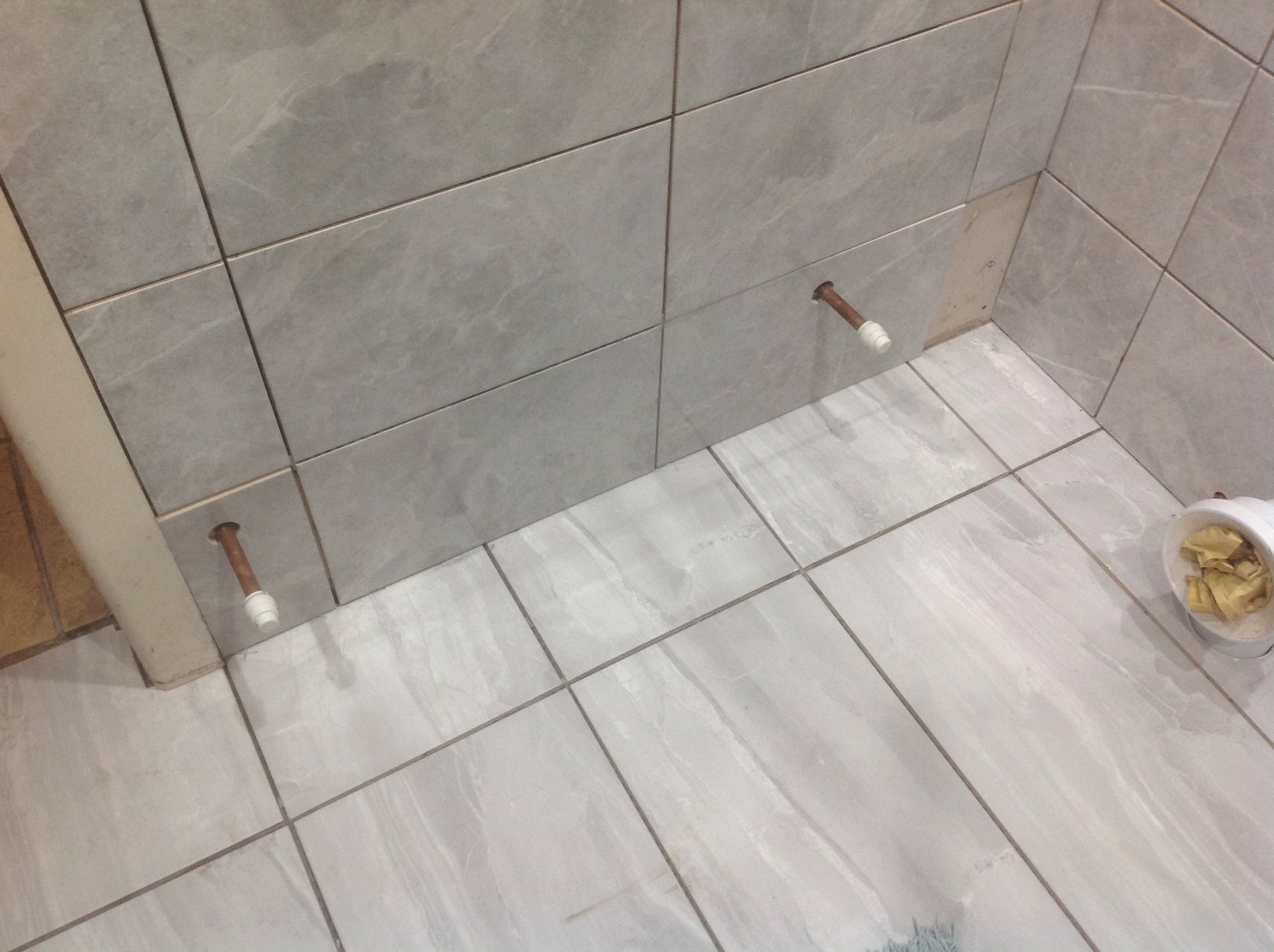

I try never to use copper in floors but if you have to do it use duct tape, I used 2 layers on the last pipe i fitted into concrete, If i was doing it for myself i would use 22mm plastic pipe and put the 15mm in side it.
