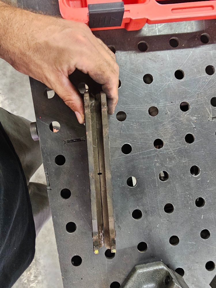

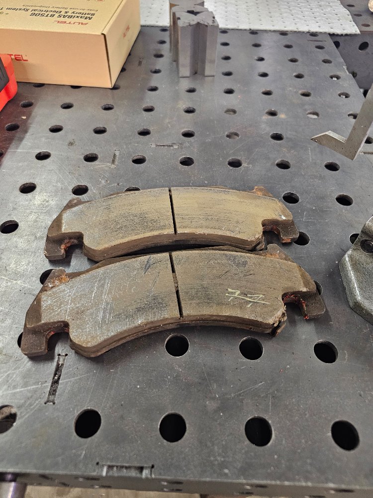

Yep just change out the pads as a first step and recheck.Used pads but still have plenty of life in them.
10 days for the pads to be delivered so have time to pull a caliper apart over the weekend to inspect the seals .Those pads would get you a warning on the UK road worthiness test.

[...] but are worn uneven/tapered, up to 1,5 mm difference. To make matters worse, I didn't put them back in the original position and orientation when reassembling
They shouldn't get any mention on a MOT.Those pads would get you a warning on the UK road worthiness test.

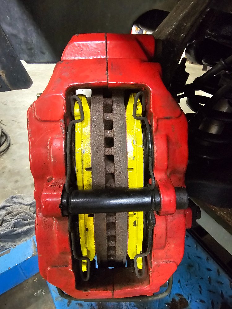

Have you bedded them in?New pads are in but no improvement.

I haven't, car is still on the lift, don't see how that would help with a soft pedal?Have you bedded them in?

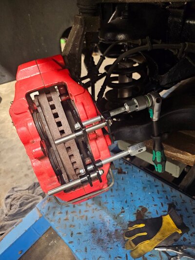

Thinking locigally (as far as i can :-) ) there must be something wrong with both front calipers, when i clamp of both flexi hoses to the front calipers the pedal is firm as it should be. If I release either one of the clamps, the pedal goes soft.I'd still want to check/replace the seals. Bigg Red might be worth checking out to see if they do a kit.
You've got new pads on old discs. They need to wear slightly so that they make firm and even contact with the uneven disc surface to give the correct piston travel.I haven't, car is still on the lift, don't see how that would help with a soft pedal?

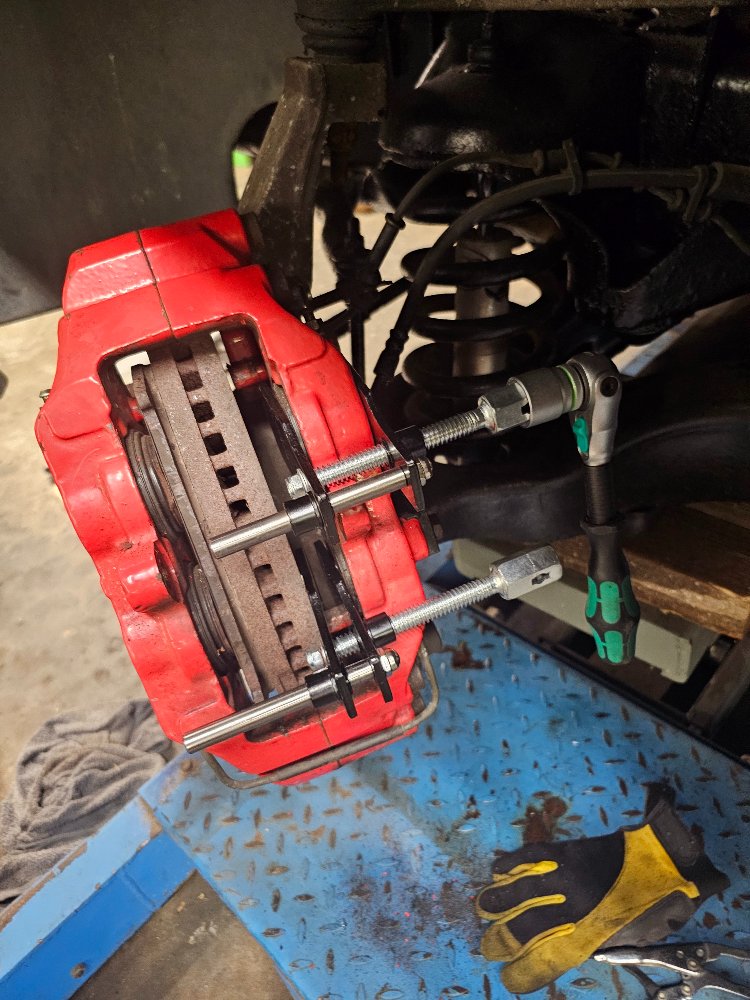

I don't know if it has been asked before (apologies if it has) but, does the pedal become firm if you pump it a couple of times? If it does, then that would point to excess travel somewhere in the calipers (the sort of thing you used to get when your rear brake shoes were worn and pulling the handbrake on a couple of clicks helped?), if not then it would appear that , somehow, air is still your enemy.Clamp the pistons in the calipers with g clamps. That will tell you if it's a trapped air problem or a piston movement problem.
Makes senseYou've got new pads on old discs. They need to wear slightly so that they make firm and even contact with the uneven disc surface to give the correct piston travel.
Will try, good tipClamp the pistons in the calipers with g clamps. That will tell you if it's a trapped air problem or a piston movement problem.
Well i either get it sorted or i'm burning the thing to the groundI don't know if it has been asked before (apologies if it has) but, does the pedal become firm if you pump it a couple of times? If it does, then that would point to excess travel somewhere in the calipers (the sort of thing you used to get when your rear brake shoes were worn and pulling the handbrake on a couple of clicks helped?), if not then it would appear that , somehow, air is still your enemy.
I really hope you get this sorted.
Oem phenolic pistons and seals. Have rebuilt these calipers in the past without issue, no idea what i could've done wrong this time around.When you (or someone) did the caliper refurb were the seals and or pistons oem or quality brand? .....it's not unusual for aftermarket stuff to be a lottery

The other tip is to take one pad out from one side and with assistant putting one or two strokes in the pedal observe how each piston reacts - repeat for all pads and see if there are differences..... Its possible that seals twisted or slightly tore when the pistons were reinserted - especially if the replacements are not quite the right size. When levering pistons back into calipers I mostly clamp off the flexis and open the bleed nipples so as not to force any air back up the line
