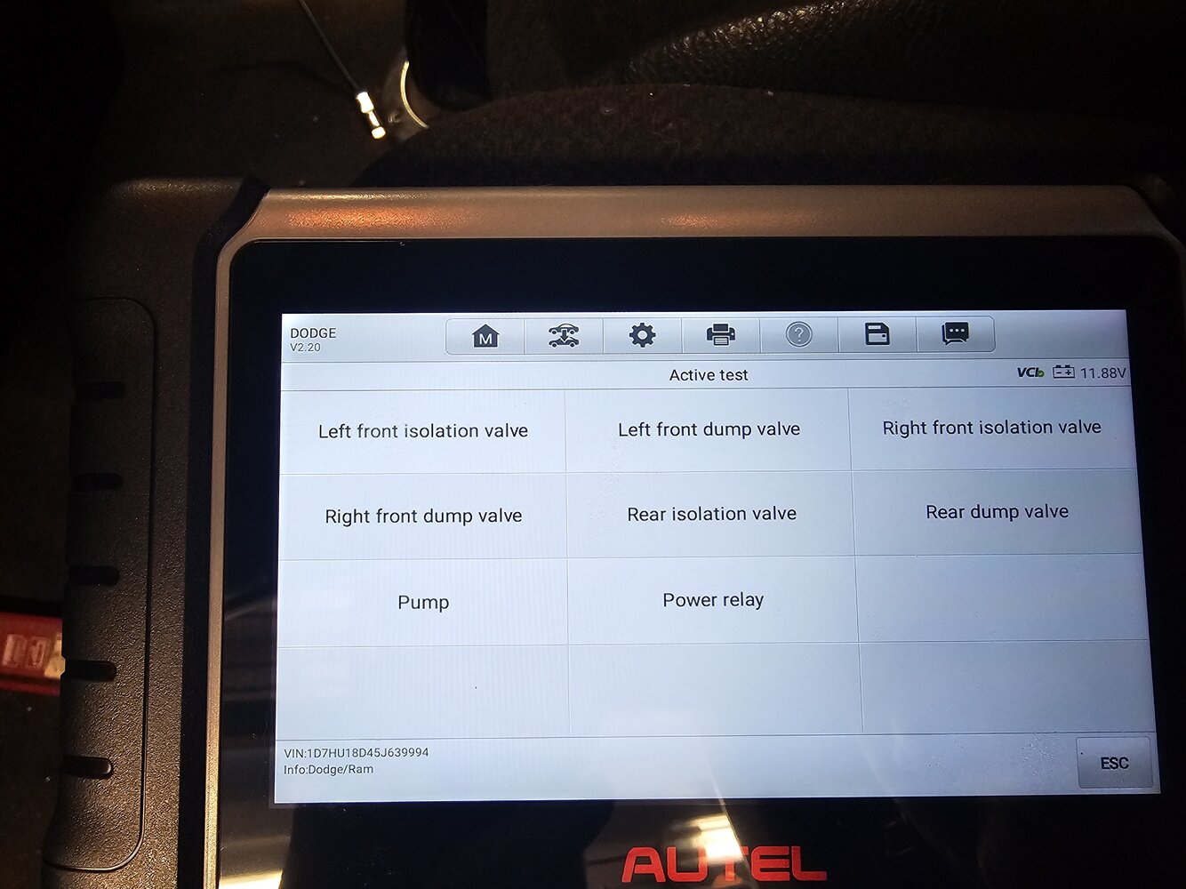

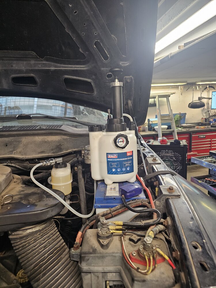

, when i do the brake bleed procedure the feeling in the pedal is exactly the same as when the engine is running. With the engine off the pedal is firm, with the engine running it's soft and goes to the floor. If I do the brake bleed procedure with the scan tool (key on, engine off), the pedal is firm until the ABS pump is activated and then it goes to the floor, the exact same way as when the engine is running.
