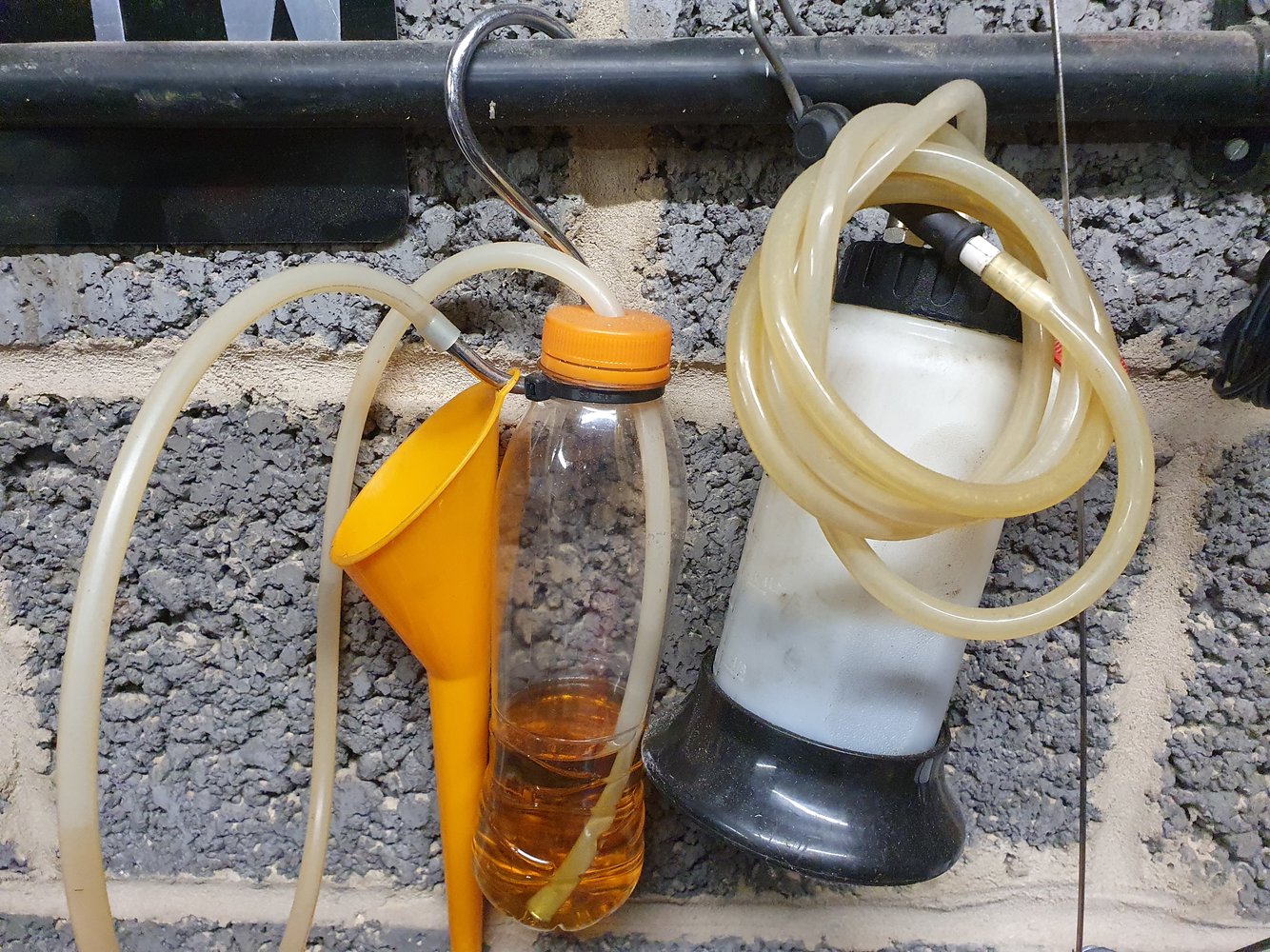

I bought a gunsons brake bleeder a few years ago, then realised that I just need to connect an airline to an old master cylinder top and turn the air pressure down, as the brake fluid reservoirs on my cars are pretty large. as long as you have fluid in the reservoir there isnt a problem.
