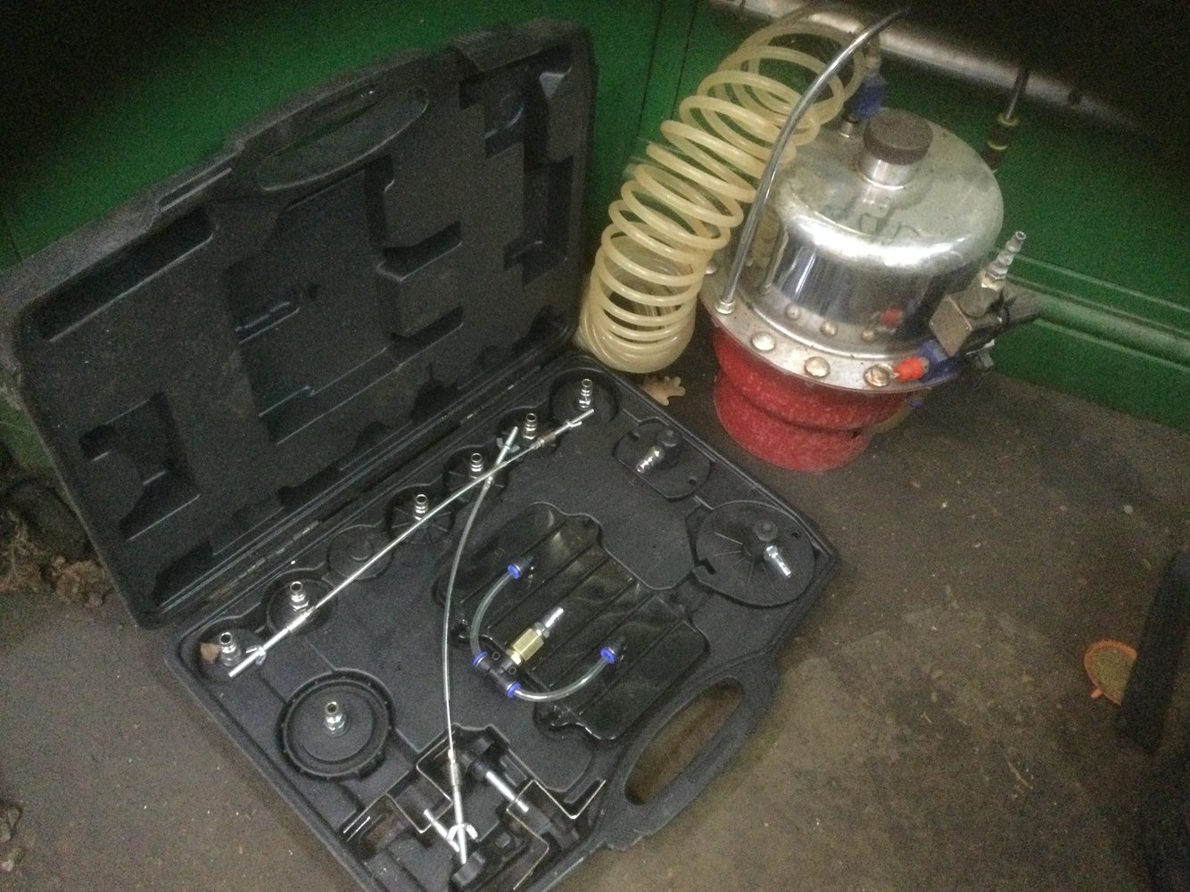

the prob with the master clinders OF all types they get a slight lip inside from wear, thats cos the piston always stops in the same place...hence the lip....
only push 1/2 waydown....it still works....
I was in the bush Africa...we had a 4x4that would not bleed,clutch....
I used a cleaned out pump oil can from the nipple.....got us home OK....
never had the need for any press/vac bleeder....in 50 years...
