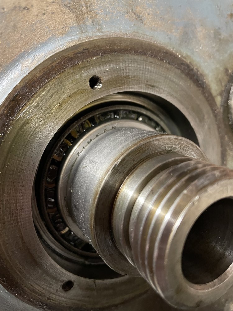

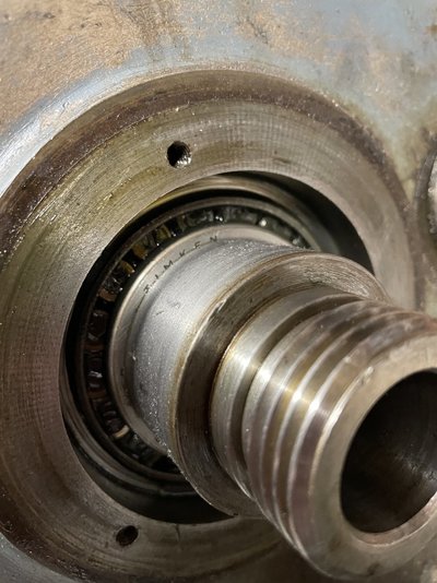

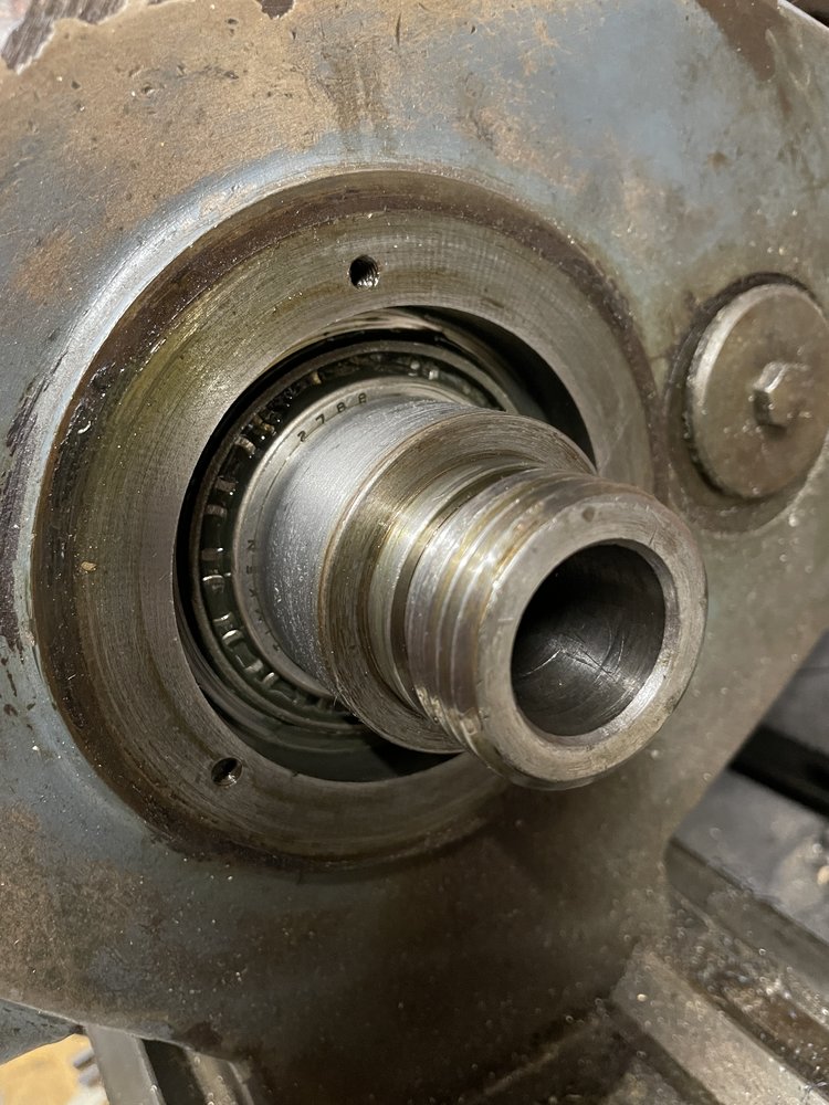

You can't put CV grease in there.As above and graphite ( CV joint ) grease for the bearings.
I had couldn't find 1.5hp motors so have 2hp 3 phase motors via vfd's on both boxfords.
This.You can't put CV grease in there.
You need a spindle grease.
These are timken taper rollers, not constant velocity joints in a rubber boot.
This.
CV joint grease is typically Molybdenum grease, not graphite. Regardless both are pretty rubbish for rotating bearings, as their main application is for sliding joints.
Apologies for my input. I have used cv grease for most greasing applications for donkeys without any problems, but I do stand corrected as I see I should be using bearing grease on boxford bearings.You can't put CV grease in there.

Kluber Isoflex NBU 15 - 50g
