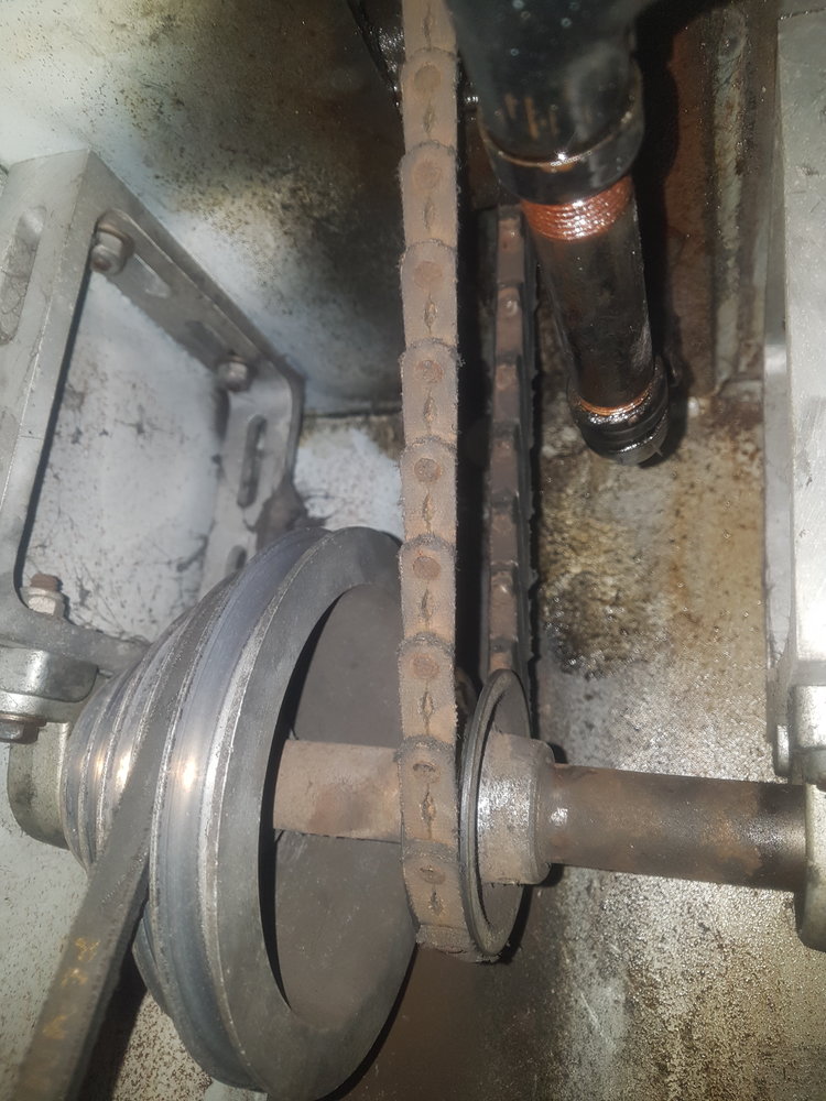

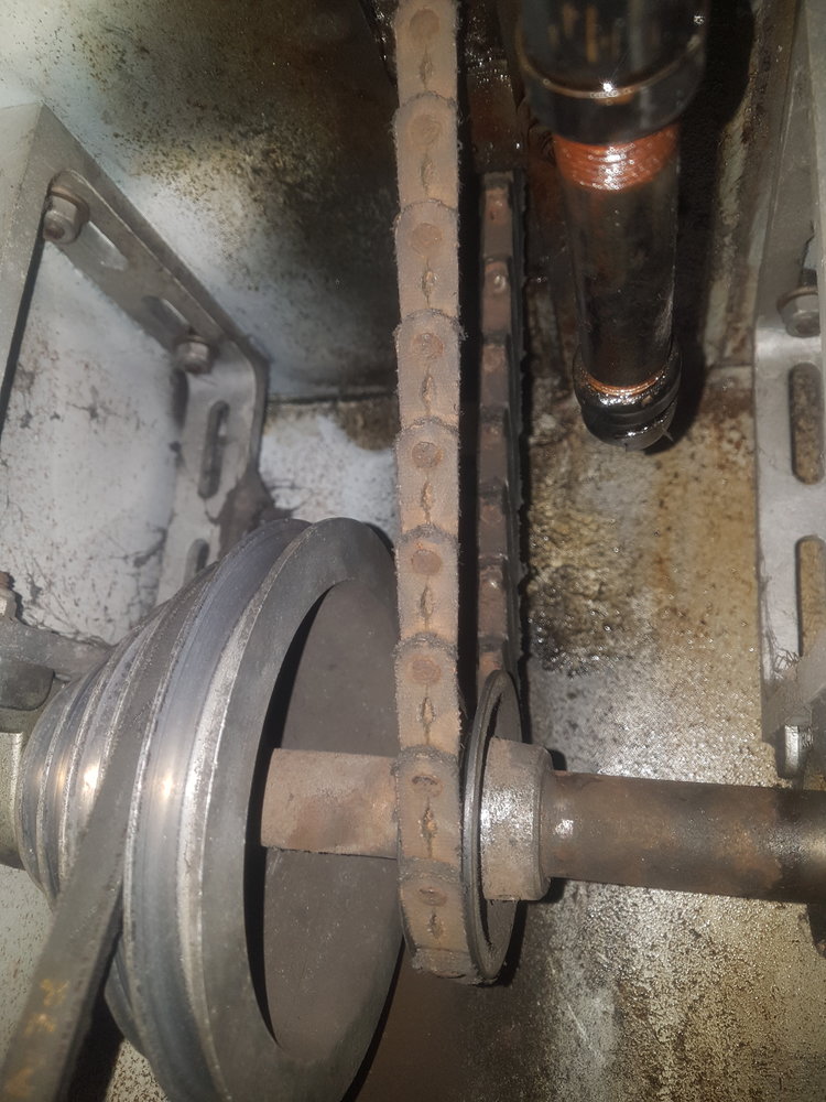

Update on my belt drive issues.
As previously mentioned, I purchased a new length of belt for the lathe over 5 weeks ago.
Today I finally managed to find time to fit it. I initially made it the same length as the old one. Ended up removing 5 links on the new one to start with. Ran the lathe and cracked on with a job I'd been planning on doing a while back - 35mm ID hole in 60mm OD round 120mm long. After boring the hole out I then managed to remove another 3 links in the belt and it's nice and tight now.
