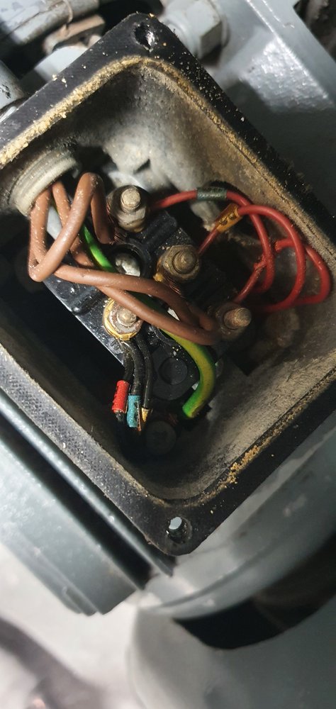

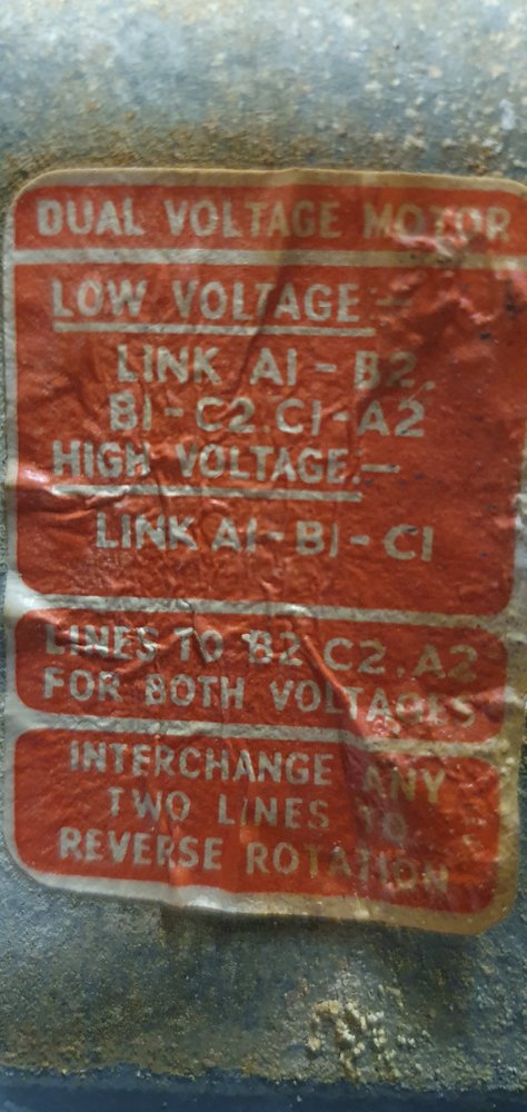

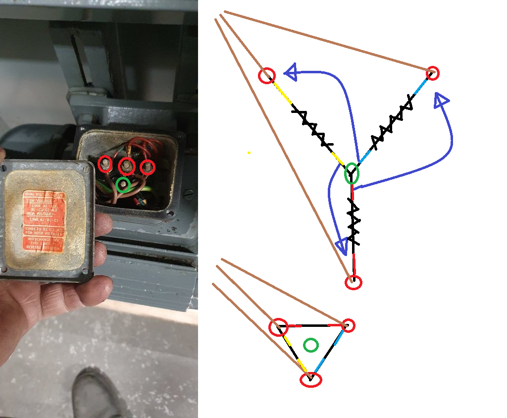

ThankyouTo disagree with @hermetic I think it's wired star at the moment as that looks like the star point is brought to a single post.
Using the wonders of MSPaint for a second I've highlighted the post I think is the star point in green (looks like the three black wires with red, blue and yellow tags on go to it) and three other posts which the red wires go to and they then have the 3 brown wires off to the contactor/control. If I'm right you need to leave the brown and red wires alone and move the three black wires so they are on the same posts as the red and brown. It looks like the red wires are also tagged in which case it should be as easy as just ensuring you don't "match" the tags, ie yellow to blue, blue to red, red to yellow. If the motor then goes the wrong way round swap two of the brown cables.
Of course I could be making this all up and I'm totally wrong.![]()

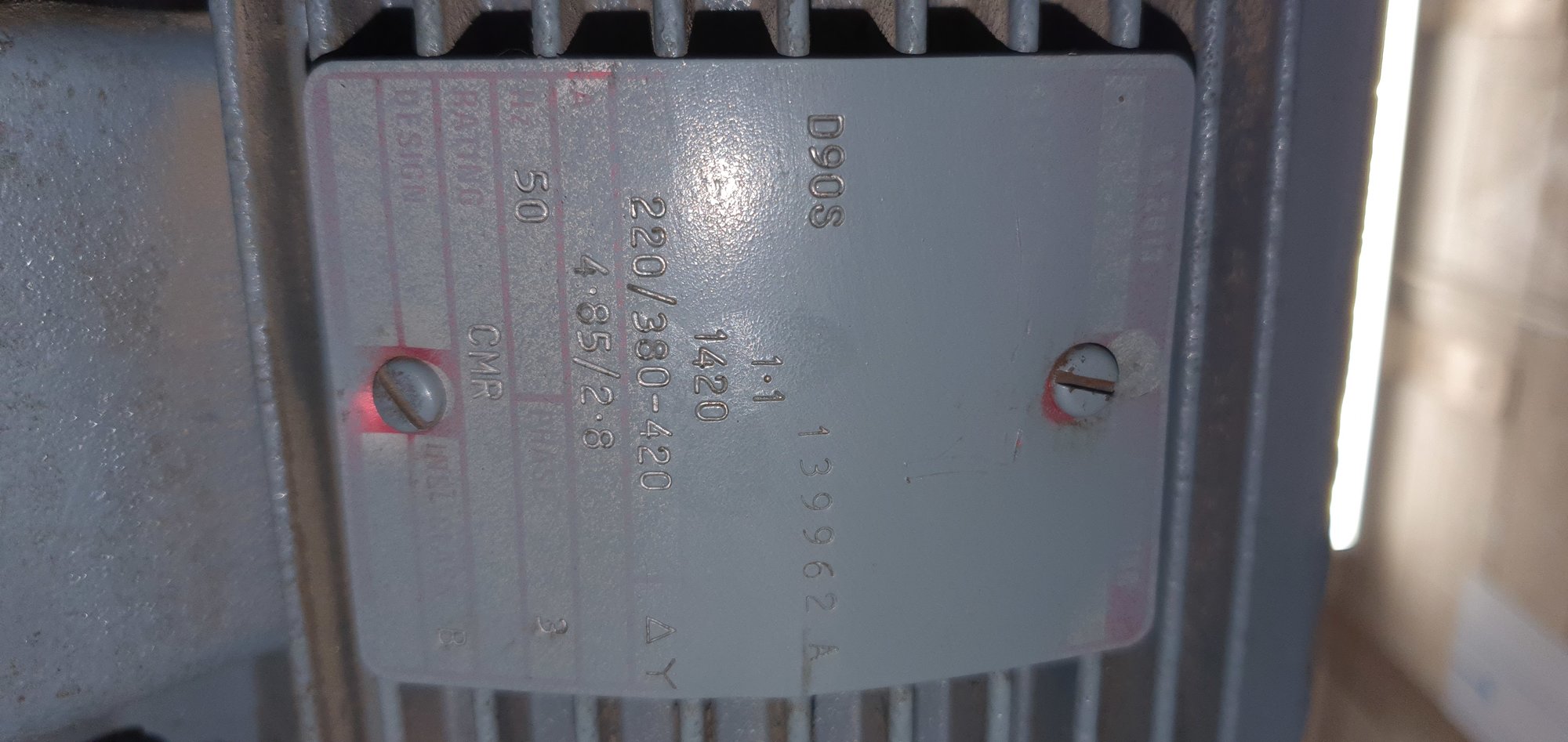

Better photos of the motor plate, wiring terminals and that label on the inside of the junction box and we should be able to help you sort it all out.

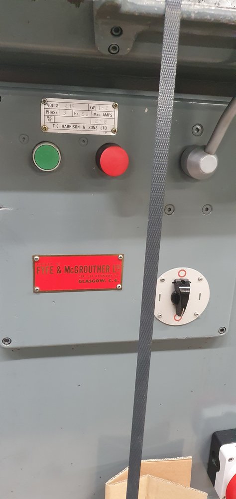

I note there is also a forward/reverse lever on the front as well, if you're using a VFD then you can't use that as it stands. There should be nothing (apart from cable obviously) between the VFD and motor.
Personally I would take that front panel off, mount the VFD within the base (if it's anything like mine I would rig up a shield of some kind to ensure no oil drips in, it's not a lot but there are a few drops) and wire up that lever to the low voltage wiring on the VFD to actually control it. That way it will look and function exactly the same as the original but with the advantage of a VFD.
Yes, I have looked again, and at the new pics, and I am pretty sure you are right, I had assumed (bad idea, never do it!) that the three browns were the other ends of the windings whereas they are actually the incoming phases! It makes sense that it was connected in star, as most three phase(415V) motors are. Where 110v is the commmon single phase voltage 240v is three phase between phases voltage, and a motor connected in delta runs on it, as there is only one winding between each phase, In star, there are two windings between each phase so the motor takes twice the voltage. This is a simplification of the situation, electrical pedants need not comment;-)To disagree with @hermetic I think it's wired star at the moment as that looks like the star point is brought to a single post.

Its currently wired for 415V in high voltage configuration wired in star and with high voltage (star) and low voltage (delta) instructions on the motor. It's going to be.Take a photo of the data plate on the motor to see if it has 240v listed
