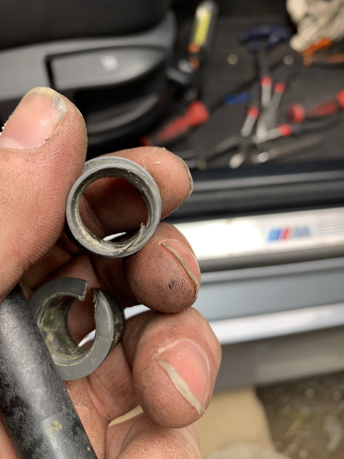

It drives without issue and everything works. The only fly in the ointment was a low clutch pedal which most of the time inhibited starting as the clutch switch wasn’t being made unless you lifted the pedal first.
That turned out to be worn plastic bushes on the pedal pin (also plastic!!!). The repair cost me £8.60 in parts from BMW and an hour of my time.

Pedal pin and bushes. Crazy they’re made from plastic as is most of the pedal box!
