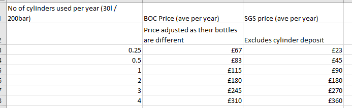

So these are the prices I was given by phone:
--- SGS Gas ---
£75+vat 30 l
£120+vat cylinder deposit
Free delivery
--- BOC ---
Rental £45+vat per year
Argonshield MIG gas 30l £35+vat
Collection only
@pdg the BOC phone rep said the price is for a 30l equivalent bottle but appreciate that sales reps arent exactly trustworthy.
