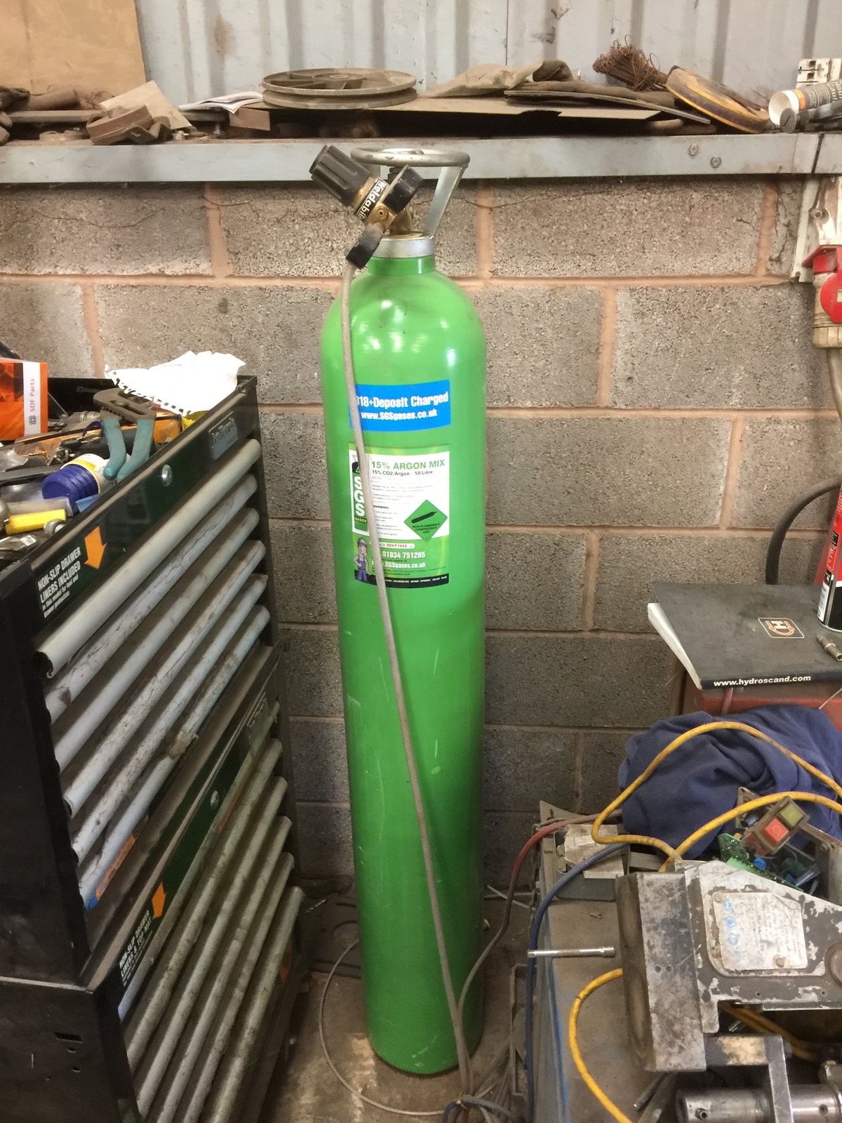

I’d describe myself as a part time heavy user, i can go for months useing hardly any gas, then like.weekend just gone empty a 50 ltr and. 30 ltr o2. And polish off most of a 50 ltr argon 15
