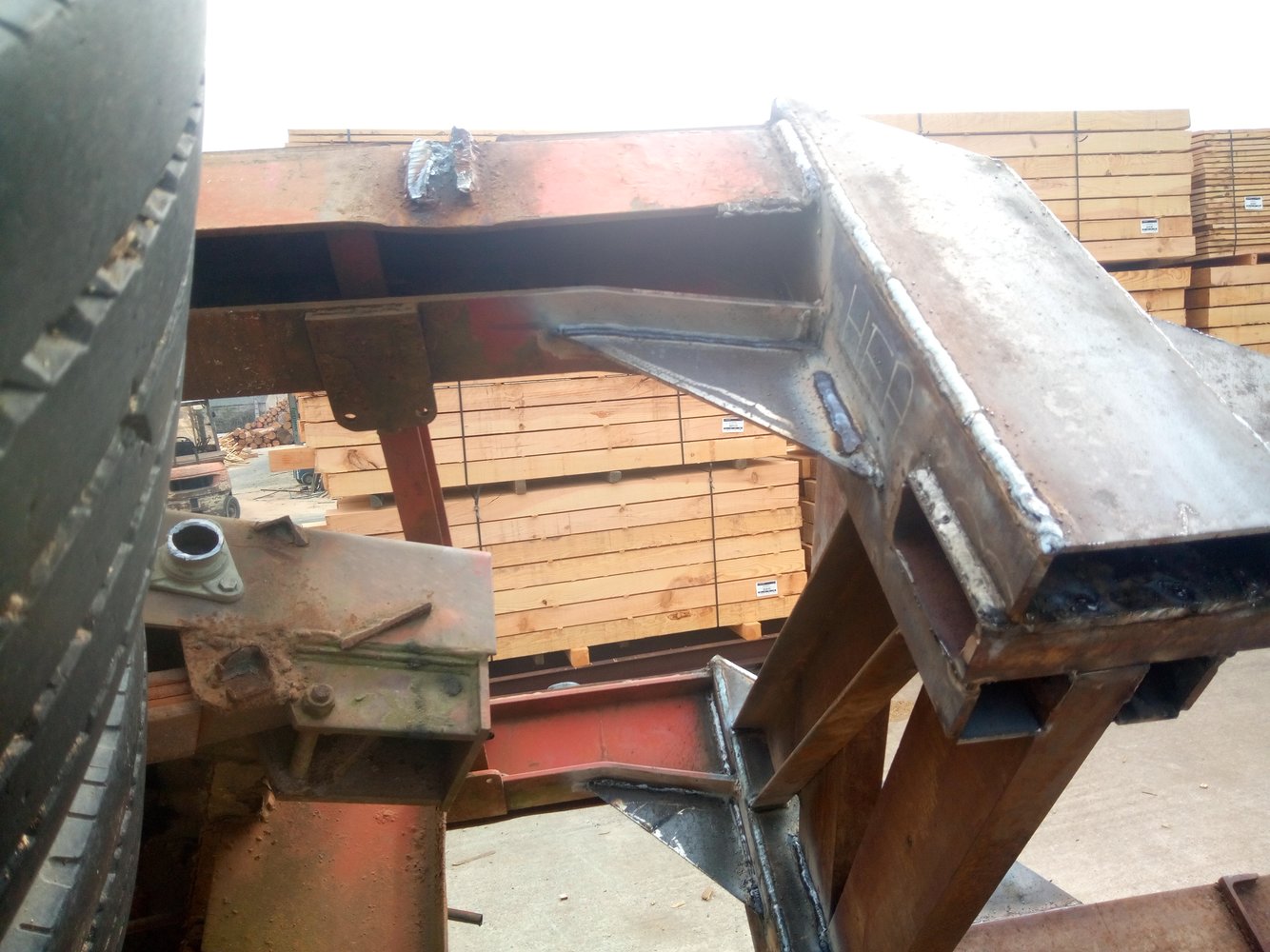

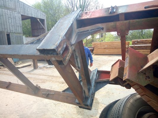

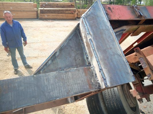

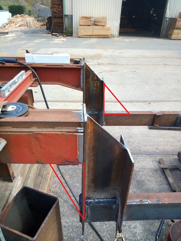

I know nothing about this sort of thing, but I would have done exactly the sameWell done it looks good, the only thing I would have added cause im an over builder
is added a couple of bits of angle pieces here, on both sides
probably not needed but that's just me, I will now keep my head down and wait for any flack.![]()
Yep, it's foressen. But I managed to kill the air supply to my plasma cutter, with my plasma cutter, d¿'kWell done it looks good, the only thing I would have added cause im an over builder
One can but try, and do ones best, God knows my welding improved, but I can still see where I've fluffed up. Honestly never done that much electrode sinking into metal before. Interesting, another couple of weeks and I might have nailed arc welding, but I've only ever used 6013's so should probably exp element with other flavours, and some issues with undercut when filleting? Position ? Too many amps?

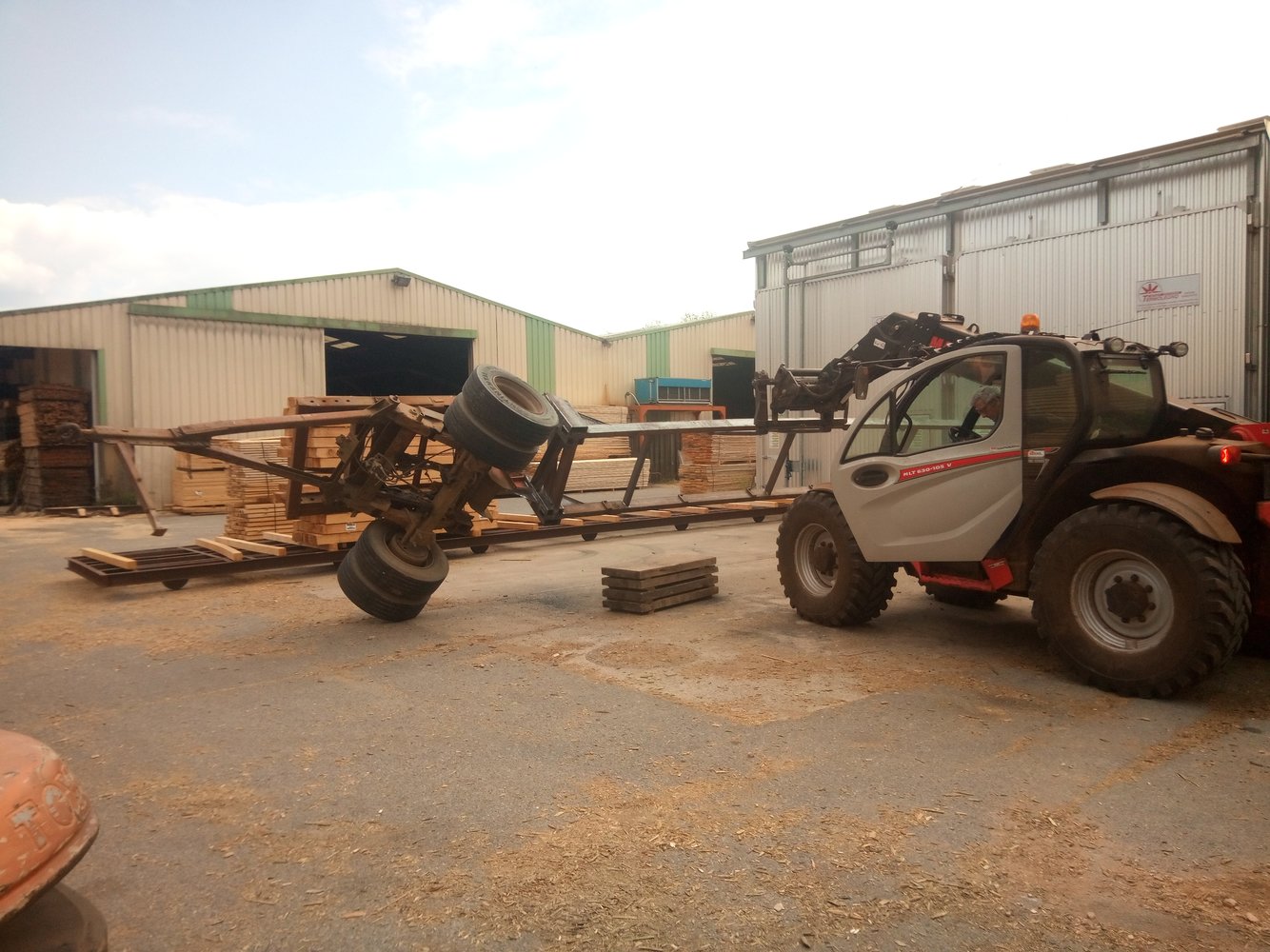

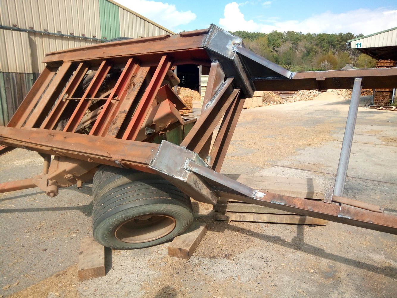

Can’t beat a morning gusset.Gussets galore this morning.
Day seven and I'll be glad to see this finished.
Shame. I love stuff like that.Glad that's over frankly.
Yes, but, four days solid melting rods, wasn't too bad, but I had a bit of slag explode this morning, a small blob went straight through the leather glove, burning my finger and melted part of my finger nail.Shame. I love stuff like that.
Wouldn't want to be burning rods all day every day but a good project like that is nice
Thanks, appreciated.That looks a spot on trailer now well done![]()
