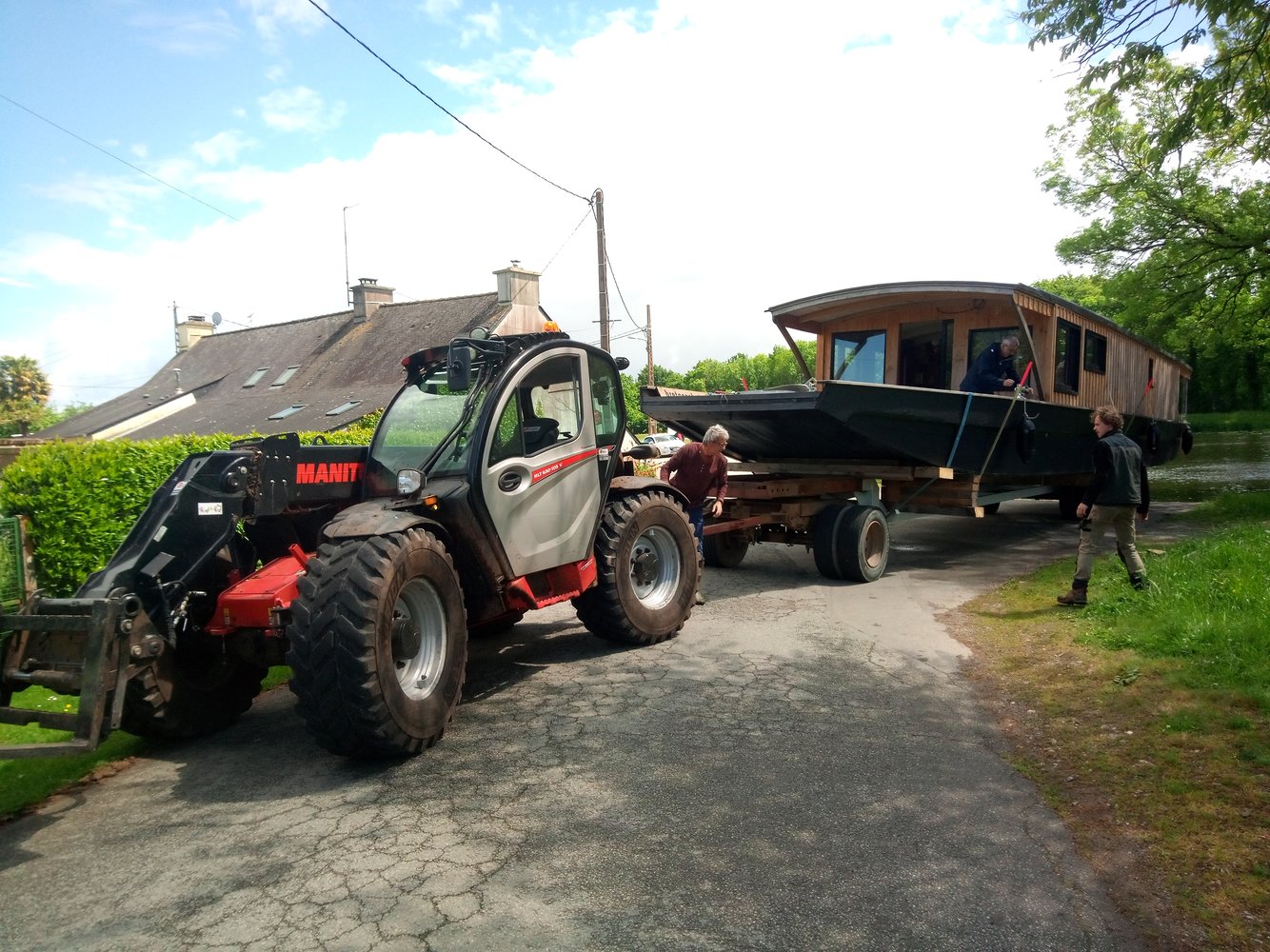

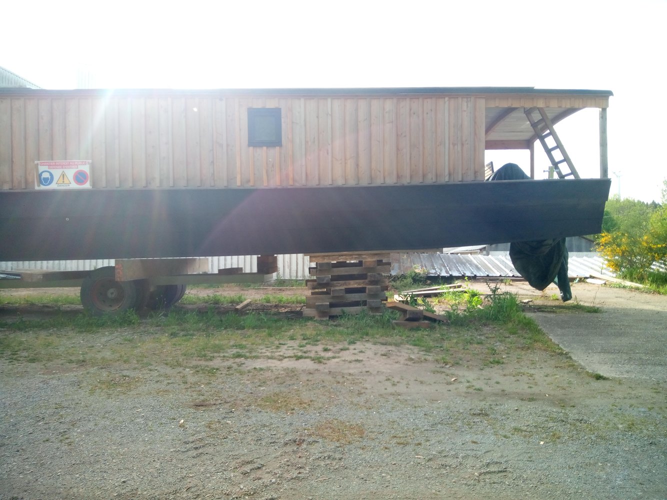

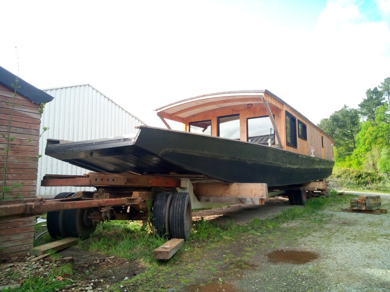

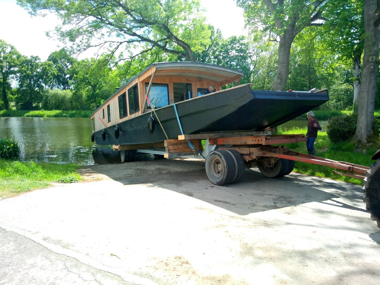

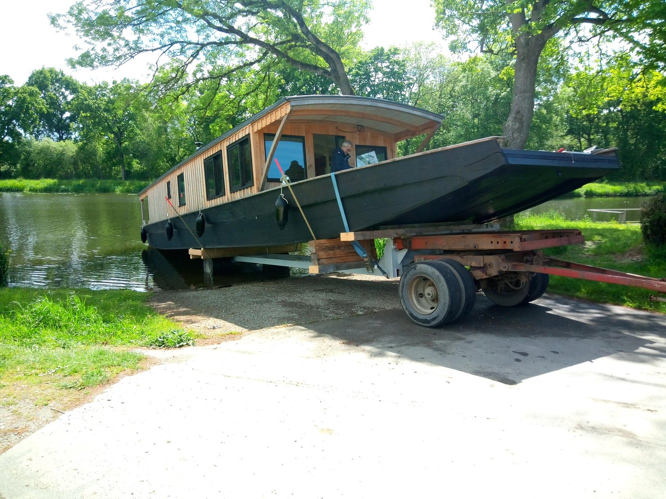

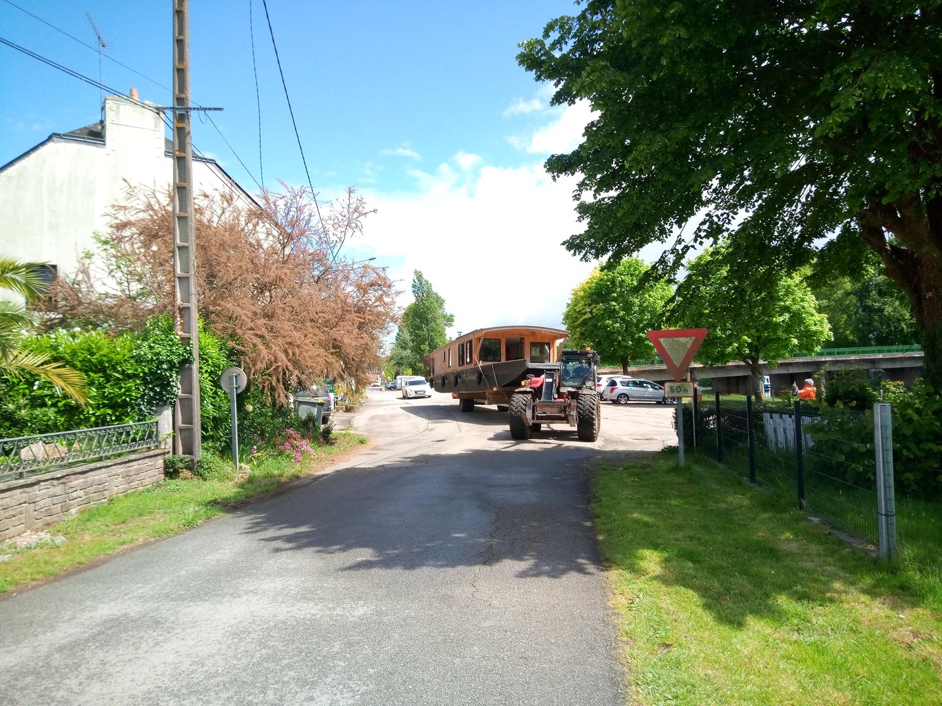

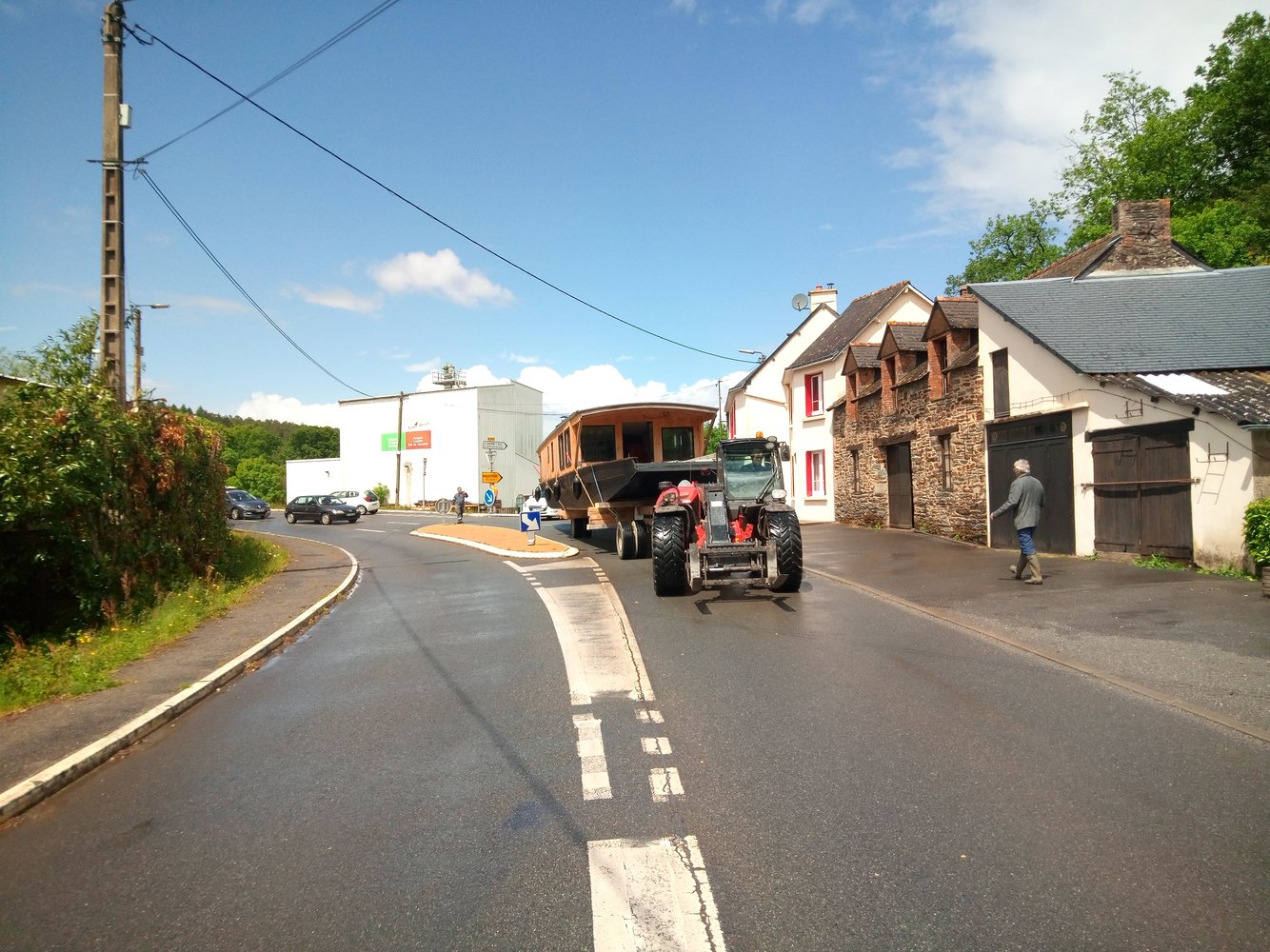

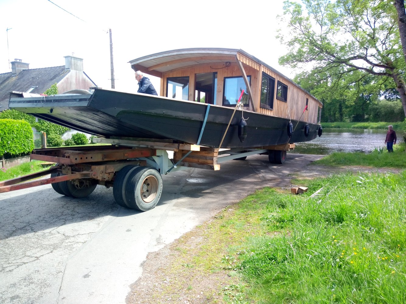

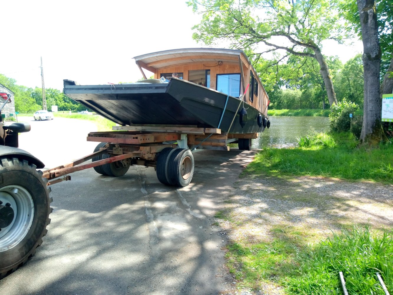

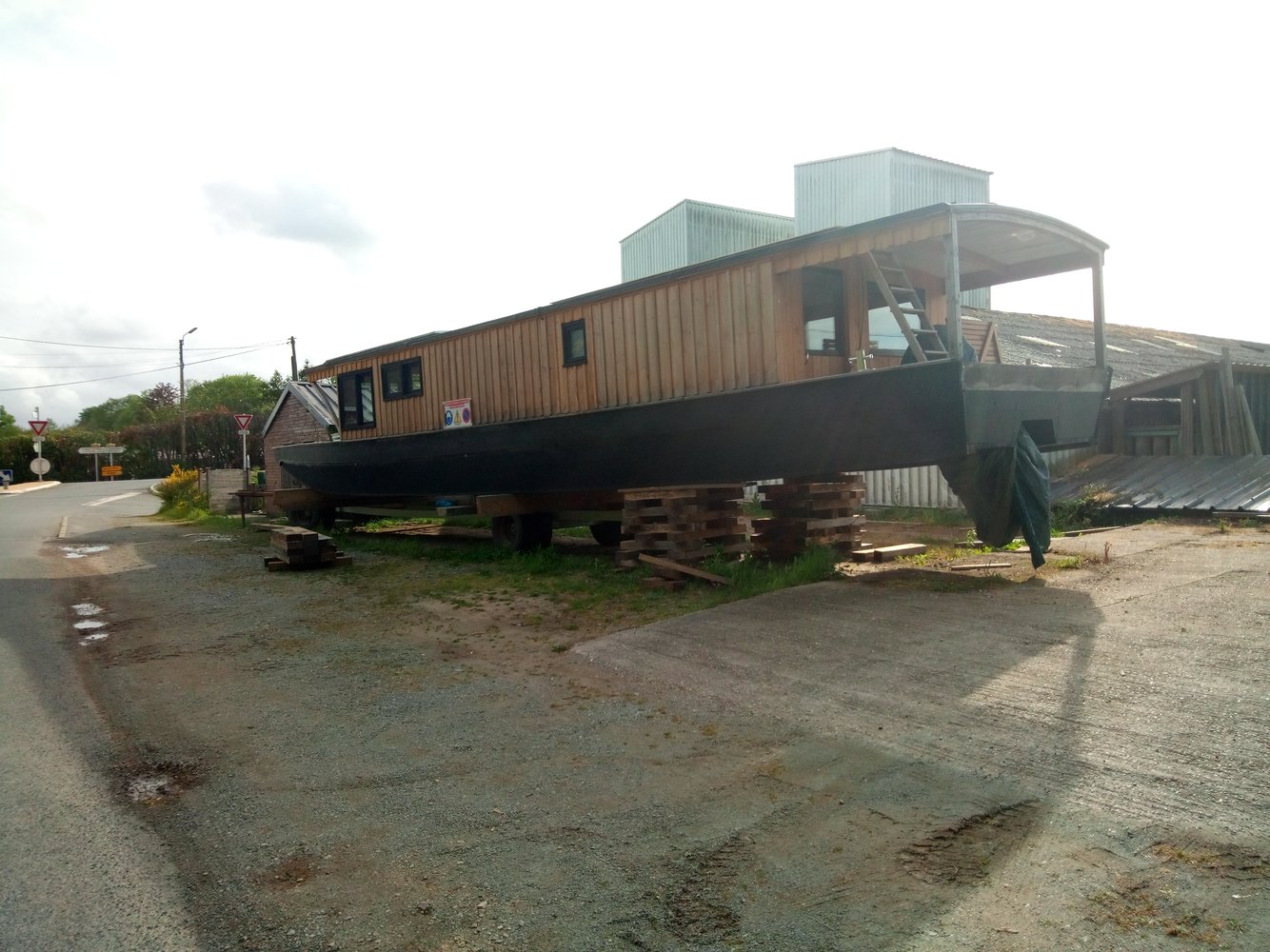

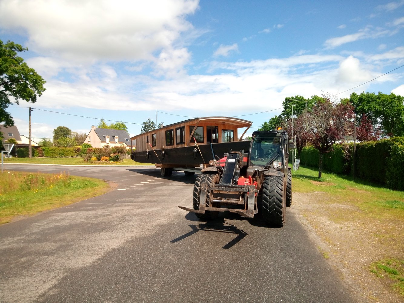

I am, thanks, and glad it's over.You need a certain amount of flex in these things otherwise you get stress which causes problems.
if you ever follow an hgv flatbed they’ve a hell of a twist. The unimog has a three point mount to allow for even more twist. It’s quite impressive.
I skinned out the back doors in our van to make it a camper. Before I did so I made up a rough thing with a sharpie on an arm fixed to one door. Took it for a spin and when I got back there was quite an arc. +_ 15mm ish if I recall. Had a bit of work to allow the body to move and not be affected by my blocking the back end up.
nice job there mat. You should be happy with that.

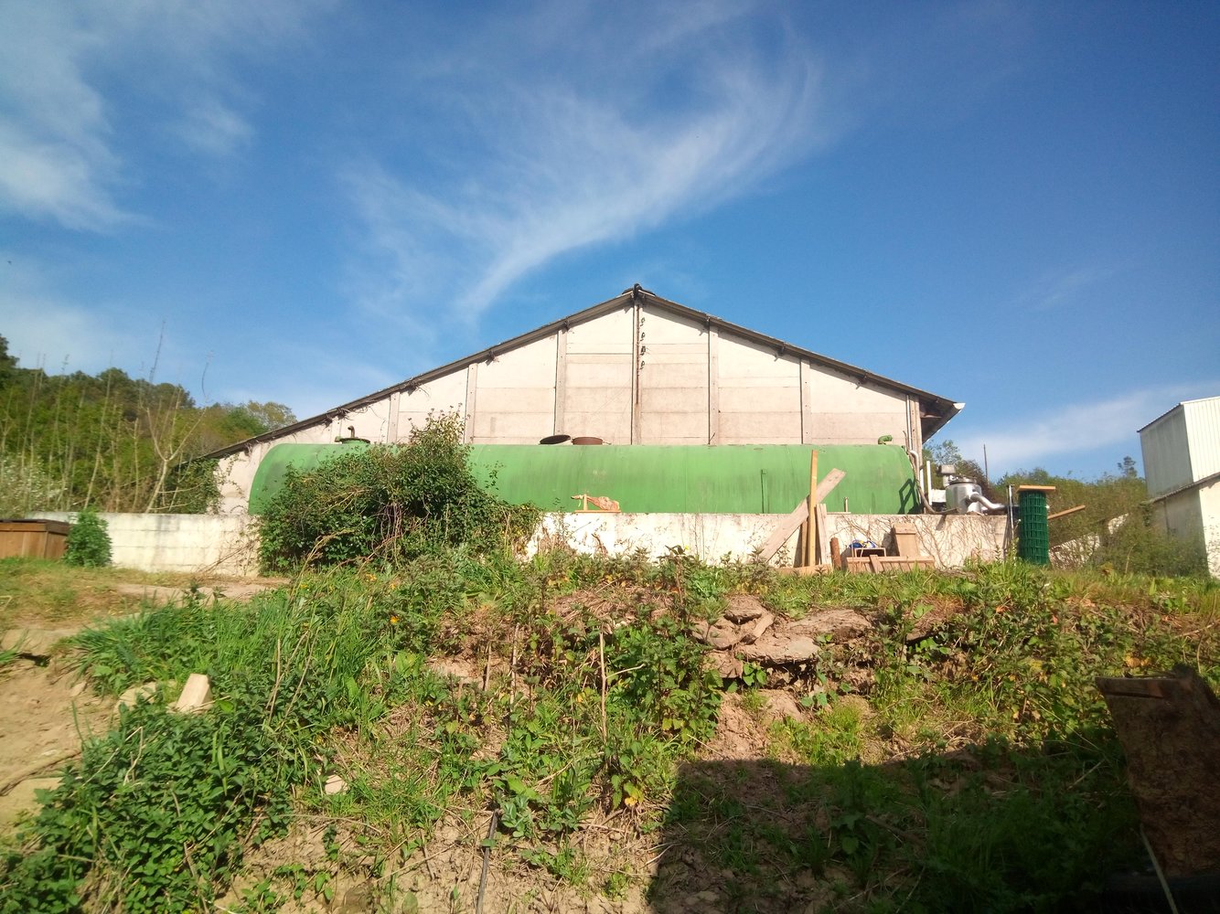

This is the next project scheduled for Septemberish, cut this up and remove to make a hobbit house in the garden. Internally stainless steel, expanded foam, mild steel outer.
Approximately 2.5 m internal diameter, no, I don't know how long it is 20 meters?
Cut it up and remove, is the job title.
