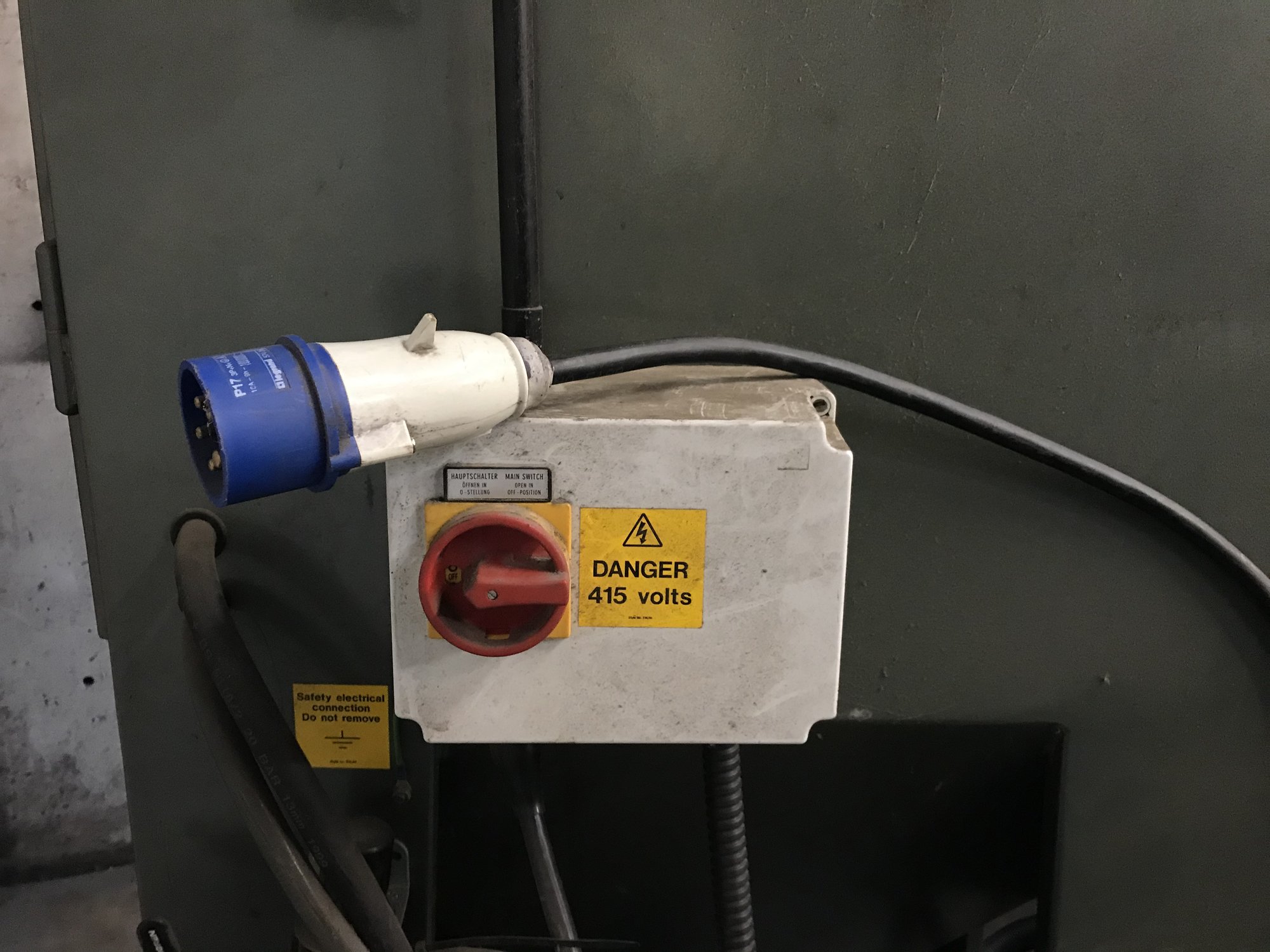

VFD is a possible applicationLots of obscurer but standard plugs around got a big bag full I have acquired over the years green, 110v 3 phase, some high-frequency aircraft-related, purple 24v, all sorts.
Theoretically, it would be the correct plug to use between a motor and VFD on a single phase to 3 phase VFD set up in the UK.
about colours
24V green (nope) corrige PURPLE
48-72V white
110-120V yellow
220-250V blue
380-440V red
600V black
High frequency purple (nope) corrige GREEN
Purple (nope)
Edit corrige GREEN
indicate high frequency and is used with other colours which indicate the voltage
Clock designation is a safety detent which has 2 functions avoid to use a plug in a different socket and lock the plug in place
