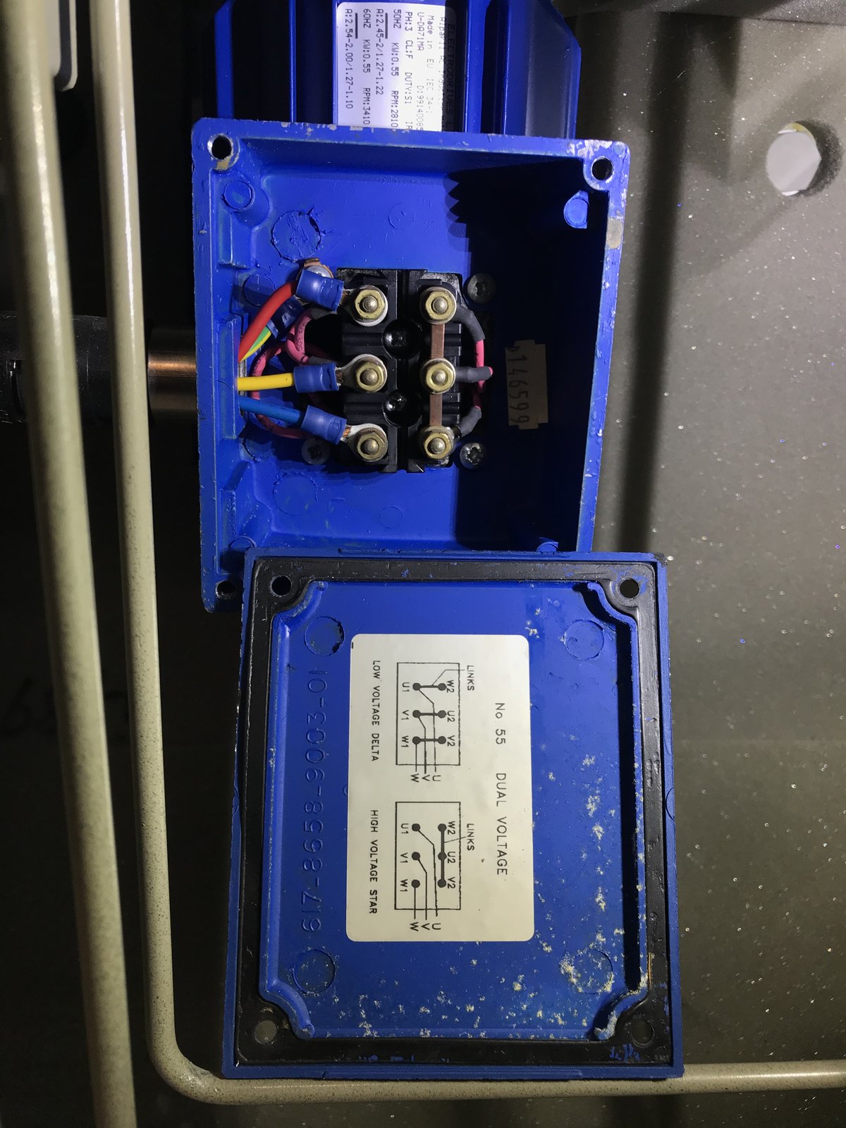

Looks like it’s 415v but someone’s put the wrong plug on it?

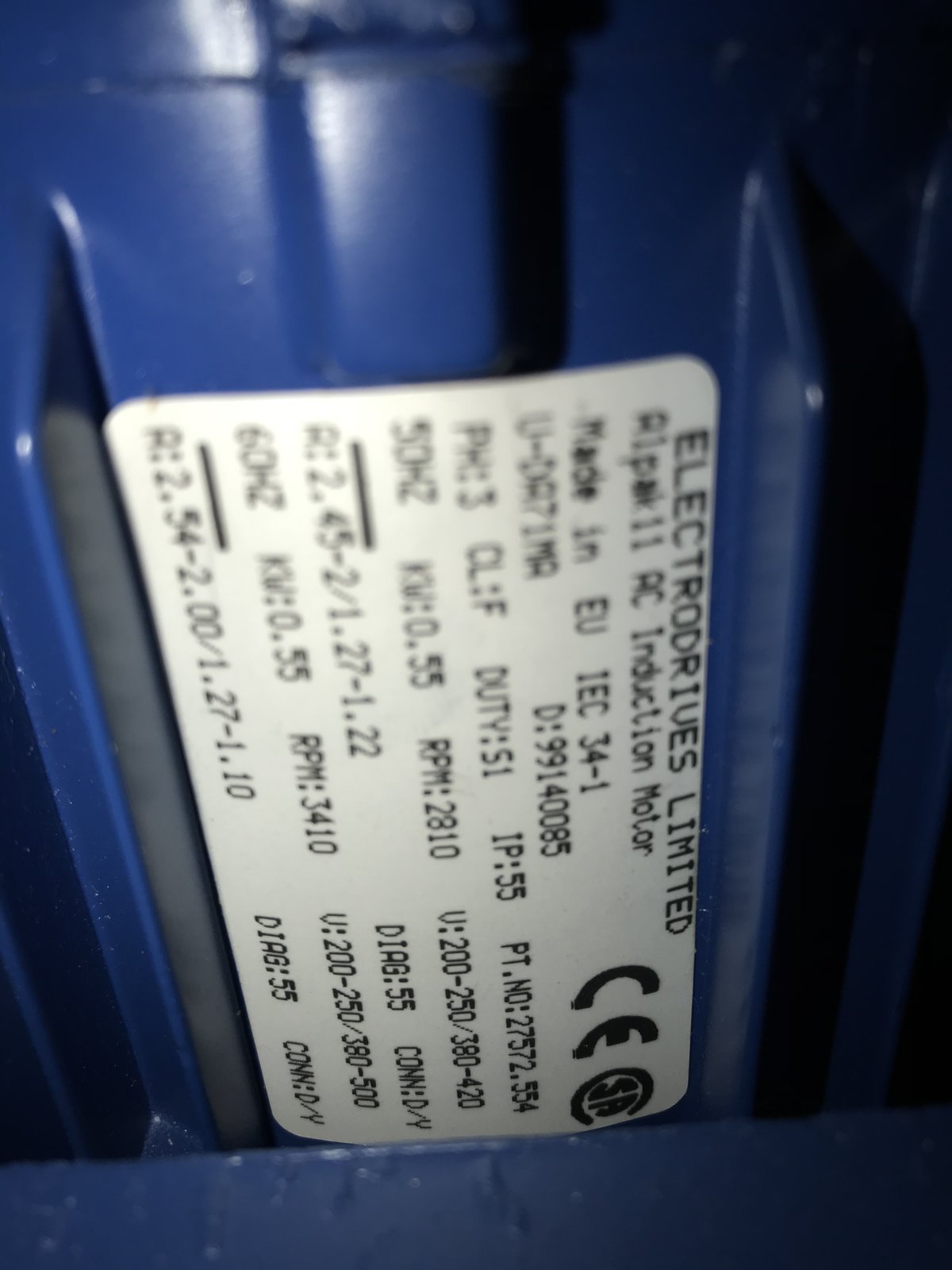

That motor can be wired both ways, for 220 or 415, but I don’t know anything about wiring Three phase electric motors so can’t tell you what it’s wired for.
it does appear to be wired star for 415v
I agree with Brad , seems like someone put the wrong plugChop the blue plug off and put a proper red plug on there
The motor says 380-415V Y and it appears to be connected in star configuration.
Prior to connect the unit to the mains power
I'd like to check if all the components are connected for 400V three phase
