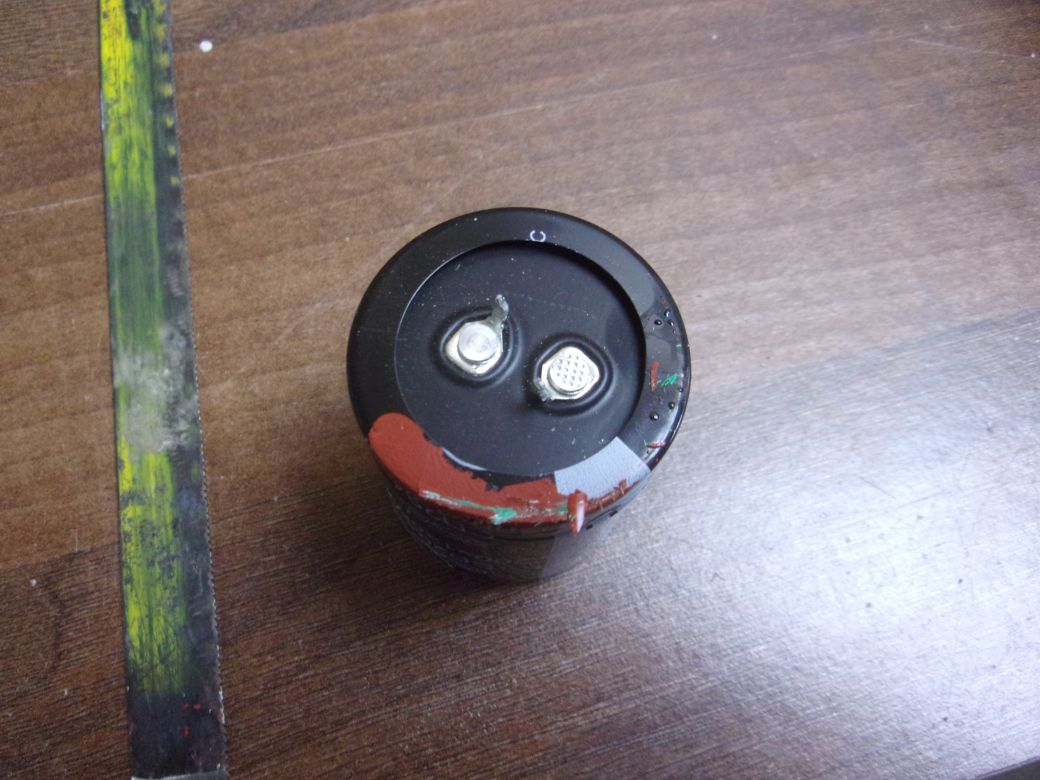

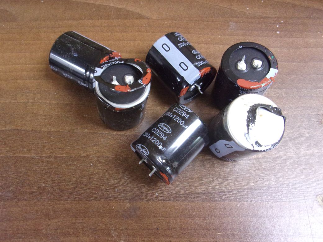

One thought has occurred to me whilst buying these new caps; how do I know if they aren't as old as the caps in the welder; how long will they have been in stock?
Any advice or suggestions regarding the difference between welders such as my Parweld or an industrial like a Murex that can be run from 240V? Are industrial on transformers rather than solid state hence the extra weight; please bear in mind I've been arc welding for 55 years but this more modern solid state MIG/TIG is new to me and I've not tried either previously. I don't quit easily but I don't want to end up changing caps each time I want to use a welder? I find it hard enough to get workshop time without losing a full week at a time like I've just lost; I can't settle with the thing in bits on my bench.

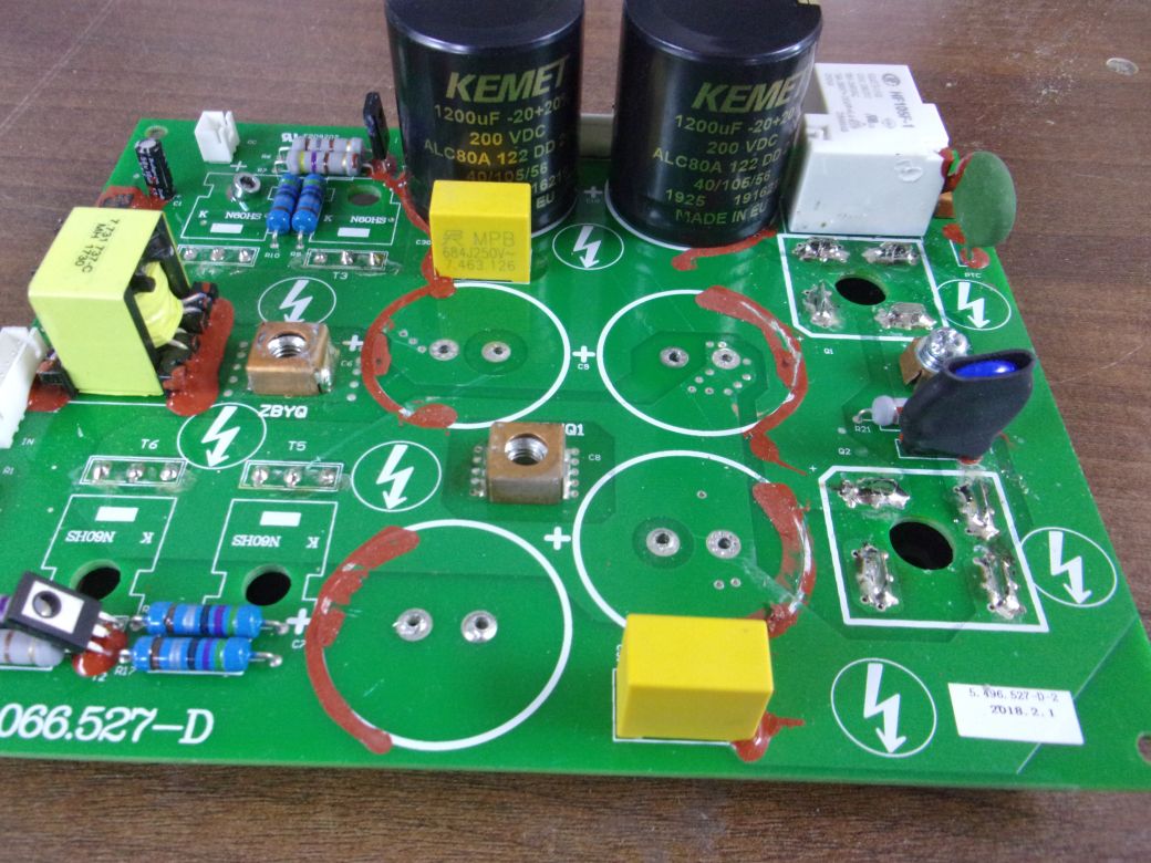

The Kemet caps are expensive to me but I wonder how much difference the cost would be to a manufacturer who uses these in bulk? We used to get massive discounts at work from suppliers for bulk orders?

WOW; I've already received notification the caps I ordered just a short while ago have now left Farnell warehouse and I've got a tracking number. Smile on my face at last.

initially I drilled the board at the solder points 1.7mm but the cap refused to go home flush so I then ran through with a 2mm drill bit.
Some kind of adhesive paint?
