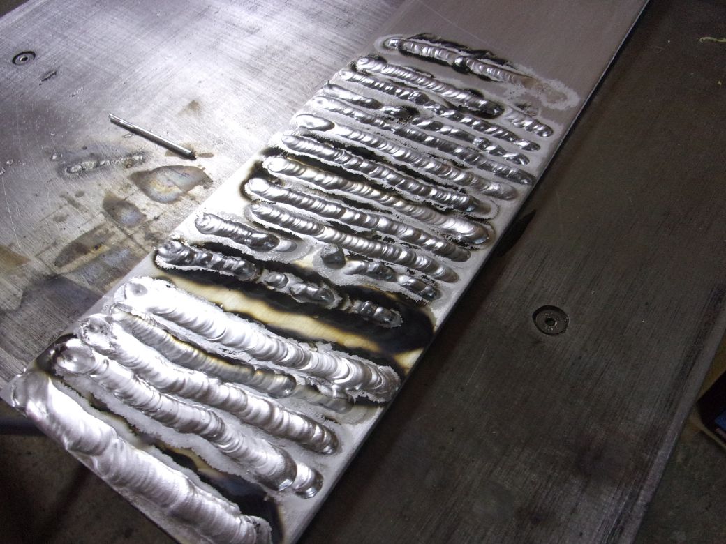

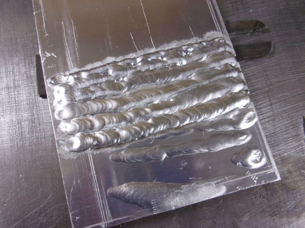

Hi,
I've just come out of the workshop after an hours practice running beads on 4mm thick aluminium using 2.5mm 4043 filler rod at assorted welder settings. I spent a while using my Makita palm sander with a new clean abrasive sheet then went over with s scotch brite pad before dusting off with a lean towel; I didn't wipe with meths. I ran the Scotch brite pad along the filler rods.

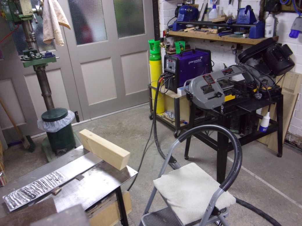

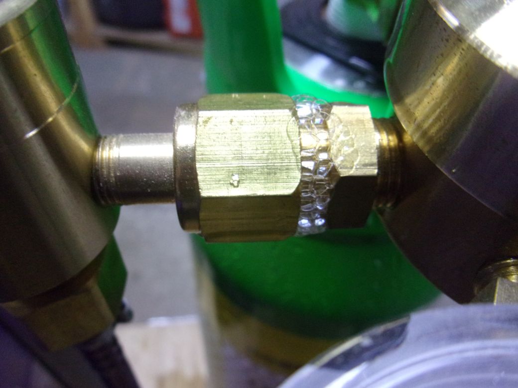

Below are the results so far; the black sooty run was first; the tungsten was ground sharp but a bit messed up so I removed about an inch from the tungsten end giving a clean pointed tungsten. Next beads were towards me from the black to the left; 130A to start then as it warmed up dropped to 100A both at 60hz; this produced very wide beads but mostly under control. I then experimented with hz running the beads to the right; at last I'm getting to grips with hz; low hz wide bead high hz narrow bead; not dull but not highly polished beads and I was puzzled by the black deposits; these seemed to appear with wrong filler feeding possibly touching the tungsten or dipping the puddle. As welding progressed the piece started to really heat up and as I was now having to stretch over hot beads I called it a day. I switched the welder off and the gas but just before turning out the lights I double checked the gas was turned off to find the high pressure had dropped to zero psi within only a few minutes so there's a gas leak to sort out next session. I'll run some water with washing up liquid added shaking the mixture over all the joints/couplings to locate the leak; the cylinder is definitely turned off so just another problem to sort out. It's very gloomy so the pictures aren't brilliant but I'm now fully behaving myself in only running beads and will continue to run beads until I get them right. I ran these freehand; I'm sitting on steps with a thick towel as cushion and using my arc welder trolley as a welding table this being a bit too high; I'm very short of space otherwise I'd make a dedicated welding table but I do need an adjustable stool for height control. One thing I'm doing is enjoying myself. Today's lesson learned was in using the hz adjustment; the narrow beads were run at 130A 140hz with 15 ac balance. I tried 25 ac balance but this seemed to mess up the tungsten?
Kind regards, Colin.
From the bottom 60hz towards the top at 140hz. various amps. 2M of 2.4mm filler rod used.
