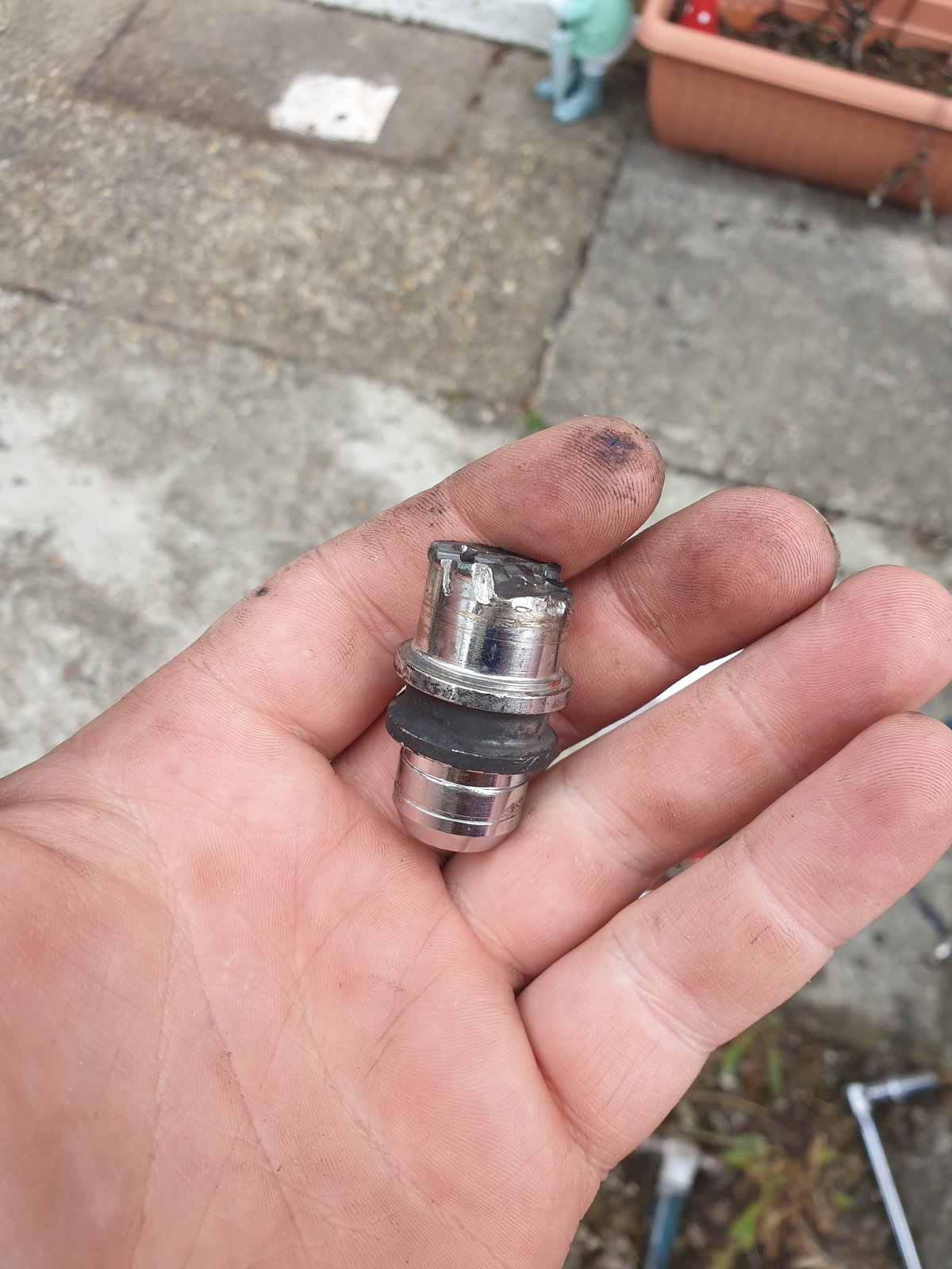

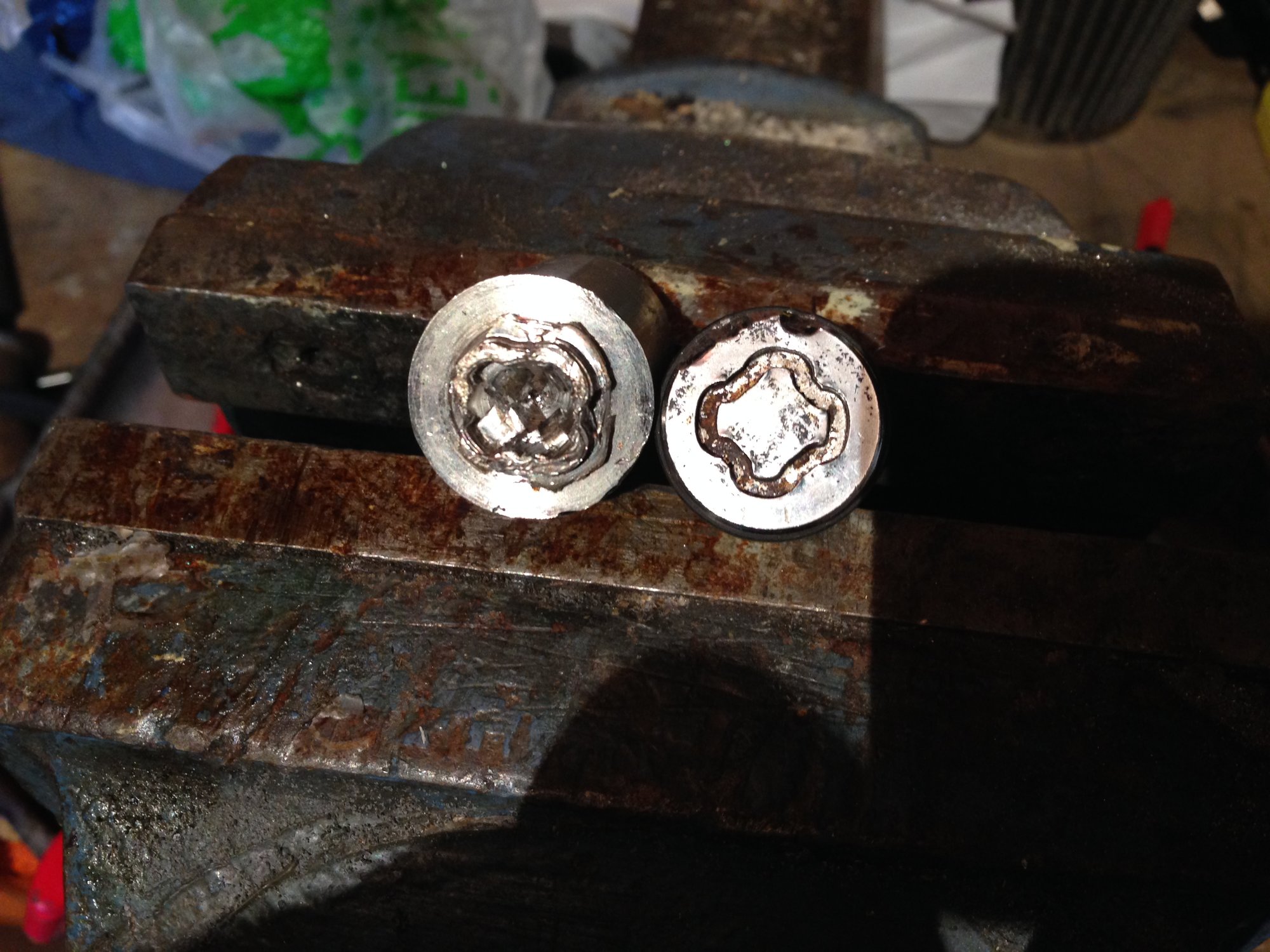

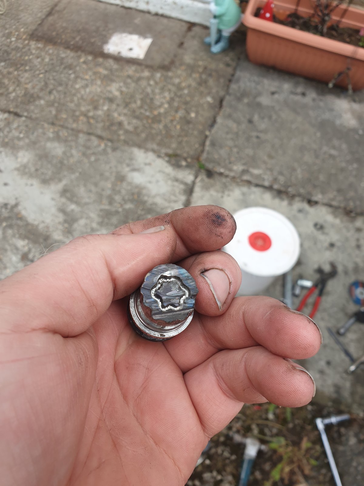

I’ve had some success in the past making a key when it didn’t come with the car.
managed to rough the shape out and hammer the new key into the bolt. Worked a treat with a pair of stilsons
