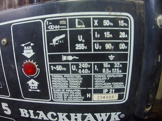

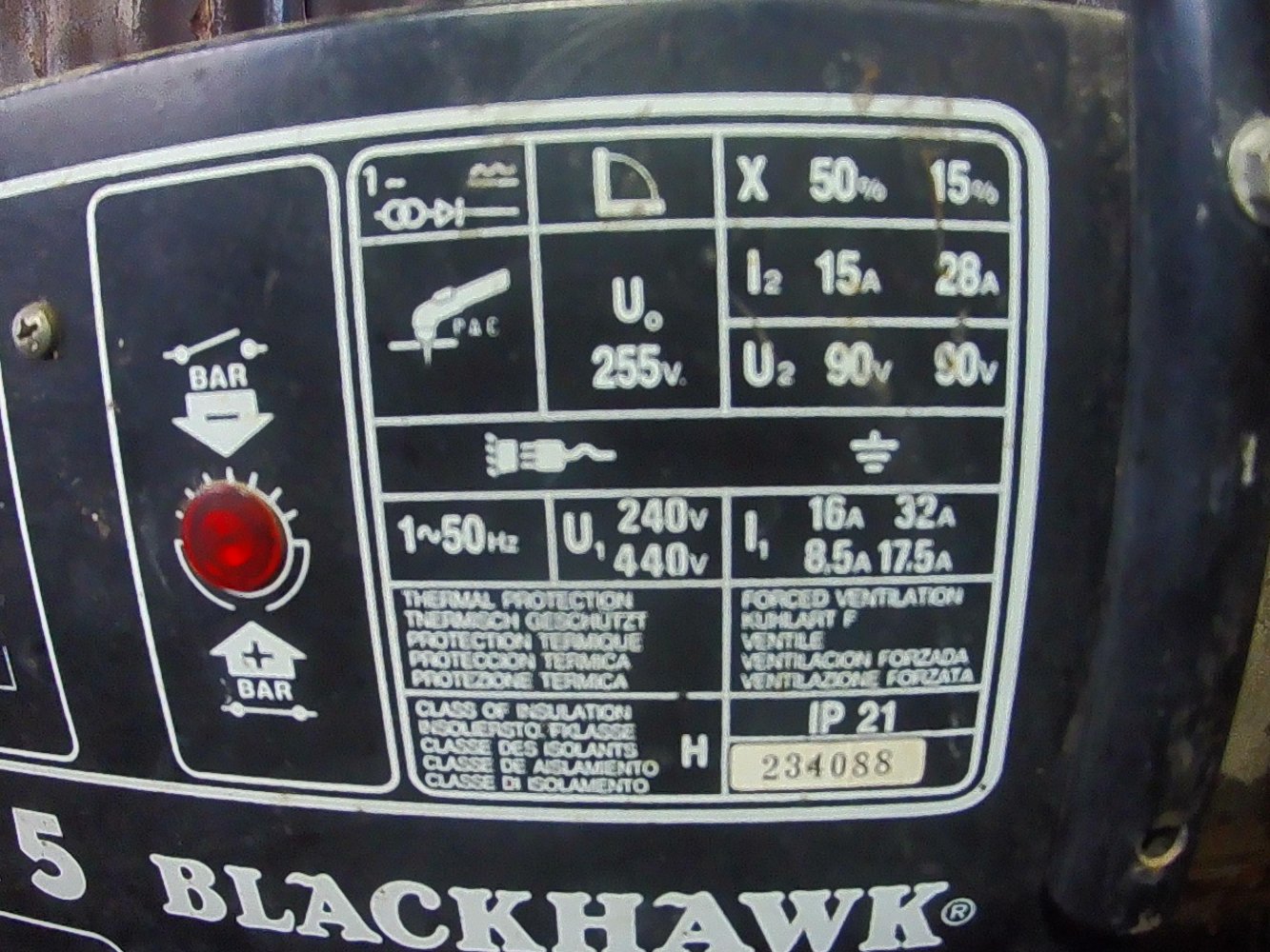

So which model Cebora should i look for consumables for? Don't want to buy parts that end up not fitting.As said, that looks exactly like a Cebora machine.

Can you post a clear picture of the part which lists the input voltages.
