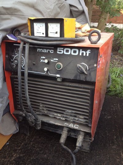

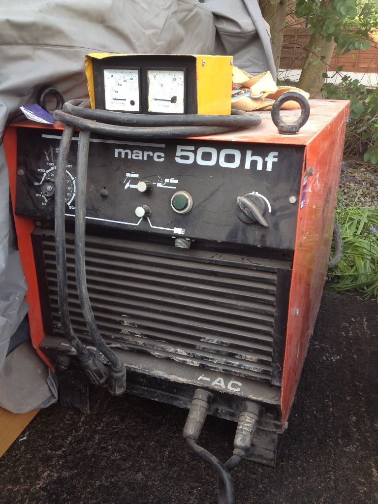

As hood said probably around 180/200 amp secondhand not many 400 amp machines around used as normally built to order.Just looking into it ,a guy i know gets hold of lots of 2nd hand machines in good nick but i dont know what size i can run

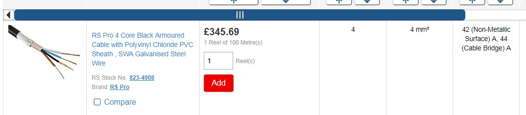

) the higher rating may of course be because it is SWA?
