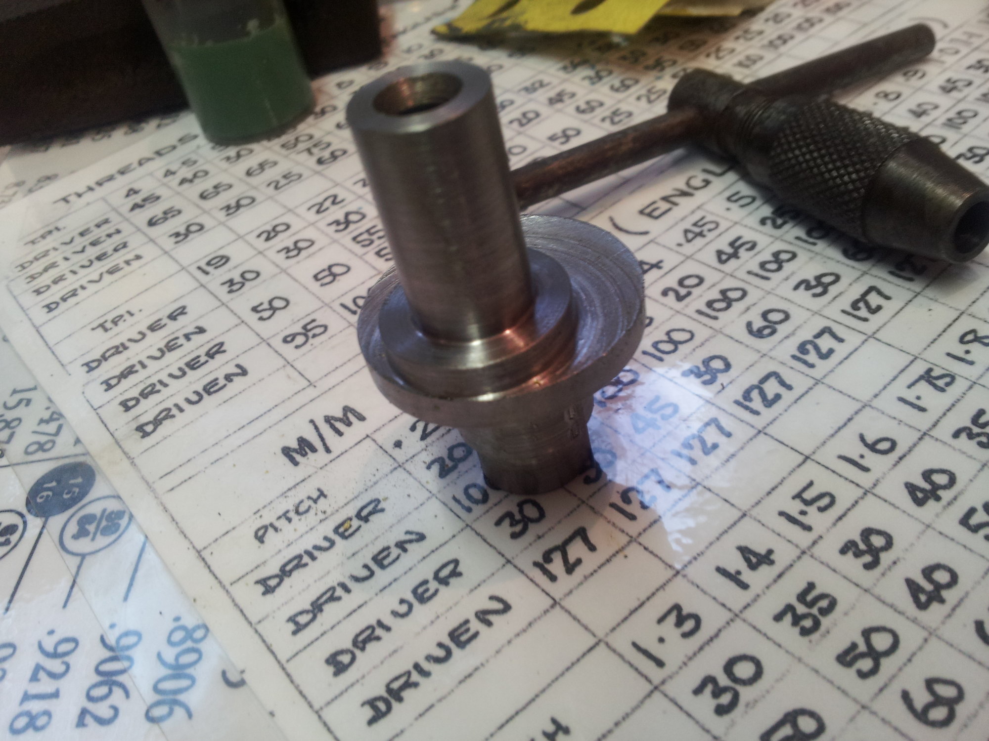

Haha. Im not much better. Learning everytime I use it. Thats the reason I bought it though.Would probably be easier for me to give you some drawings, As I wouldn't know where to start!![]()
