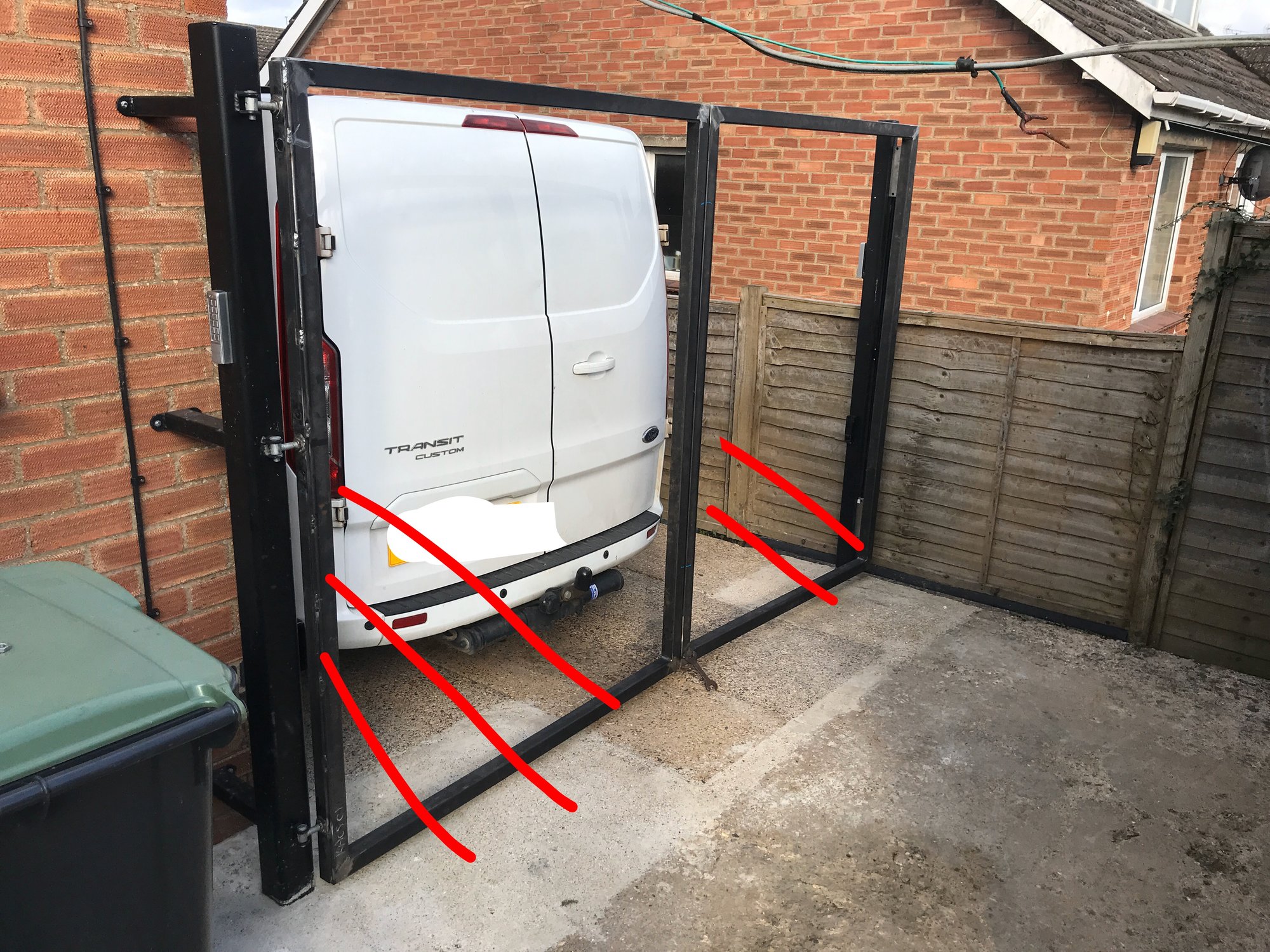

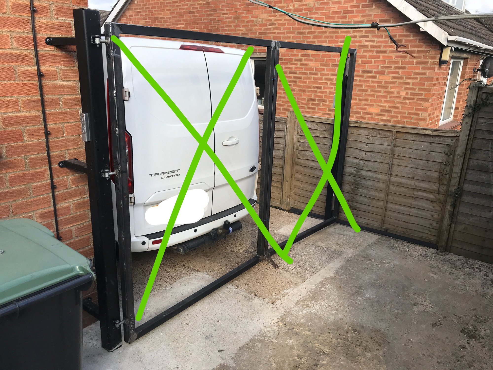

Right, opinions on bracing this gate. Currently with no supports it’s a bit flexible. Any ideas which would be best. Some 45 angle pieces in the left hand corners like the first pick? That would stop it bending down I guess. Or diagonal cross bits like the second pic
View attachment 220644 View attachment 220645
Just my luck. Don’t have enough material to make themfull diagonals as per second green pic, best .
Going to see if there’s annoying local I can buy some from. I have enough to do one cross.

I was thinking that. I have 6m of 25mm x 8mm flat bar and I have some 25 x 6 as well but not enough of either to span the length. I have a lot of other bar as well but all too wide. I called a place near ish me and they want (make sure you’re seated) £26 +vat for one length of 25x6mm barfred king typicay eh , got anything you can sacrafice and replace later to get the steel from? , your doing a damn fine job so dont skimp on it now. I like your attention to detail ,belter.

One cross member across each would be the traditional approach. Top left to bottom right.I have enough to do one cross.![]()
I just offered it all up, I’m going to do that it looks nice still.One cross member across each would be the traditional approach. Top left to bottom right.
