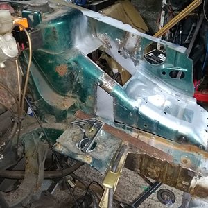

I decided to remove to remove the gearbox mount support bracket to aid alignment of the chassis leg, i used one of the core hole style spot weld drill bits.
If you have never used one before they only need light pressure i initially tried to use it like the other flat ended style spot weld drills with a lot of pressure it just causes them to wander badly.
The support bracket seriously did it need so many spot welds
Soon had it off.

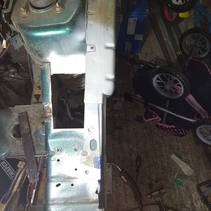

Cleaned it up and got a straight edge on it, it ain't flat.

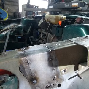

It has a bend in front of the mount but seems like the engine mount stopped the leg bending so i am going to cut out a strip just enough till it is flatthen weld a new strip in across both pieces, the inside of the end of the leg is fairly flat as well. The outside of the leg is a touch rippley and is going to need some new metal the outside of the end of the leg is also visibly bent, unsure if its the original piece of if they got another one that was also bent.
