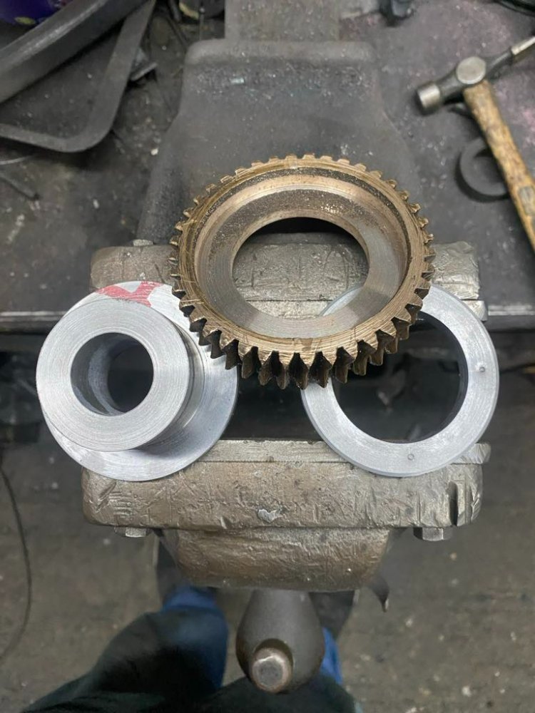

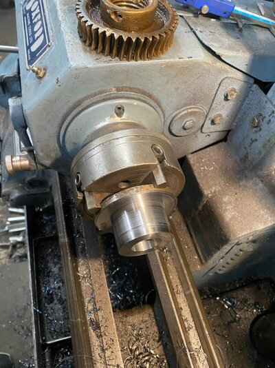

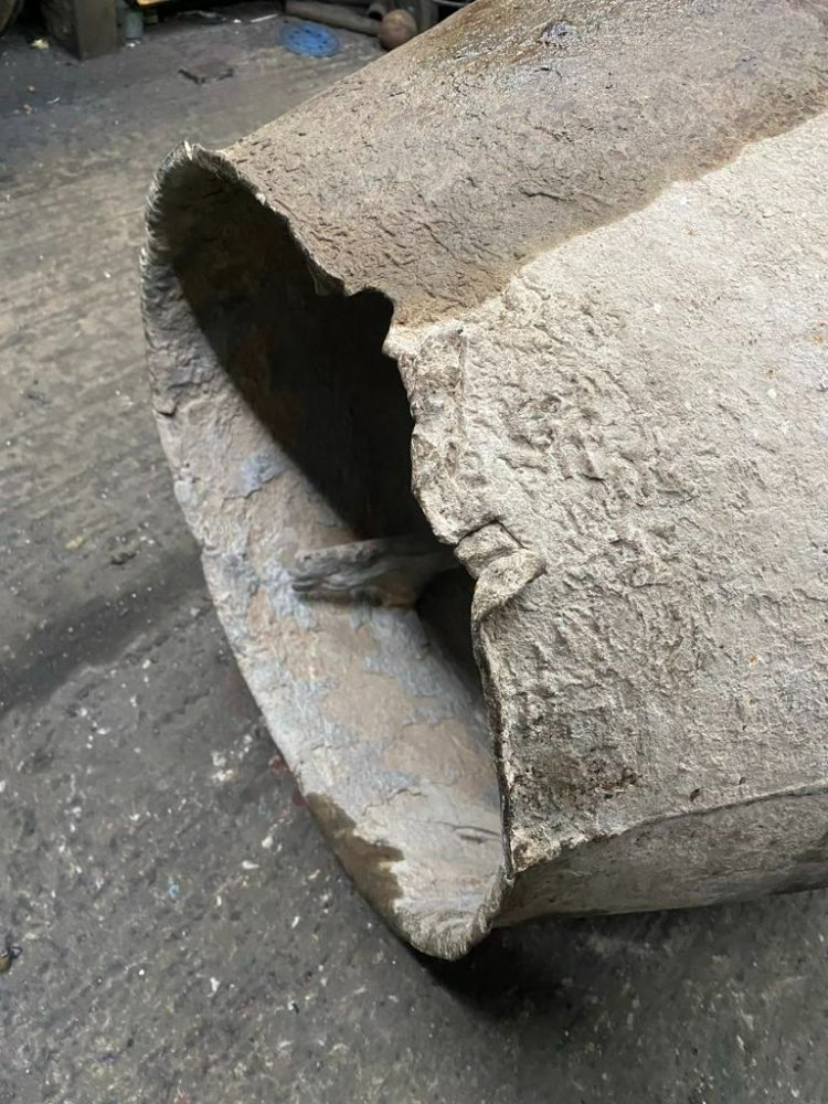

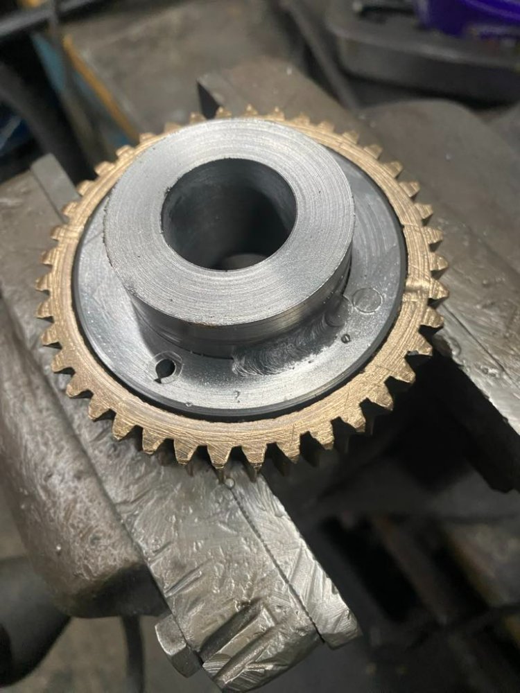

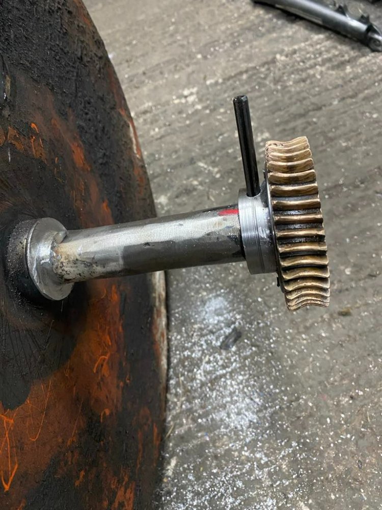

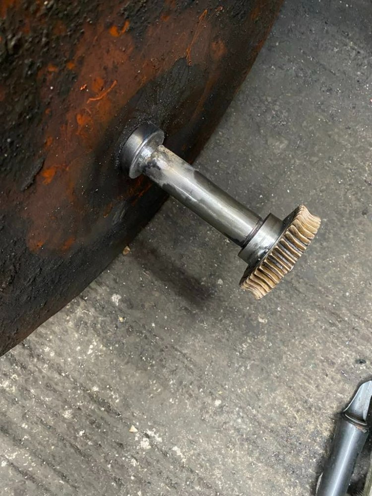

Anyway, change of plan. That shaft is most likely welded in the drum as @Turbo said, so I'm going to leave it there as the thread in the drum was probably well worn before the welding.

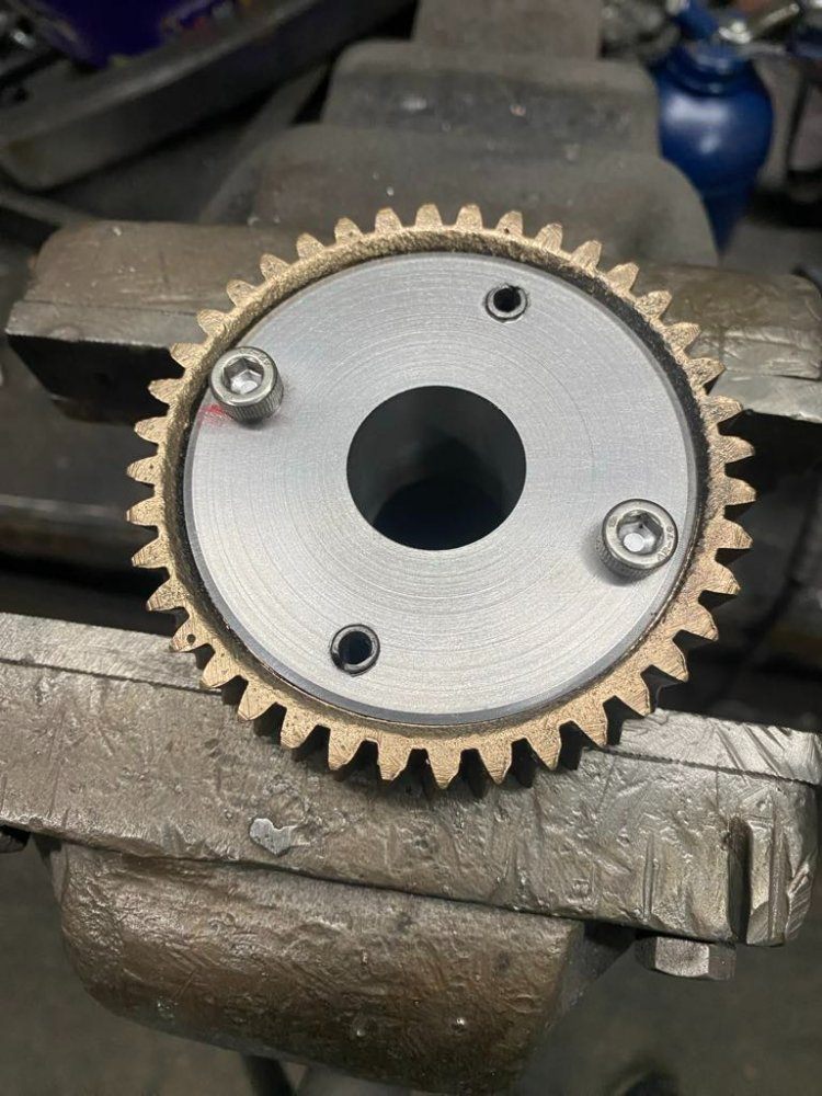

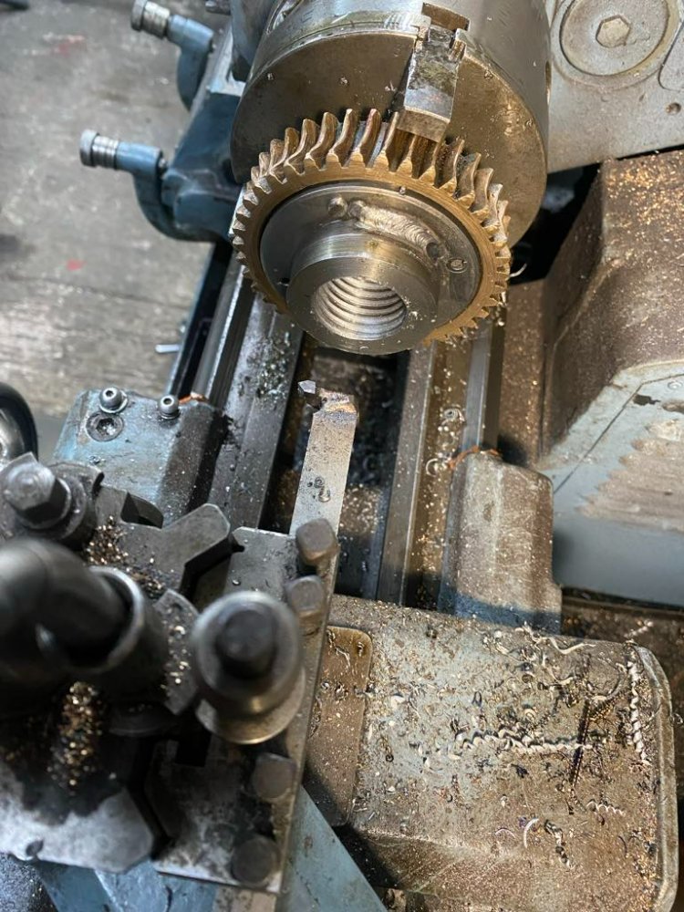

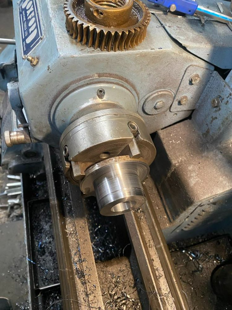

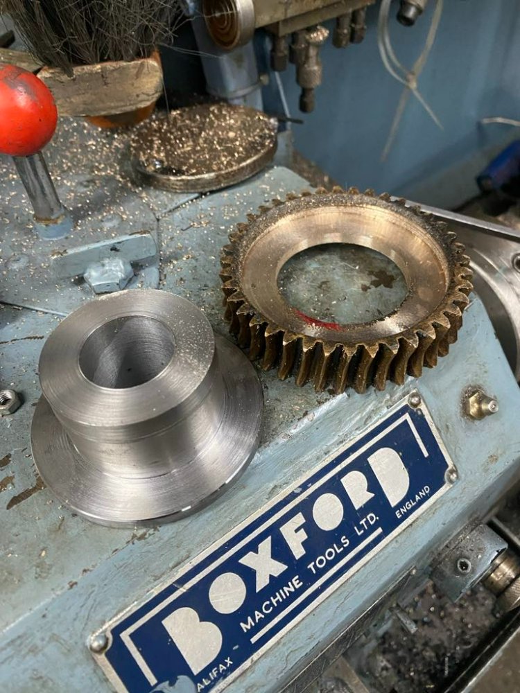

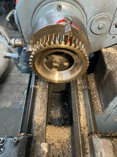

I'll make a new centre for the gear wheel, thread it so it is a tight fit on the shaft thread, locktite it on and maybe put a roll pin through new centre and the hole that someone put through the shaft. I'm sorry now that I welded that plate on but it will come off.
