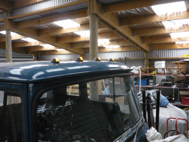

Marker lights look great...workshop looks great too
Marker lights look great...workshop looks great too![]()

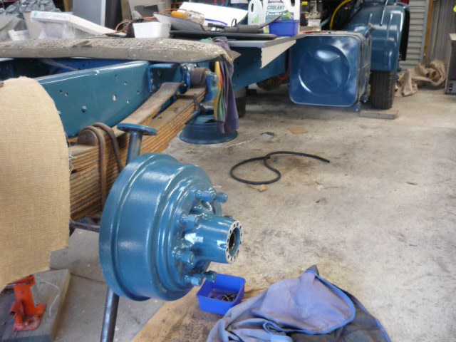

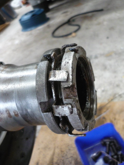

Yes , but sometime you need to pre load the bearing by taking it as tight as you can or to a torque setting whilst ensuring the hub with a brake drum & wheel fitted will still barely rotate , then back it off 60 degrees to give a very light pre load & no end float .
