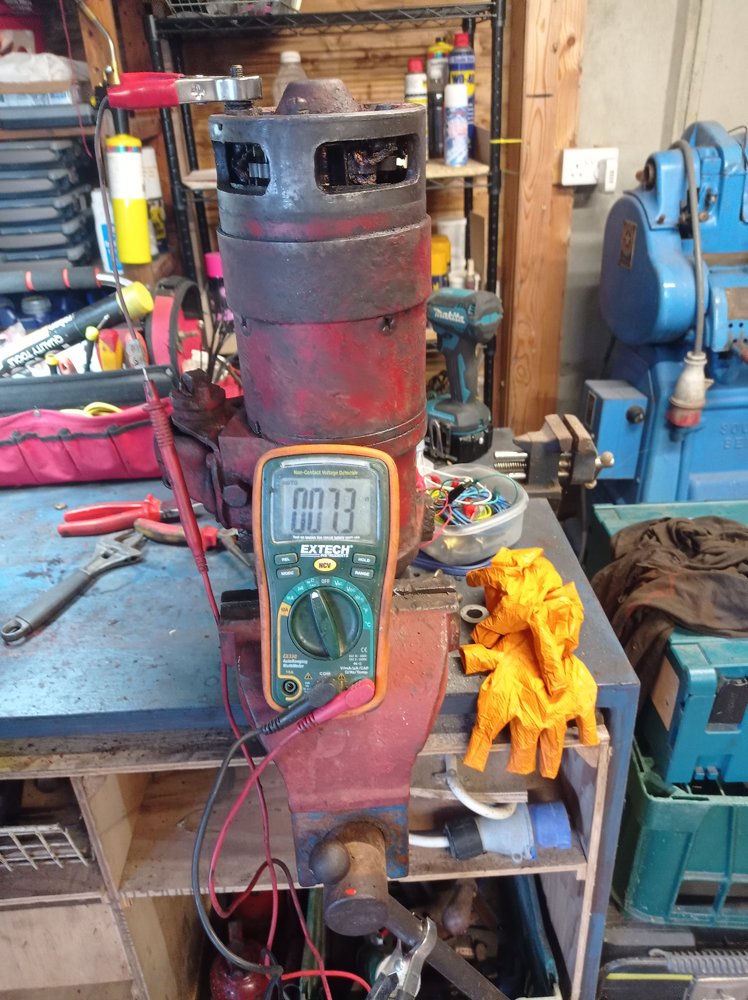

You've probably got 6.5 of your 7.3 ohms resistance due to the black crocodile clip being attached to the vice handle!Me thinks starter is not good.
New battery and same issue.
Took off starter and bench tested. 7.1ohms. seems high to me but I can't find a good number for expected coil resistance. Seems high to me.
12v/7.1ohm ~ 1.6I which seems like a very low start up current for a DC motor.
Make no difference. I always check several places but that was easiest for photo.You've probably got 6.5 of your 7.3 ohms resistance due to the black crocodile clip being attached to the vice handle!
Take it off there and connect it directly to the motor casing.

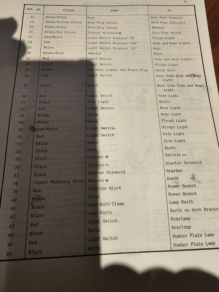

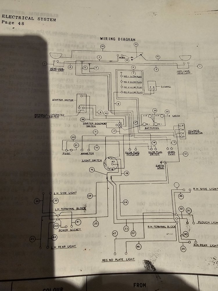

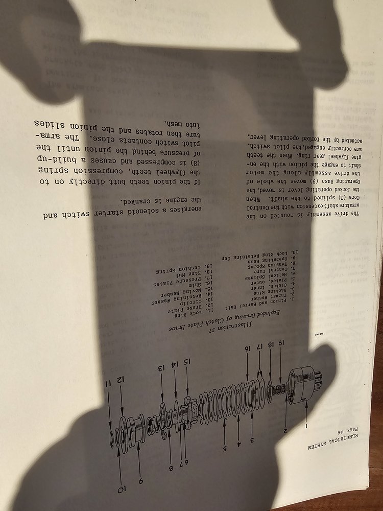

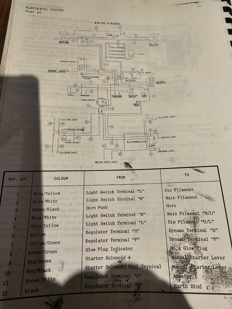

Thanks, I will take a good look though that. Thanks for taking the time to photo all of that.Here is the section on , starter, from the workshop manual. Start on next post, at bottom pic and it should be in order.
