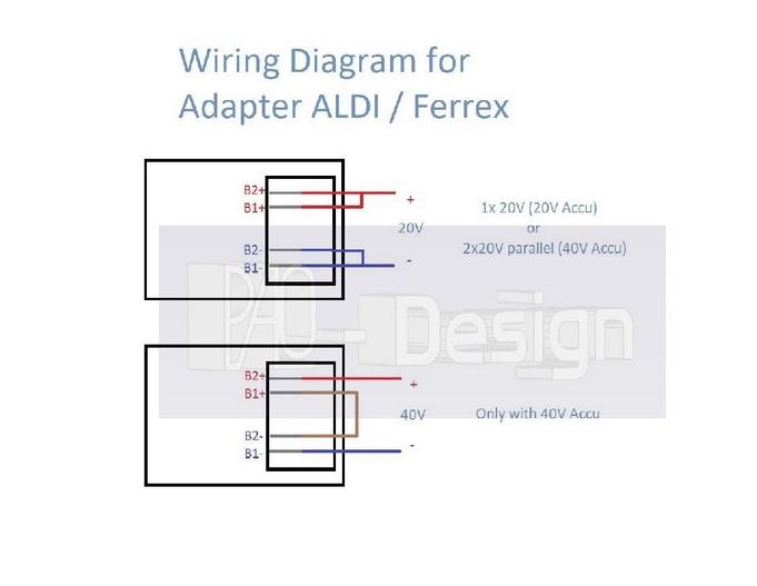

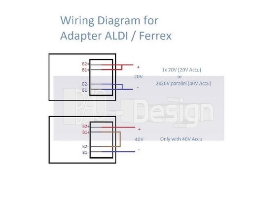

I can take the 20/40 battery pack out of its case and take photos of how it’s wired up if that will be of any help. I’ve no idea how it switches from 20 to 40
I'm pretty sure the 40V tools use B1 & B2 in series. The 20V tools use B1 and B2 in parallel. In effect there's two 20V batteries in the 20/40V ones.
